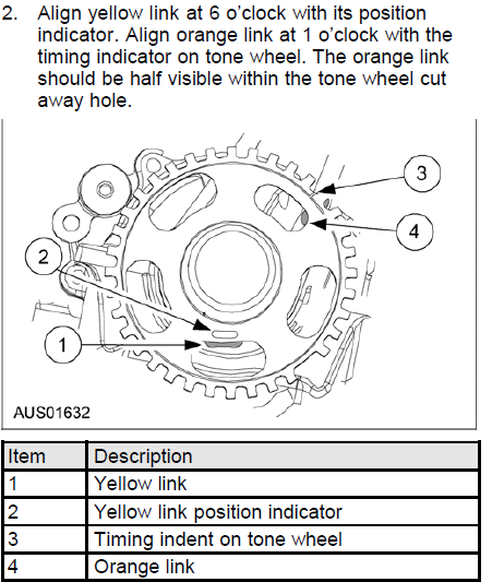

Puffwagon Puff Gold Donating Members 16,320 Member For: 10y 3m 2d Gender: Male Location: South Australia Posted 22/09/21 09:09 AM Share Posted 22/09/21 09:09 AM Haha ok. You don't have to remove the sump. There are 4 little bolts underneath that you undo and if the rest is undone from the front, including the idler pulley cos that holds the timing cover on too, you can gently lever the timing cover forward and it'll come off. This is assuming you've already got the rocker cover off Here's a couple of pics that might help? 1 Link to comment https://www.fordxr6turbo.com/forum/topic/96428-another-cam-timing-issue/page/2/#findComment-1707774 Share on other sites More sharing options...
