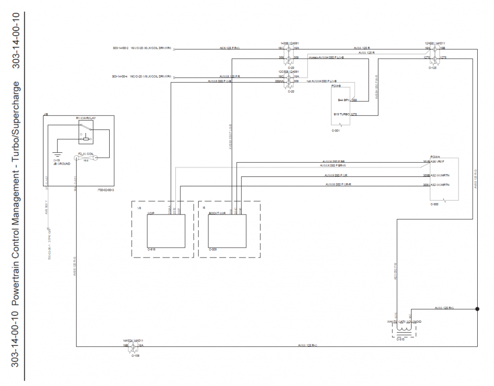

k31th less WHY; more WOT Site Developer 29,460 Member For: 17y 22d Gender: Male Location: Melbourne Posted 17/02/20 07:41 AM Share Posted 17/02/20 07:41 AM interesting situation you've got there, as that code is usually a disagreement between the Boost Pressure Sensor (BPS) and the Manifold Air Pressure/Temperature (T-MAP) sensor details but the T-MAP will just take over in circumstances like that... but I don't even know if the supercharged 5L's bothered with a BPS as the supercharger can't overboost like a turbocharger does and since the supercharger is right in the valley of the V8, I doubt there'd be any point also having a BPS here before the T-MAP in the manifold mere millimetres away. Link to comment https://www.fordxr6turbo.com/forum/topic/95517-supercharger-boost-sensor-a-circuit/#findComment-1692373 Share on other sites More sharing options...
k31th less WHY; more WOT Site Developer 29,460 Member For: 17y 22d Gender: Male Location: Melbourne Posted 17/02/20 09:25 AM Share Posted 17/02/20 09:25 AM turns out there is one, it's called the "SCIP"... not sure what that stands for, though (my guess is SuperCharger Internal Pressure, or something similar)... the connector front looks like this, though... it's connected like so: 1 Link to comment https://www.fordxr6turbo.com/forum/topic/95517-supercharger-boost-sensor-a-circuit/#findComment-1692377 Share on other sites More sharing options...
