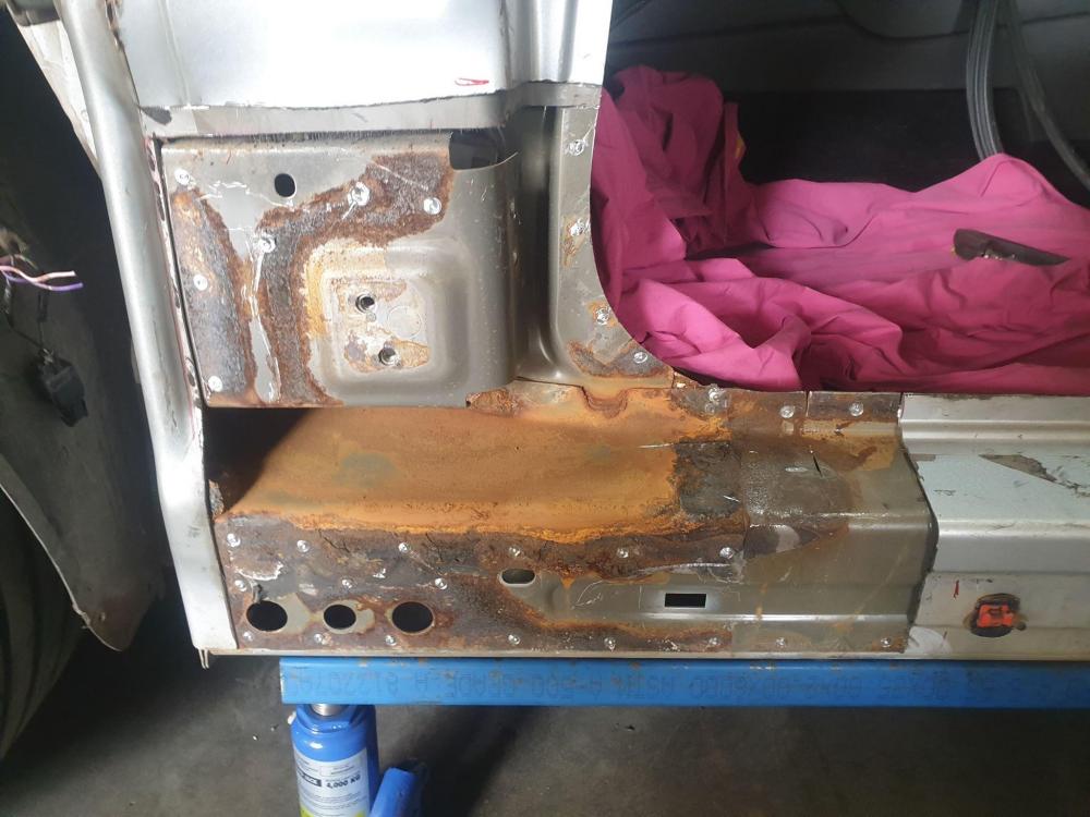

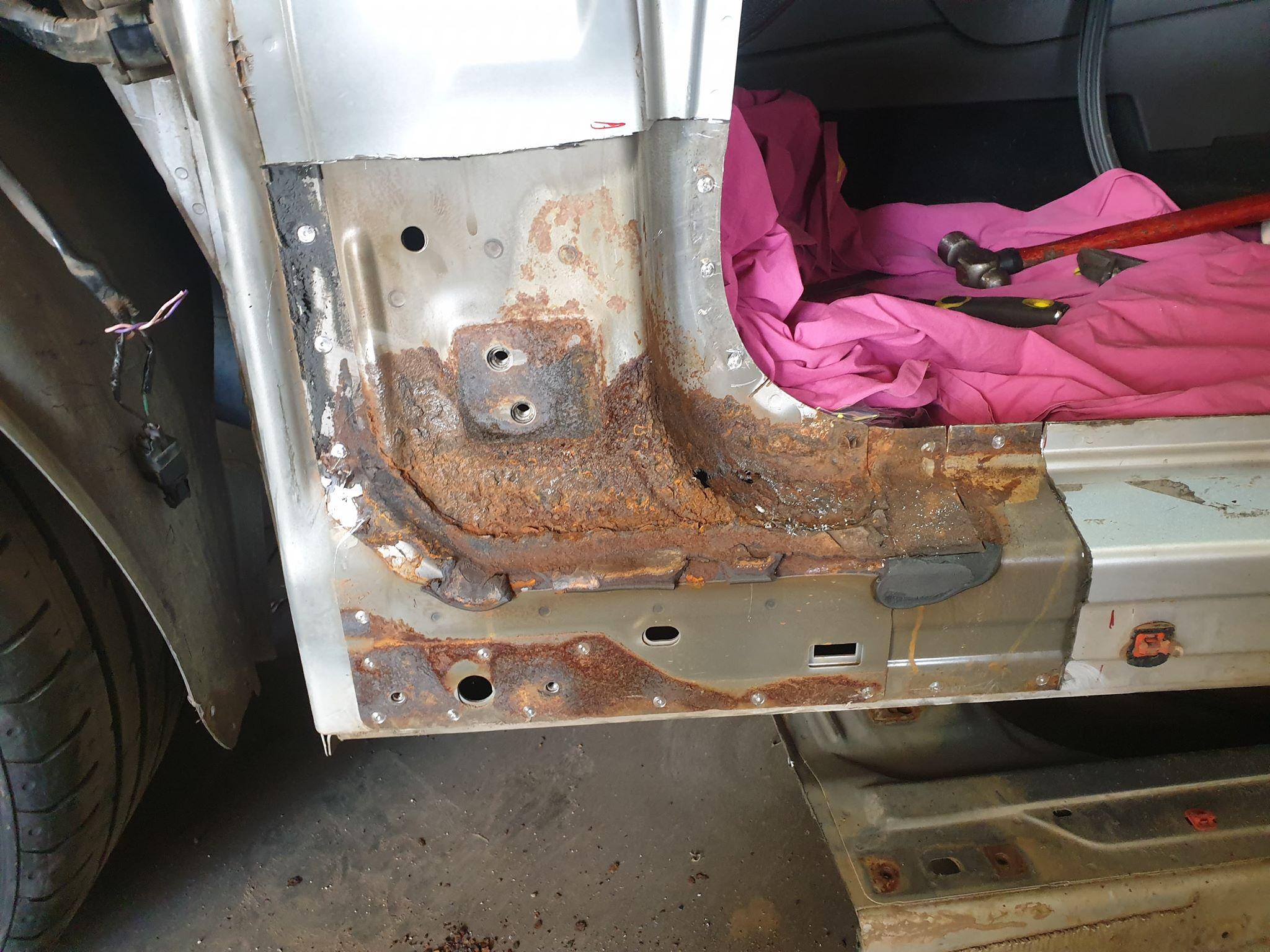

bupalooga Silver Donating Members 261 Member For: 12y 6m 4d Gender: Male Location: Griffith NSW Posted 29/01/20 06:18 AM Author Share Posted 29/01/20 06:18 AM Update.I eventually got the rust looked at and my god was it far worse than expected. And the believed culprit... This grommet that wasn't plugged in, most likely from yanking the wiring 4yrs ago while pulling the indicators out. Was getting welded back up today and should be getting painted next week. He took a heap of photos so I'll post some when I get em. 2 Link to comment Share on other sites More sharing options...

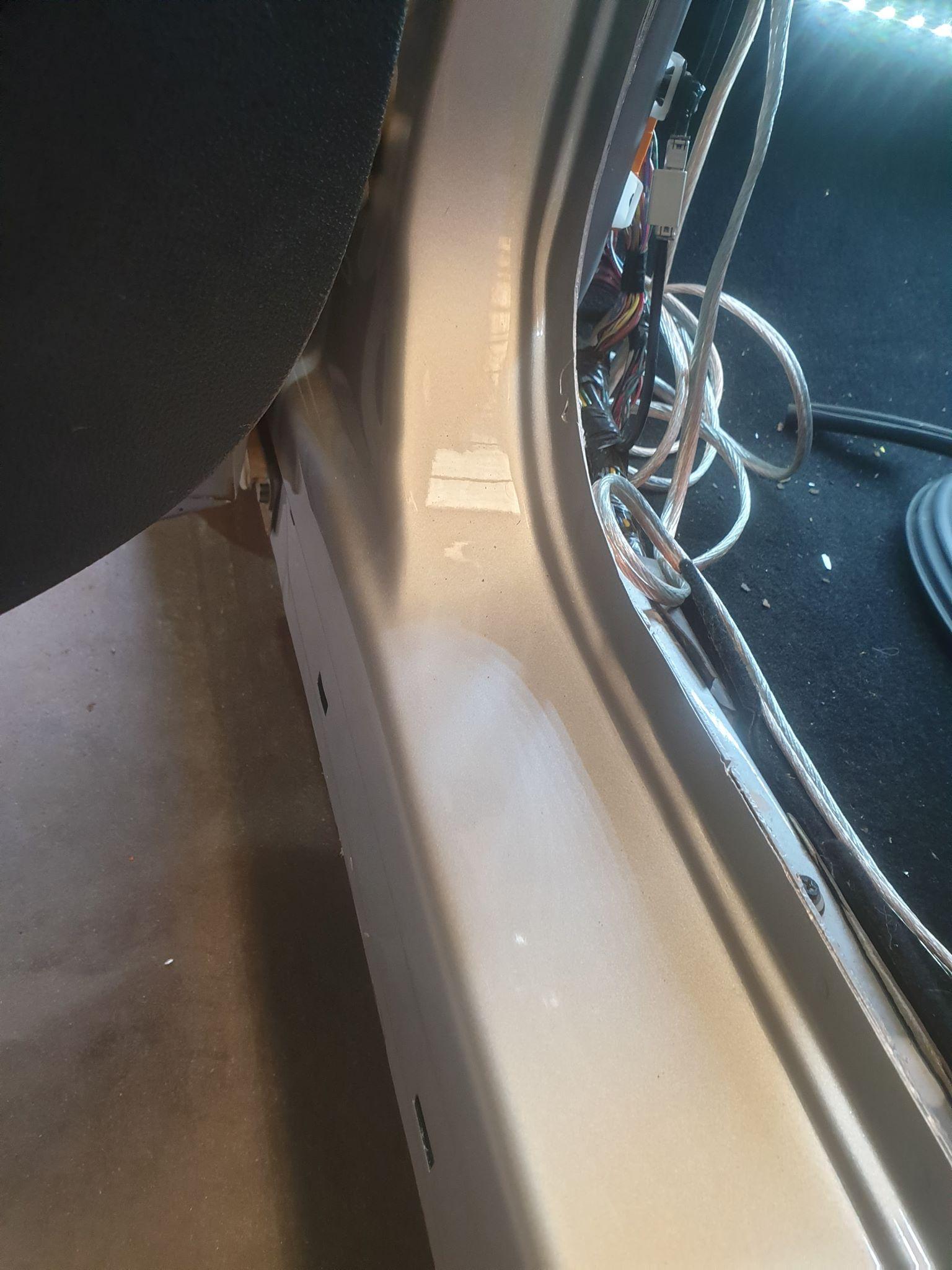

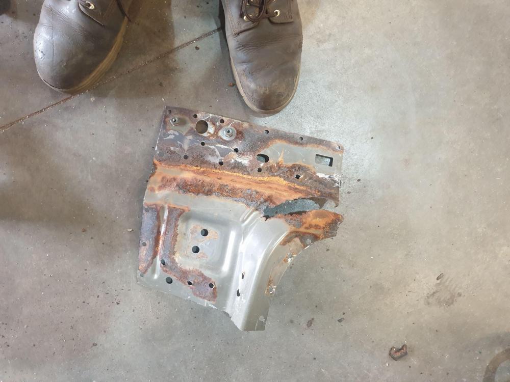

bupalooga Silver Donating Members 261 Member For: 12y 6m 4d Gender: Male Location: Griffith NSW Posted 11/03/20 11:26 AM Author Share Posted 11/03/20 11:26 AM Ill Chase the pics up off the guy, I think he should be back in town. The A/C typically drips onto the carpet from the center when its drain is blocked, not near the door sills. Directly above the grommet (just out of photo) there's a drain that comes from the windscreen. The guy tested with the grommet in & out and water was definitely pouring straight in that way. You can take the quarter panel off or unclip the plastic wheel arch lining and stick your head in there to see if the grommet has popped out or not. Total repairs and paint was around $2500 Cut out both the outer layer (pictured) and the middle layer or steel. The back layer was cleaned up and sealed before replacement outer & middle panels were welded back into place. Link to comment Share on other sites More sharing options...
bupalooga Silver Donating Members 261 Member For: 12y 6m 4d Gender: Male Location: Griffith NSW Posted 08/08/20 12:43 PM Author Share Posted 08/08/20 12:43 PM Finally remembered to chase up these photos. 2 1 Link to comment Share on other sites More sharing options...
