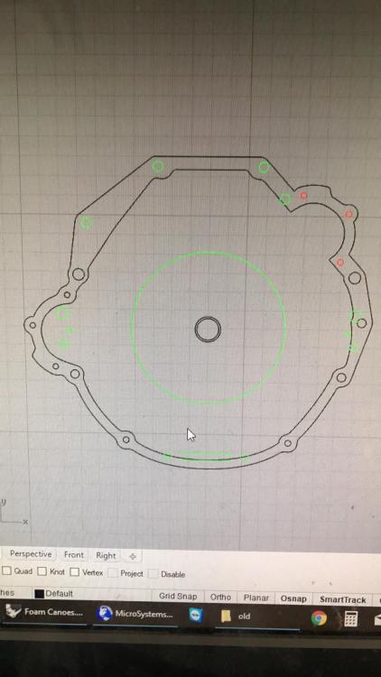

Mustangman570 Member 74 Member For: 11y 8m 30d Posted 10/09/18 08:20 PM Author Share Posted 10/09/18 08:20 PM Here is the cad drawing for my Mod motor to Barra transmission adapter plate. The Mod motor starter location interferes with the block on the Barra. So It will be blocked off on the transmission and become a structural mounting point. This adapter will use a Mod motor starter rotated to mount in the Barra mounting position. This will require a small notch to be cut out of the transmission. I will post pictures of the first test piece soon. 2 Link to comment https://www.fordxr6turbo.com/forum/topic/94246-barra-swapping-a-1993-foxbody-mustang-in-the-united-states-of-america/page/2/#findComment-1663824 Share on other sites More sharing options...

SelectivePC Member 79 Member For: 6y 9m 25d Posted 11/09/18 03:16 PM Share Posted 11/09/18 03:16 PM On 10/09/2018 at 8:20 PM, Mustangman570 said: Here is the cad drawing for my Mod motor to Barra transmission adapter plate. The Mod motor starter location interferes with the block on the Barra. So It will be blocked off on the transmission and become a structural mounting point. This adapter will use a Mod motor starter rotated to mount in the Barra mounting position. This will require a small notch to be cut out of the transmission. I will post pictures of the first test piece soon. Expand I will have to do the same thing for my trans, wanting to use a 6 speed, Nissan transmission. A buddy of mine makes kits currently for the CD009, to a lot of different blocks, so should be an interesting combination. Link to comment https://www.fordxr6turbo.com/forum/topic/94246-barra-swapping-a-1993-foxbody-mustang-in-the-united-states-of-america/page/2/#findComment-1663891 Share on other sites More sharing options...
Mustangman570 Member 74 Member For: 11y 8m 30d Posted 11/09/18 07:03 PM Author Share Posted 11/09/18 07:03 PM http://collinsadapters.com/index.php/lsx-350z-swap-kit.html This company makes an adapter to make a CD009 accept a T56 bellhousing. Use this adapter plate on the transmission then you will be able to use a factor Barra T56 bellhousing. Link to comment https://www.fordxr6turbo.com/forum/topic/94246-barra-swapping-a-1993-foxbody-mustang-in-the-united-states-of-america/page/2/#findComment-1663892 Share on other sites More sharing options...
