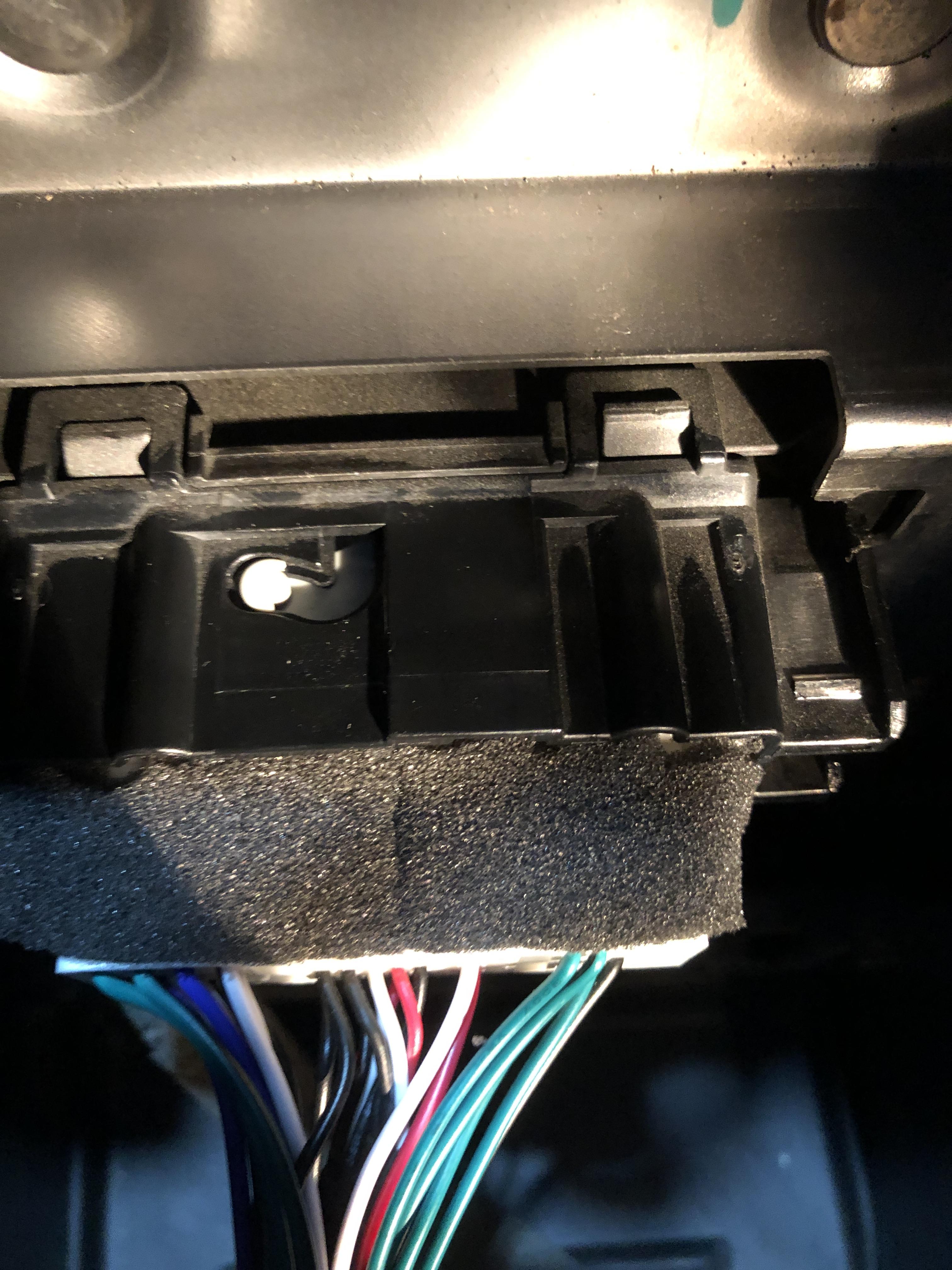

NateXR6T Member 46 Member For: 20y 4m 11d Gender: Male Location: Toowoomba Queensland Posted 13/04/19 09:55 PM Share Posted 13/04/19 09:55 PM Puffwagon is the lever in the photo or is that a different plug. Pic of plug as far as I can get it in. It looks and feels all the way in. The unit will power up and has sound to speakers but I have comms error on dash. Link to comment https://www.fordxr6turbo.com/forum/topic/94218-fg-mk-1-2-fgx-babf-and-territory-replacement-icc/page/18/#findComment-1681529 Share on other sites More sharing options...

Puffwagon Puff Gold Donating Members 16,297 Member For: 10y 2m 26d Gender: Male Location: South Australia Posted 14/04/19 12:41 AM Share Posted 14/04/19 12:41 AM On 13/04/2019 at 9:55 PM, NateXR6T said: Puffwagon is the lever in the photo or is that a different plug. Expand I can't remember cos I only had my icc out once and it was a couple of years ago. I do remember that it felt like it was pressed all the way in when it actually wasn't. Link to comment https://www.fordxr6turbo.com/forum/topic/94218-fg-mk-1-2-fgx-babf-and-territory-replacement-icc/page/18/#findComment-1681533 Share on other sites More sharing options...
