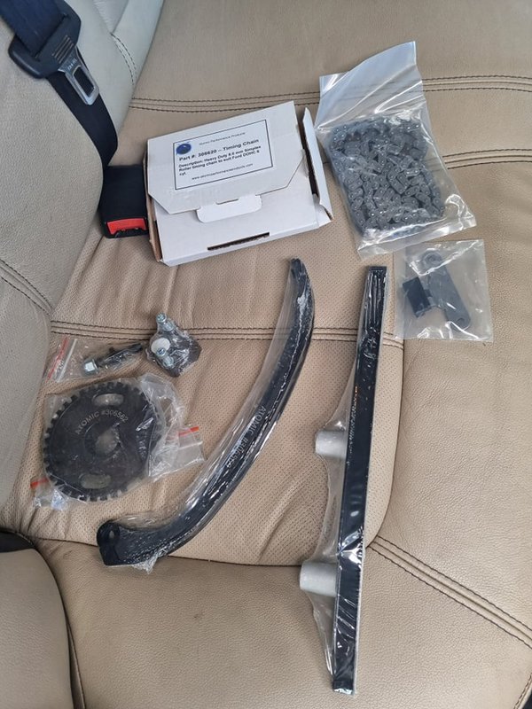

skotty Member 52 Member For: 11y 5m 10d Posted 04/09/21 01:47 AM Author Share Posted 04/09/21 01:47 AM On 28/08/2021 at 8:38 AM, Puffwagon said: I'll be there if I get my trans sorted in time. Expand Hopefully you get that sorted, keen to see the territory out! So I preparation for roll racing I was talking to a mate about doing my timing chain guides and my tuner recommended doing the chain and sprocket too as its up around 220k old now, and silly me has been driving it with a broken exhaust side chain guide on the top where they all go.. Been rolling the dice I guess so far and I've been lucky.. Me mate had this sitting in his shed The atomic timing chain kit, just doing some research before I go ahead and fit it up as I'm hearing a couple of people say to run a brand new genuine ford chain tensioner as there was a bad batch of atomic ones.. Also I want to find out if the intake side chain guide with the atomic kit mean to be a atomic branded item of if its just a OEM one, as there no markings on it? Think my mate bought the kit off Facebook 12 months ago... I sort of half cant be bothered putting the kit thru it as its going to need engine work done soon enough, but I don't want to break it over ignorance for a afternoon job. The biggest paint in the arse will be trying to get the rocker cover to seal as the *trusted shop* who assembled my engine used sealant all over the sump and timing chain cover.. When I originally put the motor in I ran a BA sump as I wanted rubber gaskets over sealant.. What do ya do eh! Hopefully I dont balls this up and it makes it to Tailem Bend! 1 Link to comment https://www.fordxr6turbo.com/forum/topic/94194-ba-fairlane-turbo/page/4/#findComment-1707340 Share on other sites More sharing options...
