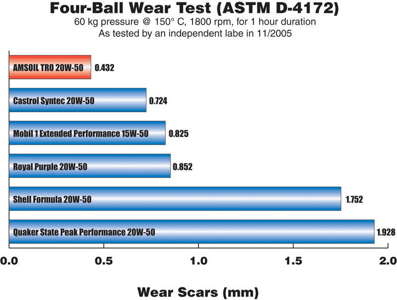

SILK RSPEC Donating Members 193 Member For: 17y 5m 13d Gender: Male Location: Brisbane Southside Posted 23/06/08 07:01 AM Share Posted 23/06/08 07:01 AM This is what I found on the AMSoil site which actually puts royal purple down on the list.I guess when people are doing test sometimes they don't do oil's that are better than them or just leave them off the listhow about this a 409,000 mile truck with no wearthey also did a taxi a while ago but I can't seem to find the linkhttp://www.amsoil.com/testimonials/409000.aspx Link to comment https://www.fordxr6turbo.com/forum/topic/93477-oils-aint-oils/page/20/#findComment-697151 Share on other sites More sharing options...
Adam Here since the start... Lifetime Members 10,282 Member For: 21y 11m 18d Gender: Male Location: Victoria Posted 23/06/08 07:26 AM Share Posted 23/06/08 07:26 AM Nothing can do 409,000 miles without some wear. It's impossible.Reading that article shows they added a bypass filter setup. That would greatly extend the oils life because they filter the oil much more finely than a conventional full flow filter (like the XR6T has).Another thing to take into account is that trucks like that don't rev much more than 2200rpm.It's funny how you can't open any of the pictures in that article to a larger size.No engine builder in their right mind would put any of that stuff back in the engine!I think putting 20W oil in is not a good idea. It's to thick. Link to comment https://www.fordxr6turbo.com/forum/topic/93477-oils-aint-oils/page/20/#findComment-697170 Share on other sites More sharing options...
