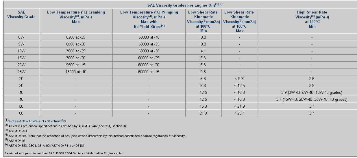

Lawsy Wanabe mechanical engineer Donating Members 960 Member For: 20y 6m 14d Gender: Male Location: At the computer, obviously..... Posted 28/05/08 05:38 AM Share Posted 28/05/08 05:38 AM Ok so here is what I'm trying to get at.Firstly, take a look at this table here (its the SAE standard's table, published basically everywhere in technical articles relating to oil viscosity.Now, make a mental note of some of those numbers, some of them may not mean a whole lot in practical terms, but they are all very important.Ok the first column represents the highest viscosity value a tested oil may have to fit into a particular grade/category. This means that in order to obtain a rating as 0w, the cranking viscosity must be below 6200 @ -35°C. The temperatures are vitally important when reading these values.Take a look at the low shear max values for the 0w and the 5w oils (4th column), its the same (3.. The viscosity value for these two grades of oil almost converge and make a similar path if plotted on a temp/viscosity diagram. They are most different at the lower extreme temperatures, least different from about 40 onwards. In the real world, from around 0°C-20°C, they are similar enough in viscosity performance that it is negligible. The true pour point of a 0w oil is much lower than a 5w oil though, sometimes by as much as 15 degrees! That is why it exists, though.Note, these values are not the be all and end all values for grading an oil, these are only some of the requirements that an oil must meet in order to be classified by the standard. I can't find the others (wish I could though, as there is more to the story).Now take a look at the values for the grades not suffixed by W, these values represent your running temperature viscosity and therefore your running temp performance.See how the 60 grade starts at 21.9 and ends at 26.1 (measured in centistokes)? Its safe to assume that oils like HPR15, Edge 10w-60 are very close to the 21.9 value. Which makes perfect sense, as these oils are designed for modern engines, they wouldn't want to be near the 26.1, as this would well and truly be too viscous, and practical examination of an engines performance agree's (go run a cheap xxw-60 vs the edge 10w-60 or HPR15 and you'll see why). BUT, I still would not recommend anyone here run a 60 grade oil in a post BA Ford I6 motor that isn't a track day special, where the 60 would actually thin down, due to the significantly higher heat involved, to a viscosity of an average 50 grade anyway, providing an increased film strength for such a high level of engine loading.Ok so, take a quick look at the last column, see how there is two entries for 40 grade oils? This is because there is a jump in the amount of viscosity indexing required to prevent a 10w oil from thinning beyond the 40 grade, than a 15w would... With fully synthetics though, this isn't a bad thing, since the oil is designed with its intended viscosity in mind, so the composition of the synthetic itself will have inherent viscosity indexing due to the way it was engineered. This means it can have a lower viscosity under high stress but maintain a high film strength at the same time.Today's oils are simply awesome in what they do. I have a lot of respect for the engineers who manage to calculate and formulate these oils, as they manage to provide awesome properties under so many different stresses and flow rates that we are bordering on lubricant perfection. If you run the correct viscosity for your engine, you can run the engine hard after 30 seconds without too much worry. Which is what I've been trying to get at all along.The numbers are there, the temperatures you feel in the mornings and the way you drive/how much power you have, are your guide. Use your head, consider all of the information you can, and you should be able to come out with an oil that will satisfy your situation.Though I don't really think its required, you can even run a winter and a summer grade oil. Run something thinner in winter, and slightly thicker in summer. But I don't really recommend you do this, as your engine is designed to maintain its core temperature within a fairly wide ambient temperature range. A range that covers 99.9% of Australia, 4 seasons a year. Ford may do some stupid things sometimes, but when it comes to these engines, they certainly have done their homework.So, full synthetic 10w-40 still wins out for the majority of you blokes running either standard or fairly modified motors. If you're in BCL's league though, ask Simon from Nizpro; I've given up trying to figure out what oil is needed in such an extreme case (it's a toss up between M1 5w-50, RP 10w-50 and Nulon 10w-40). Too many pro's for each oil, without enough con's to sway the balance. You decide. Link to comment Share on other sites More sharing options...
