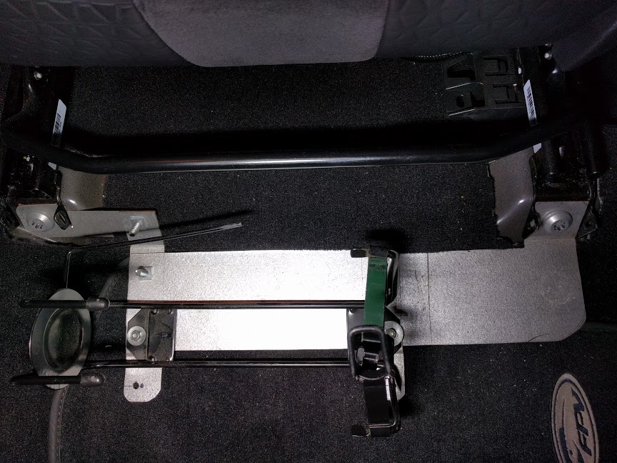

  • Member
  • Member For: 17y 7m 26d
I made one from some scrap steel that I picked up from the tip. This is the second one I've made, first was for my old XR5 and that was much simpler and sturdier. This one is a few pieces bolted together but it's been passed multiple times by some of the pickiest CAMS scrutineers I've come across. It holds a 2kg extinguisher which was a requirement for an event I was entering, most general track days only require 1kg. Trim doesn't fit over the top, couldn't be bothered designing something that looked good, just needed to be functional and easy to install/remove.
