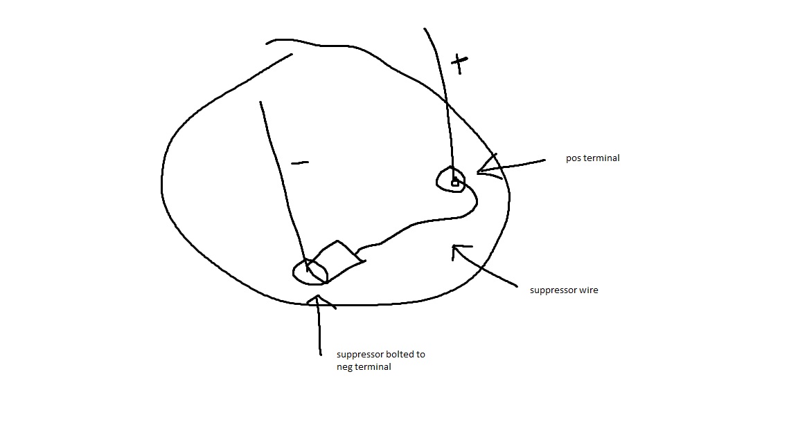

Force88 Donating Members 64 Member For: 14y 6m 5d Gender: Male Location: NQ Posted 29/06/17 04:06 AM Author Share Posted 29/06/17 04:06 AM ok bought some earth leads and one of those noise suppressors you fit to to the back of the alternator finally gonna have a crack at this today. before I put it on just wanna make sure that this is how the suppressor is supposed to be fitted? Link to comment Share on other sites More sharing options...
