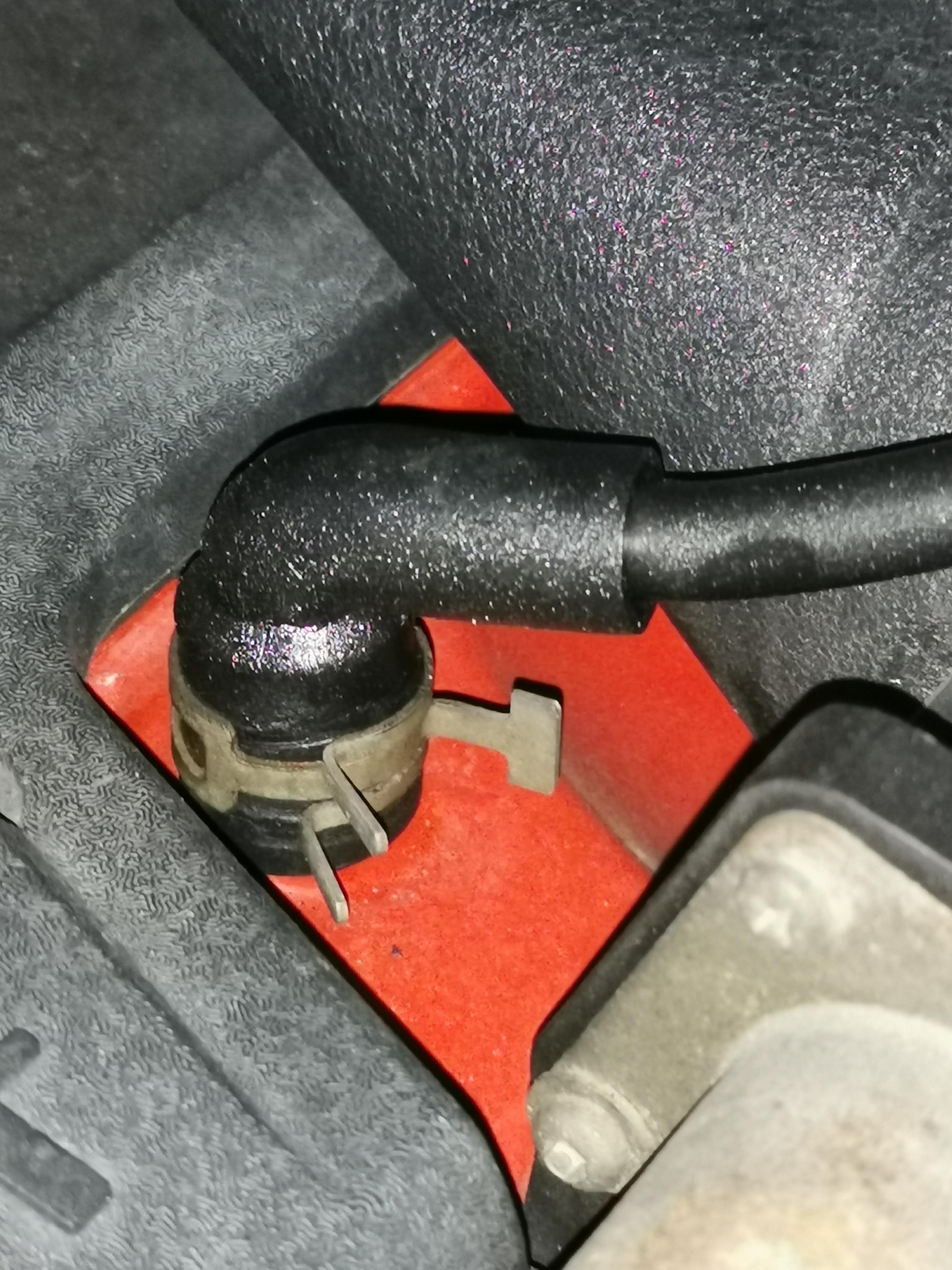

ToXic BF Beast New Member 18 Member For: 10y 6m 13d Gender: Male Location: Dee Why Posted 14/03/17 01:46 PM Share Posted 14/03/17 01:46 PM Hi guys, Need help, what would you call this silicone hose going from the air intake manifold into the top of my engine? its frayed/split and just wondering what its called to replace.. im guessing its just an air hose but I really dont know enough.. http://s1376.photobucket.com/user/jeabmasnok88/media/bf xr6t_zpsgew0sfis.jpg.html thanks everybody Link to comment https://www.fordxr6turbo.com/forum/topic/93033-what-is-this-hose-for/ Share on other sites More sharing options...
k31th less WHY; more WOT Site Developer 29,492 Member For: 17y 1m Gender: Male Location: Melbourne Posted 14/03/17 02:01 PM Share Posted 14/03/17 02:01 PM it's part of the PCV system that returns oily vapour from the crank-case to the intake duct. Link to comment https://www.fordxr6turbo.com/forum/topic/93033-what-is-this-hose-for/#findComment-1634403 Share on other sites More sharing options...
ToXic BF Beast New Member 18 Member For: 10y 6m 13d Gender: Male Location: Dee Why Posted 14/03/17 02:06 PM Author Share Posted 14/03/17 02:06 PM thanks k31th, is it a big deal to leave it for a couple of weeks.. when the engine is idle and I move the hose around it doesnt seem to effect the engine idle in anyway.. where can I order a new one (pls dont say ford) ,, what would a newb like myseld call this hose? Link to comment https://www.fordxr6turbo.com/forum/topic/93033-what-is-this-hose-for/#findComment-1634405 Share on other sites More sharing options...
k31th less WHY; more WOT Site Developer 29,492 Member For: 17y 1m Gender: Male Location: Melbourne Posted 14/03/17 02:11 PM Share Posted 14/03/17 02:11 PM I don't know a specific name for that hose, as it's just a 45deg bend of plastic hosing, realistically. It's the bits on the end that can fail or break off. Yes, ford is obviously a place to order it or a wrecker (or somebody who has this part of the crossover still and doesn't need it anymore after replacing the piping). You can leave it, but it'll just spray oily vapour into the engine bay making a slow horrible mess. 1 Link to comment https://www.fordxr6turbo.com/forum/topic/93033-what-is-this-hose-for/#findComment-1634406 Share on other sites More sharing options...
ToXic BF Beast New Member 18 Member For: 10y 6m 13d Gender: Male Location: Dee Why Posted 14/03/17 02:43 PM Author Share Posted 14/03/17 02:43 PM Well I found one on eBay.. $51.. its called a ROCKER COVER VENT AIR HOSE.. better off fabricating my own I think Link to comment https://www.fordxr6turbo.com/forum/topic/93033-what-is-this-hose-for/#findComment-1634408 Share on other sites More sharing options...
k31th less WHY; more WOT Site Developer 29,492 Member For: 17y 1m Gender: Male Location: Melbourne Posted 14/03/17 02:44 PM Share Posted 14/03/17 02:44 PM yeah; that'd be the ford spare parts price. Link to comment https://www.fordxr6turbo.com/forum/topic/93033-what-is-this-hose-for/#findComment-1634409 Share on other sites More sharing options...

clevo400 Member 33 Member For: 14y 3m 17d Gender: Male Location: Townsville Posted 20/02/22 02:42 PM Share Posted 20/02/22 02:42 PM On 14/03/2017 at 2:43 PM, ToXic BF Beast said: better off fabricating my own I think Expand Hey mate, did you end up making one yourself. I looked at a heap of 90 degree rubber boots but no luck. I think the FG vent hose uses the same rubber boot and is much cheaper than the BA one. Link to comment https://www.fordxr6turbo.com/forum/topic/93033-what-is-this-hose-for/#findComment-1710657 Share on other sites More sharing options...
