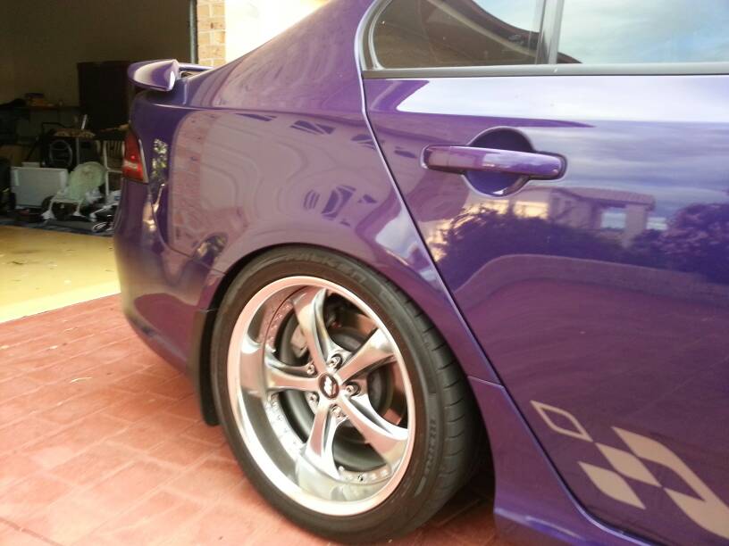

vxr50t Member 134 Member For: 12y 24d Posted 11/05/15 09:54 AM Share Posted 11/05/15 09:54 AM I reckon you can make em fit Tom but you'll def need to run a 5mm spacer to make the rears clear the trailing arm which will make them +33These are how mine looked when I was moving some weights for a mate and had the boot fully loaded. It had about 2mm clearance between the tyre and guard and bear in mind the tyre is bigger than a std 285I reckon with 275s they'll fit perfect even if they're oversized 275sAlso, is your car lowered? Link to comment https://www.fordxr6turbo.com/forum/topic/92946-fg-offsets-and-tyre-questions/page/276/#findComment-1544028 Share on other sites More sharing options...
TomT Spooling Member Donating Members 961 Member For: 13y 4m 29d Gender: Male Location: Blue Mountains, NSW Posted 11/05/15 10:32 AM Share Posted 11/05/15 10:32 AM I can use a spacer to inset the control blade rather than a hub spacer so I don't lose any guard clearance. It's on Shockworks coilovers, haven't set everything up yet so height will depend on wheels, not an issue Link to comment https://www.fordxr6turbo.com/forum/topic/92946-fg-offsets-and-tyre-questions/page/276/#findComment-1544031 Share on other sites More sharing options...
Bellato Donating Members 2,713 Member For: 14y 6m 16d Posted 11/05/15 11:30 AM Share Posted 11/05/15 11:30 AM The control blade spacer won't change things because its the 'knuckle' on the hub that is the problem and a spacer won't move thatEveryone says there is no room to move with FG guards but this is a lie. I got at least 10mm more clearance from rolling and pumping my guards, and that wasn't pushing them too far 1 Link to comment https://www.fordxr6turbo.com/forum/topic/92946-fg-offsets-and-tyre-questions/page/276/#findComment-1544034 Share on other sites More sharing options...
TomT Spooling Member Donating Members 961 Member For: 13y 4m 29d Gender: Male Location: Blue Mountains, NSW Posted 11/05/15 11:32 AM Share Posted 11/05/15 11:32 AM Ahh I see ^Must only be with 19/20 inch that trick works Link to comment https://www.fordxr6turbo.com/forum/topic/92946-fg-offsets-and-tyre-questions/page/276/#findComment-1544035 Share on other sites More sharing options...
