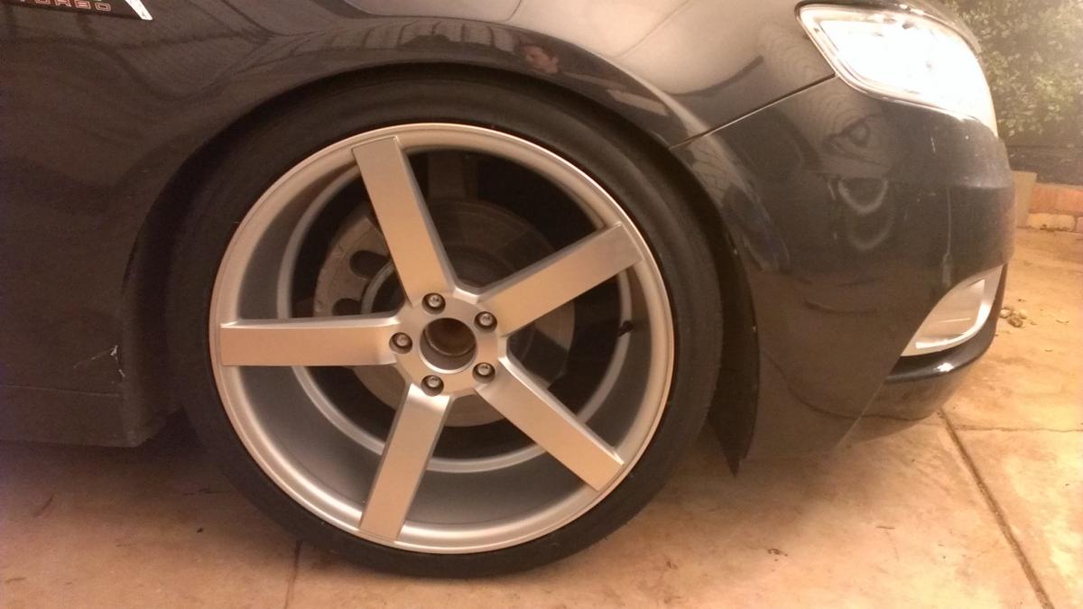

mummba Member 525 Member For: 15y 2m 8d Gender: Male Location: perth Posted 05/06/13 10:13 AM Share Posted 05/06/13 10:13 AM On 05/06/2013 at 2:49 AM, RowdyBurns said: Hunting down some new wheels, looking for the best fitment for FG ute when lowered without guard work. Can you get a 19x9.5 under the front? Front options: 19x8.5 +35 19x8.5 +25 19x9.5 +38 19x9.5 +25 19x9.5 +15 Rear options, need to fill the guards? 19x10.5 +32 19x10.5 +22 19x10.5 +12 19x11.0 +18 Thanks guys19x9.5 will fit and in +25 would be nice, will sit 5mm outside the guard, I have 19x10+25 all round on ssl front sssl rears no guard work no scrubbing Link to comment https://www.fordxr6turbo.com/forum/topic/92946-fg-offsets-and-tyre-questions/page/202/#findComment-1395954 Share on other sites More sharing options...

Bulletime Donating Members 937 Member For: 14y 4m 5d Gender: Male Posted 05/06/13 12:14 PM Share Posted 05/06/13 12:14 PM Sexy F6 there, very nice!So before I pay for my order, tirerack looks the best actually... but yeah got quoted on thisEnkei PF0118x8.5+30 with 255/40 Michelin PSS18x9.5+35 with 274/35checked the circumferences and they're all pretty close and from the sounds of everything else they shouldn't have any clearance issues. Link to comment https://www.fordxr6turbo.com/forum/topic/92946-fg-offsets-and-tyre-questions/page/202/#findComment-1396021 Share on other sites More sharing options...
FIXR7 Member 116 Member For: 14y 11m 19d Gender: Male Location: Perth Posted 05/06/13 01:46 PM Share Posted 05/06/13 01:46 PM Nice lookin F6 alright!Just an observation and I know that lots of people say this but....How about instead of saying SSL or SSSL etc why not something more meaningful? Like the measured height from the ground to the guard lip or centre of the wheel to guard lip? Something like that. I mean ssl etc is a bit like saying I've got a stage 2 cam or a stage 3 shift kit....meaningless. 1 Link to comment https://www.fordxr6turbo.com/forum/topic/92946-fg-offsets-and-tyre-questions/page/202/#findComment-1396055 Share on other sites More sharing options...
fr33r Donating Members 92 Member For: 12y 8m 25d Gender: Male Location: Riverina NSW Posted 05/06/13 06:26 PM Share Posted 05/06/13 06:26 PM On 05/06/2013 at 12:14 PM, Bulletime said: Sexy F6 there, very nice!So before I pay for my order, tirerack looks the best actually... but yeah got quoted on thisEnkei PF0118x8.5+30 with 255/40 Michelin PSS18x9.5+35 with 274/35checked the circumferences and they're all pretty close and from the sounds of everything else they shouldn't have any clearance issues.You will have no problems with the Enkei setup Link to comment https://www.fordxr6turbo.com/forum/topic/92946-fg-offsets-and-tyre-questions/page/202/#findComment-1396065 Share on other sites More sharing options...
Pazzo Donating Members 11,132 Member For: 14y 6m 22d Gender: Male Posted 05/06/13 08:18 PM Share Posted 05/06/13 08:18 PM Mummba your ute was mint.. But your F6 is great. You always know what wheels work. Link to comment https://www.fordxr6turbo.com/forum/topic/92946-fg-offsets-and-tyre-questions/page/202/#findComment-1396070 Share on other sites More sharing options...
RowdyBurns Donating Members 641 Member For: 17y 2m 6d Gender: Male Location: Brisbane Posted 05/06/13 10:40 PM Share Posted 05/06/13 10:40 PM Mummba that looks awesome. Got a side on shot? And thanks for the info 9.5 +25 on the front, now to decide on rears :D Link to comment https://www.fordxr6turbo.com/forum/topic/92946-fg-offsets-and-tyre-questions/page/202/#findComment-1396082 Share on other sites More sharing options...
RowdyBurns Donating Members 641 Member For: 17y 2m 6d Gender: Male Location: Brisbane Posted 05/06/13 10:47 PM Share Posted 05/06/13 10:47 PM All good found one on your photo bucket. Link to comment https://www.fordxr6turbo.com/forum/topic/92946-fg-offsets-and-tyre-questions/page/202/#findComment-1396083 Share on other sites More sharing options...
