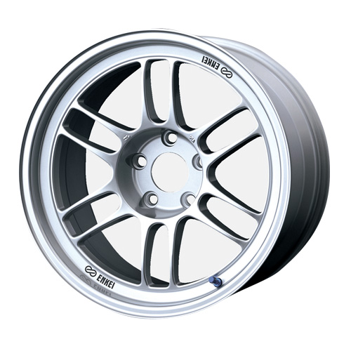

stevanford Member 268 Member For: 13y 3m 26d Posted 20/05/13 12:43 AM Share Posted 20/05/13 12:43 AM On 20/05/2013 at 12:27 AM, Bellato said: Yea I would still probably go with +35, +25 or lower will just come too close to the guard and no need for flush drag wheels lolCheers mate. It seems that 17x9s with +35 offset only comes with wheels that have a 5x100 stud pattern. I may have to go with the 9.5s with +30 offset. Will they be ok ? Link to comment https://www.fordxr6turbo.com/forum/topic/92946-fg-offsets-and-tyre-questions/page/195/#findComment-1390902 Share on other sites More sharing options...
Bellato Donating Members 2,713 Member For: 14y 7m 8d Posted 20/05/13 12:57 AM Share Posted 20/05/13 12:57 AM (edited) +30 in 9.5 will be close but should be right, you gonna run a 275/40? Et tyre?If the cars not too low you should get away with it thoughAlso check out a few places here n there, each supplier seems to do different offers for rotas, currently looking at getting a set myself Edited 20/05/13 12:59 AM by Bellato Link to comment https://www.fordxr6turbo.com/forum/topic/92946-fg-offsets-and-tyre-questions/page/195/#findComment-1390906 Share on other sites More sharing options...
stevanford Member 268 Member For: 13y 3m 26d Posted 20/05/13 01:00 AM Share Posted 20/05/13 01:00 AM On 20/05/2013 at 12:57 AM, Bellato said: +30 in 9.5 might be pushing it a bit, you gonna run a 275/40? Et tyre?If the cars not too low you should get away with it thoughGoing to run Et streets or NT05Rs on a 275. Car hasn't been lowered. Link to comment https://www.fordxr6turbo.com/forum/topic/92946-fg-offsets-and-tyre-questions/page/195/#findComment-1390907 Share on other sites More sharing options...
Bellato Donating Members 2,713 Member For: 14y 7m 8d Posted 20/05/13 01:30 AM Share Posted 20/05/13 01:30 AM Should fit no worries then! Link to comment https://www.fordxr6turbo.com/forum/topic/92946-fg-offsets-and-tyre-questions/page/195/#findComment-1390910 Share on other sites More sharing options...
stevanford Member 268 Member For: 13y 3m 26d Posted 20/05/13 01:46 AM Share Posted 20/05/13 01:46 AM On 20/05/2013 at 1:30 AM, Bellato said: Should fit no worries then!Thanks for your help. I did find another set of wheels. 17x9 with +35 offset. Have to decide which I want more lol. 1 Link to comment https://www.fordxr6turbo.com/forum/topic/92946-fg-offsets-and-tyre-questions/page/195/#findComment-1390913 Share on other sites More sharing options...
stevanford Member 268 Member For: 13y 3m 26d Posted 20/05/13 03:17 AM Share Posted 20/05/13 03:17 AM Because I'm a noob with wheels and offsets and whatnot, 17x9s with +35 offset will fit on the back of an FG with drag radials ? Link to comment https://www.fordxr6turbo.com/forum/topic/92946-fg-offsets-and-tyre-questions/page/195/#findComment-1390934 Share on other sites More sharing options...
fr33r Donating Members 92 Member For: 12y 9m 8d Gender: Male Location: Riverina NSW Posted 20/05/13 03:29 AM Share Posted 20/05/13 03:29 AM On 20/05/2013 at 3:17 AM, stevanford said: Because I'm a noob with wheels and offsets and whatnot, 17x9s with +35 offset will fit on the back of an FG with drag radials ?Depending how much the car squats when launching you might be very close to contact using the 9.5 +30. Will go out by about 26mm from std and in by 13mm.9.0 +35 would be 13mm further in and 13mm further out and would clear everything by plenty. Link to comment https://www.fordxr6turbo.com/forum/topic/92946-fg-offsets-and-tyre-questions/page/195/#findComment-1390939 Share on other sites More sharing options...
stevanford Member 268 Member For: 13y 3m 26d Posted 20/05/13 03:53 AM Share Posted 20/05/13 03:53 AM On 20/05/2013 at 3:29 AM, fr33r said: Depending how much the car squats when launching you might be very close to contact using the 9.5 +30. Will go out by about 26mm from std and in by 13mm.9.0 +35 would be 13mm further in and 13mm further out and would clear everything by plenty.Thanks for the help. I think I'll stick to 17x9s with the +35 offset then. Link to comment https://www.fordxr6turbo.com/forum/topic/92946-fg-offsets-and-tyre-questions/page/195/#findComment-1390951 Share on other sites More sharing options...
stevanford Member 268 Member For: 13y 3m 26d Posted 20/05/13 05:53 AM Share Posted 20/05/13 05:53 AM 17x9 +35. Oh god... Link to comment https://www.fordxr6turbo.com/forum/topic/92946-fg-offsets-and-tyre-questions/page/195/#findComment-1391020 Share on other sites More sharing options...
