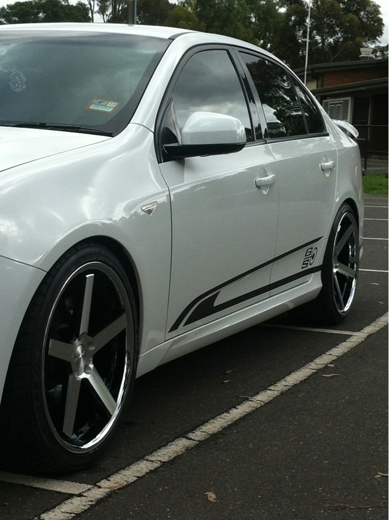

Wayno Member 111 Member For: 13y 5m 2d Posted 21/02/13 03:10 AM Share Posted 21/02/13 03:10 AM No spacers running 8.5"x20" 35 offset fronts and 10"x20" 42 offset rears tyres 245/35 fronts and 275/30 rears I hope that helps out some of you 2 Link to comment https://www.fordxr6turbo.com/forum/topic/92946-fg-offsets-and-tyre-questions/page/179/#findComment-1365061 Share on other sites More sharing options...
Wayno Member 111 Member For: 13y 5m 2d Posted 21/02/13 03:19 AM Share Posted 21/02/13 03:19 AM This is the look I'm after so there's still a bit of work to do for me suspension / tyres will have to be changed will keep u all posted Link to comment https://www.fordxr6turbo.com/forum/topic/92946-fg-offsets-and-tyre-questions/page/179/#findComment-1365069 Share on other sites More sharing options...

evo Member 33 Member For: 13y 6m 3d Gender: Male Location: East Suburbs, VIC Posted 21/02/13 06:17 AM Share Posted 21/02/13 06:17 AM (edited) Looks nice wayno! The concave looks a lil deeper on the front of the bmw than yours, I'm guessing the bmw can fit a wider rim/lower offset but seems like you could of gone a little more on the front too.I'm looking at the Rohana RC10 wheels in matt black, 20x10" and 20x11" on rear, not sure on offset yet but you can choose your offset as its made to order.Can use this offset calculator that's handy and get a measuring tape out which will give some idea: http://www.1010tires.com/WheelOffsetCalculator.asp Edited 21/02/13 06:21 AM by evo Link to comment https://www.fordxr6turbo.com/forum/topic/92946-fg-offsets-and-tyre-questions/page/179/#findComment-1365137 Share on other sites More sharing options...
Wayno Member 111 Member For: 13y 5m 2d Posted 21/02/13 08:04 AM Share Posted 21/02/13 08:04 AM Wasn't sure if I would get away with 10's on the front not many have done , so I played it safe but I will go more aggressive with my tyre selection next time and look to maybe use some spacers as well Link to comment https://www.fordxr6turbo.com/forum/topic/92946-fg-offsets-and-tyre-questions/page/179/#findComment-1365173 Share on other sites More sharing options...
