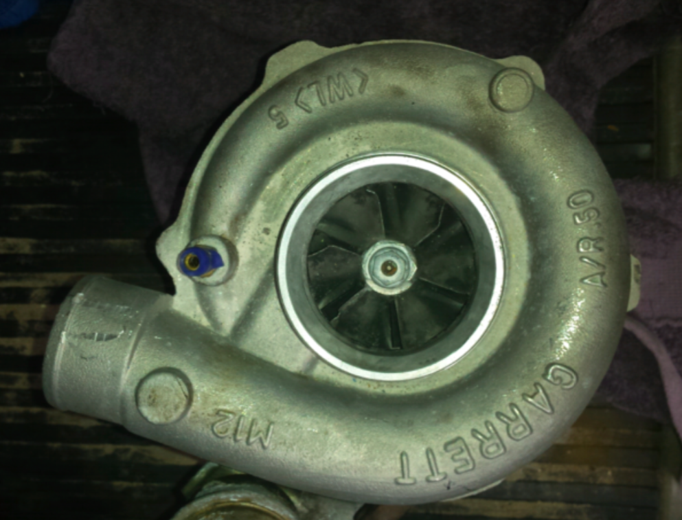

Kato1290 Member 35 Member For: 8y 3m 4d Posted 09/03/17 01:54 AM Author Share Posted 09/03/17 01:54 AM Hey boys can anyone confirm this is the stock turbo that I need? Link to comment https://www.fordxr6turbo.com/forum/topic/92932-just-bought-my-first-barra/page/9/#findComment-1633834 Share on other sites More sharing options...
k31th less WHY; more WOT Site Developer 29,506 Member For: 17y 1m 10d Gender: Male Location: Melbourne Posted 09/03/17 01:56 AM Share Posted 09/03/17 01:56 AM uhh, even if that is the right turbo, you can clearly see that it has bent fins, so it's not worth purchasing as you'll have to repair it at significant cost. 1 Link to comment https://www.fordxr6turbo.com/forum/topic/92932-just-bought-my-first-barra/page/9/#findComment-1633836 Share on other sites More sharing options...
Kato1290 Member 35 Member For: 8y 3m 4d Posted 09/03/17 01:58 AM Author Share Posted 09/03/17 01:58 AM That was my next question haha I <3 Bananas I'm so over this sh*t Link to comment https://www.fordxr6turbo.com/forum/topic/92932-just-bought-my-first-barra/page/9/#findComment-1633837 Share on other sites More sharing options...
