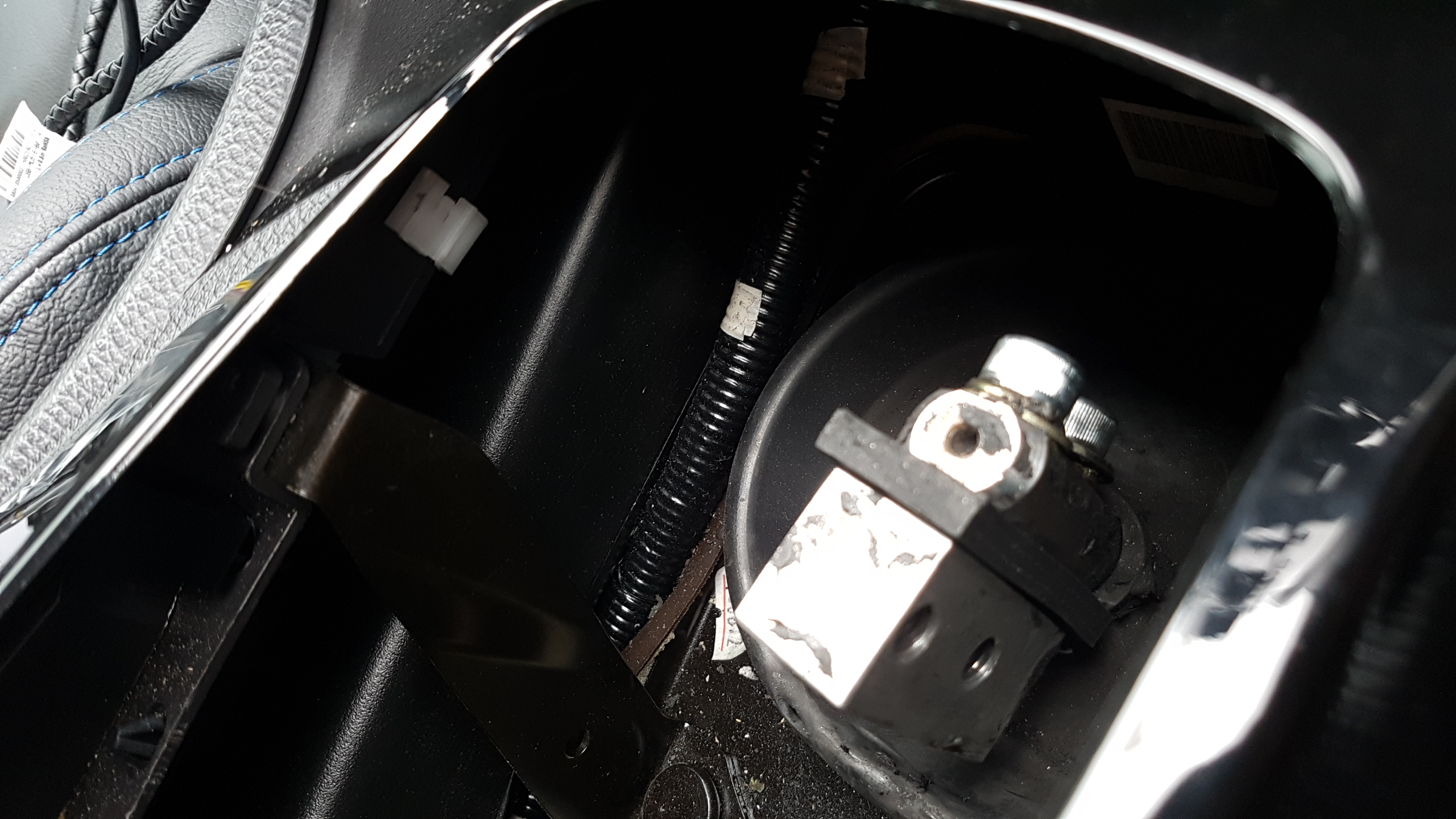

masda74 To Loud Gold Donating Members 4,112 Member For: 13y 2m 6d Gender: Male Location: WA, Perth Posted 01/03/17 01:15 PM Author Share Posted 01/03/17 01:15 PM ^^^^ didn't see you post until now. Please keep in mind that the leather on mine looks a bit worn out. Also the clear plastic/rubber protector on top has come off too. In any case some pics for all. This is what I got in the post today. no it did not come in the packet in the back ground. I needed something white and I had that. Notice the size/thickness of the above lever? compare it to the stock one.... See the space provided in the kit. keeps the gear lever in almost the same position as the OEM lever. Different Angle to see the spacer. Yet another angle but closer. almost there.... installed I will say this, it feels a lot lighter than the OEM lever, which leads to you feeling all the feedback from the gearbox/shortshifter??? I am not exactly liking the feel, but I am sure that I will get used to it. I might have to find some rubber grommits to put in between the lever and spacer and then between the spacer and lever from shortshifter. Thoughts guys, what did you do to your install Aaron? 4 Link to comment Share on other sites More sharing options...
arronm Dropping a turd Gold Donating Members 9,520 Member For: 17y 3m 10d Gender: Male Location: Perth Posted 01/03/17 02:21 PM Share Posted 01/03/17 02:21 PM Nothing, between my 4 inch exhaust and fuel pump I hear nothing. Rubber mount it and it will feel sloppy like the stock one. Mine is mounted solid. Link to comment Share on other sites More sharing options...
masda74 To Loud Gold Donating Members 4,112 Member For: 13y 2m 6d Gender: Male Location: WA, Perth Posted 03/03/17 11:26 AM Author Share Posted 03/03/17 11:26 AM Bit of an update, so I have noticed a lot of feedback from the gearbox. A lot of unfamiliar noises that I never heard before. I couldn't understand at first why I never had this noise with the OEM lever. I then noticed that in the base of the OEM lever that they have rubber between the lever and the base support. I am going to have to find a way around this soon as it is making me feel like the gear box is falling apart, even though I know it is not. Link to comment Share on other sites More sharing options...

sixman Donating Members 600 Member For: 20y 6m 14d Gender: Male Location: Hills District, NSW Posted 04/03/17 06:20 AM Share Posted 04/03/17 06:20 AM 18 hours ago, masda74 said: Bit of an update, so I have noticed a lot of feedback from the gearbox. A lot of unfamiliar noises that I never heard before. I couldn't understand at first why I never had this noise with the OEM lever. I then noticed that in the base of the OEM lever that they have rubber between the lever and the base support. I am going to have to find a way around this soon as it is making me feel like the gear box is falling apart, even though I know it is not. Clark rubber. $2 for 50cm. No noise, quiter than stock 1 Link to comment Share on other sites More sharing options...
masda74 To Loud Gold Donating Members 4,112 Member For: 13y 2m 6d Gender: Male Location: WA, Perth Posted 04/03/17 07:06 AM Author Share Posted 04/03/17 07:06 AM Thanks for the idea. Well I originally bought the strap wrench to get the oem gear lever knob off. this happened.... So I have decided to cut off a couple of possible insulation strips to put on the lever and see how I go. Link to comment Share on other sites More sharing options...
