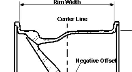

OZYWALKER XR50T Gold Donating Members 2,795 Member For: 12y 1m 6d Gender: Male Location: Western Sydney Posted 19/10/16 01:55 AM Share Posted 19/10/16 01:55 AM Probably tripping because when you measure a 10" rim it's actually 11" wide edge to edge, your probably not taking the bead seat into account which is roughly 1/2" either side. 2 Link to comment https://www.fordxr6turbo.com/forum/topic/92567-simmons-fr-c-cconcave/page/3/#findComment-1617329 Share on other sites More sharing options...
arronm Dropping a turd Gold Donating Members 9,520 Member For: 17y 7m 11d Gender: Male Location: Perth Posted 19/10/16 04:27 AM Share Posted 19/10/16 04:27 AM (edited) Rims are measured this way. And the tyre you have on the rim fits fine. They make 20 x 8.5 and 20 x 10 in that rim . SSSSoooooooooooo 11??????? Edited 19/10/16 04:33 AM by arronm 1 Link to comment https://www.fordxr6turbo.com/forum/topic/92567-simmons-fr-c-cconcave/page/3/#findComment-1617353 Share on other sites More sharing options...
Tocchi Sandtrap Motorsport Donating Members 2,055 Member For: 16y 6m 13d Gender: Male Location: Perth Posted 19/10/16 04:28 AM Share Posted 19/10/16 04:28 AM Add 1" to the nominated bead width = Simmons total width lip to lip Edit. Above says it Link to comment https://www.fordxr6turbo.com/forum/topic/92567-simmons-fr-c-cconcave/page/3/#findComment-1617355 Share on other sites More sharing options...
