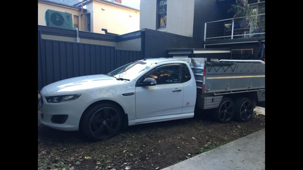

User55555 Member 19 Member For: 12y 8m 4d Posted 07/10/16 12:37 AM Share Posted 07/10/16 12:37 AM I did our two fg 08 work Utes with the fgx xr8 front was about $3k for all panels and brackets from ford and $800 for paint fitted it all in about two hours the Xr headlights have to be re wired for the led driving lights but was easy to figure it out. I have to say I preferred the fg f6 front design but after looking at it for 8 years the fgx just looked abit fresher and I was bored. Plus I priced the change over cost with all the engine work I already had I just could not justify dropping $40k for a new front end. 4 Link to comment https://www.fordxr6turbo.com/forum/topic/92520-fg-to-fgx-front-conversation/#findComment-1615499 Share on other sites More sharing options...
User55555 Member 19 Member For: 12y 8m 4d Posted 07/10/16 12:41 AM Share Posted 07/10/16 12:41 AM 8 Link to comment https://www.fordxr6turbo.com/forum/topic/92520-fg-to-fgx-front-conversation/#findComment-1615500 Share on other sites More sharing options...
User55555 Member 19 Member For: 12y 8m 4d Posted 07/10/16 12:43 AM Share Posted 07/10/16 12:43 AM Made new racks, steel canopy doors and had the wheels painted while I was at it. 1 Link to comment https://www.fordxr6turbo.com/forum/topic/92520-fg-to-fgx-front-conversation/#findComment-1615501 Share on other sites More sharing options...
