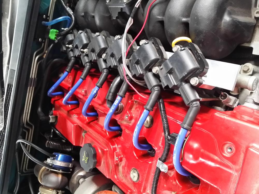

mr_greenslade Member 5 Member For: 17y 4m 8d Posted 19/09/16 02:02 PM Share Posted 19/09/16 02:02 PM Hi guys, Is it at all possible to run LS1 coils (Obviously with custom plug leads and mounts etc) on an xr6 turbo using a factory pcm? Regards Scott Link to comment https://www.fordxr6turbo.com/forum/topic/92466-ls1-coils-on-ba/ Share on other sites More sharing options...

mr_greenslade Member 5 Member For: 17y 4m 8d Posted 19/09/16 02:08 PM Author Share Posted 19/09/16 02:08 PM I had installed an adaptronic ecu piggybacked into the car running the ls1 coils but am reverting back to factory pcm to sell and was hoping to leave the ls1 coils on it... Link to comment https://www.fordxr6turbo.com/forum/topic/92466-ls1-coils-on-ba/#findComment-1612782 Share on other sites More sharing options...

Ralph Wiggum Moar Powar Babeh Lifetime Members 19,332 Member For: 19y 8m 17d Gender: Male Location: Perth Posted 19/09/16 02:39 PM Share Posted 19/09/16 02:39 PM On 19/09/2016 at 2:08 PM, mr_greenslade said: I had installed an adaptronic ecu piggybacked into the car running the ls1 coils but am reverting back to factory pcm to sell and was hoping to leave the ls1 coils on it... Expand If they are dumb coils (ie no internal ignitors) it will be fine. Also, pics of setup? Link to comment https://www.fordxr6turbo.com/forum/topic/92466-ls1-coils-on-ba/#findComment-1612784 Share on other sites More sharing options...
mr_greenslade Member 5 Member For: 17y 4m 8d Posted 19/09/16 10:03 PM Author Share Posted 19/09/16 10:03 PM They are not dumb coils that's why I'm asking if they will work. I still have standard coils but I've removed the wiring so I'd have to make a new harness patch with connectors Link to comment https://www.fordxr6turbo.com/forum/topic/92466-ls1-coils-on-ba/#findComment-1612789 Share on other sites More sharing options...
mr_greenslade Member 5 Member For: 17y 4m 8d Posted 19/09/16 10:07 PM Author Share Posted 19/09/16 10:07 PM Link to comment https://www.fordxr6turbo.com/forum/topic/92466-ls1-coils-on-ba/#findComment-1612790 Share on other sites More sharing options...
Ralph Wiggum Moar Powar Babeh Lifetime Members 19,332 Member For: 19y 8m 17d Gender: Male Location: Perth Posted 19/09/16 10:50 PM Share Posted 19/09/16 10:50 PM You'll have to revert back to stock style coils. Thanks for the pic btw. Ive been comtemplating something similar. Link to comment https://www.fordxr6turbo.com/forum/topic/92466-ls1-coils-on-ba/#findComment-1612796 Share on other sites More sharing options...
