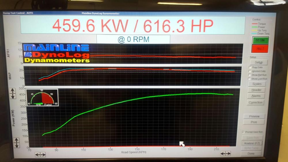

sprouly07 Donating Members 62 Member For: 10y 6m 28d Gender: Male Location: Townsville Posted 12/08/16 05:55 AM Share Posted 12/08/16 05:55 AM So a couple months ago the turbo on my f6 failed so it needed to be replaced. I had been talking to Dave from CPV Tuning for a couple months about upgrading the turbo and when the stock turbo failed it kind of forced my hand and the turbo was upgraded. Hadn't planned on doing it this early but couldn't see the point in replacing the stock turbo and then getting a new one again in 6 months time. So a custom turbo from monsta torque was ordered and installed to go along with existing mods like manta exhaust, twin 460 surge tank, intanke 460, PW stage 3 cooler, valve springs, 1000cc injectors and stall converter. The daily tune ended up doing 459.6kw and the drag tune ended up going 493.4kw, both were on e85 Most impressive thing about the car is that it still retains the standard airbox and intake so there is no doubt in my mind that if a turbo side intake was installed than the car would make over 500rwkw but that's not what I was chasing with this car. I wanted to keep a relatively standard looking engine bay seeing as though it is still my daily so to the untrained eye it would still look standard and I wouldnt get much attention. I also wanted to see if it was possible to run a 9 on the standard intake so will hopefully get a chance to go down the strip soon and see what time it does. 8 Link to comment Share on other sites More sharing options...
