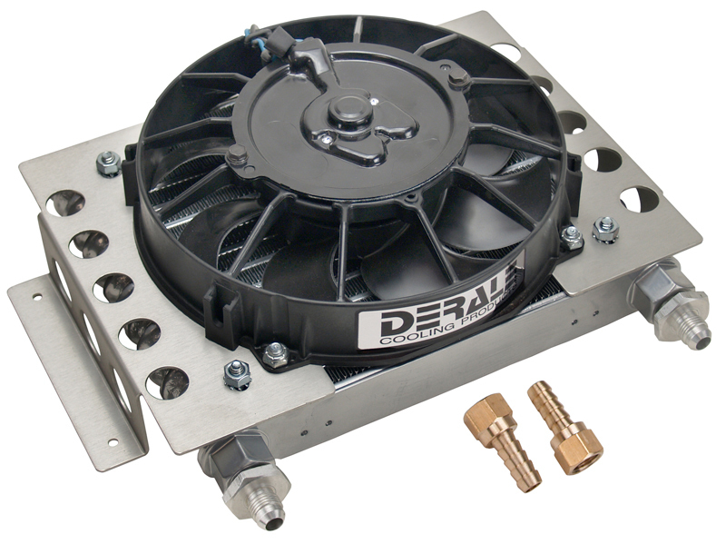

arronm Dropping a turd Gold Donating Members 9,520 Member For: 17y 6m 7d Gender: Male Location: Perth Posted 10/08/16 10:44 AM Share Posted 10/08/16 10:44 AM (edited) custom brackets Put something like this is front of the intercooler, paint all black. Edited 10/08/16 10:49 AM by arronm Link to comment https://www.fordxr6turbo.com/forum/topic/92294-best-location-for-an-external-transmission-cooler-fg-xr6t/page/2/#findComment-1606891 Share on other sites More sharing options...
ROB83R Member 1,632 Member For: 8y 11m 14d Gender: Not Telling Location: Radioactive wasteland Posted 10/08/16 01:41 PM Share Posted 10/08/16 01:41 PM If doing track days or towing regularly I would stick it in front but I don't think the zf would like the fluid that cool. Link to comment https://www.fordxr6turbo.com/forum/topic/92294-best-location-for-an-external-transmission-cooler-fg-xr6t/page/2/#findComment-1606912 Share on other sites More sharing options...
arronm Dropping a turd Gold Donating Members 9,520 Member For: 17y 6m 7d Gender: Male Location: Perth Posted 10/08/16 03:10 PM Share Posted 10/08/16 03:10 PM Or stick a fan on it. 1 Link to comment https://www.fordxr6turbo.com/forum/topic/92294-best-location-for-an-external-transmission-cooler-fg-xr6t/page/2/#findComment-1606919 Share on other sites More sharing options...
