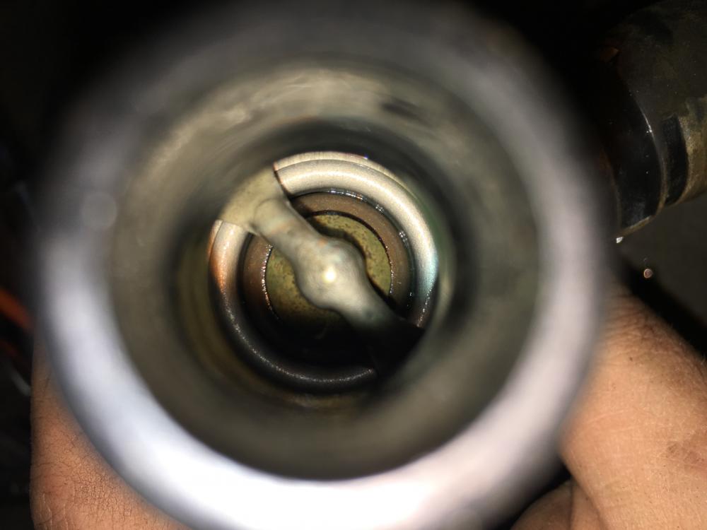

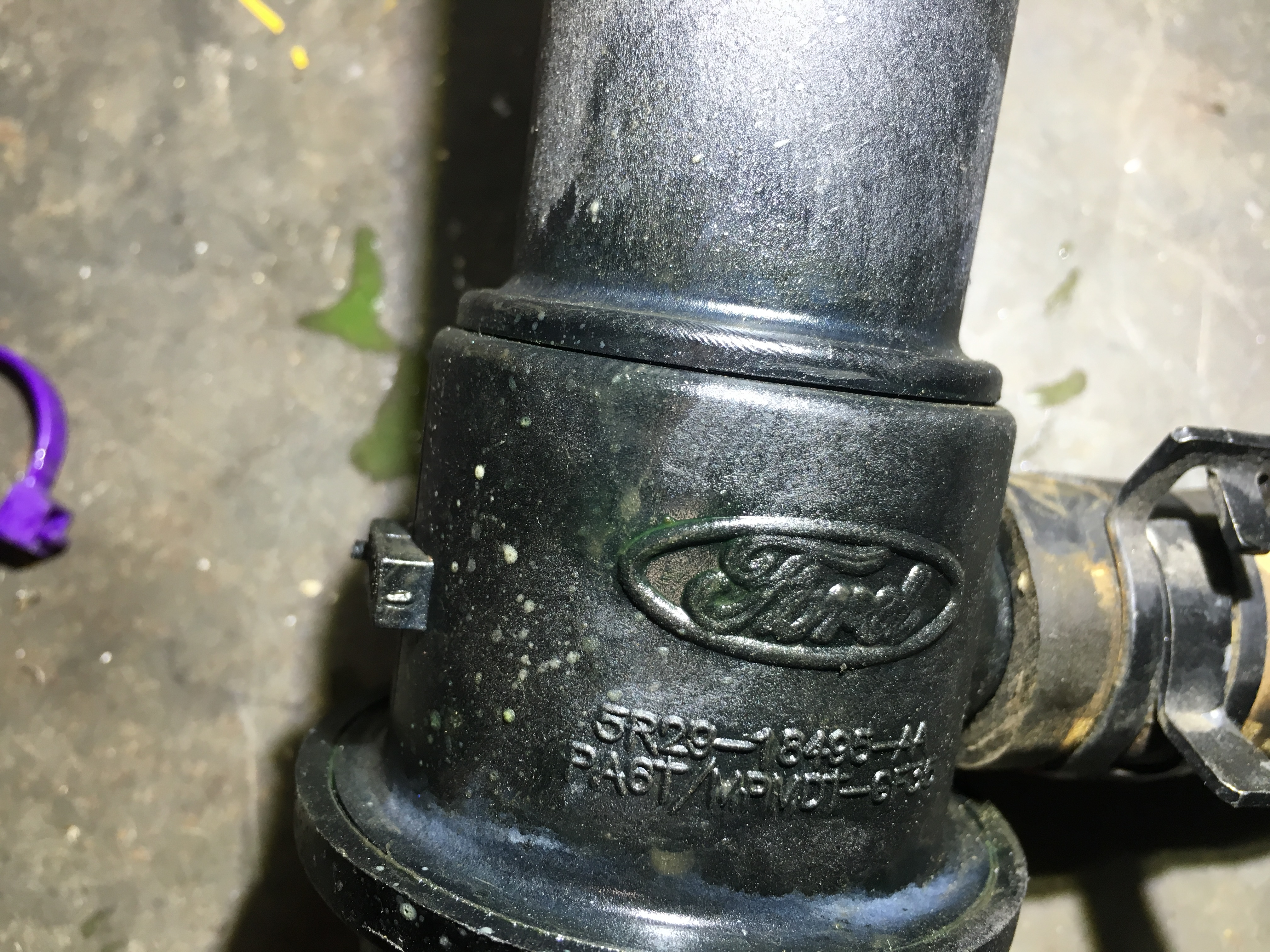

Ralph Wiggum Moar Powar Babeh Lifetime Members 19,331 Member For: 19y 7m Gender: Male Location: Perth Posted 06/05/16 01:41 PM Share Posted 06/05/16 01:41 PM On 06/05/2016 at 1:09 PM, FiftyOne said: So I grabbed a drill and an old set of injectors tonight, bored them out, installed them and it didn't fix my issue. So I went a bit deeper. Below are the tell tail signs of some sort of cooling system failure. Before even opening the system there was an unhealthy green sheen under everything rearward of my issue Looking around I expected it to be a clamp on one of the lines to the trans cooler I had replaced over a year ago. Unfortunately not the case. I had trouble getting an image but I could see the highest point of the leak was around the black case of the heater tap So I had to remove it all and its probably an easier job to drop the K frame than reach in with everything in position. But I wasn't doing that so I suffered. The biggest issue is the bunny ear clips. they are in the most tucked away places & also with the ears facing the wrong way! There was just physically no way I could get at them. The gearbox side is simple enough with the steel quick clips just needing to be removed to pop them off. Funny as before I saw exactly how it was I thought they might be the bigger issue. One hose with a worm drive; Quick couple off; The other pipes I simply couldn't get at so the line from under the head thermostat I cut in half, and the one directly under the intake runners I smashed with a screwdriver Hose down in here, soooommmmmeewhere; Ok so the offending part in question is a Not only is there evidence where I bludgeoned it to death with a screw driver, you can see below the joins from where this was bound to fail; And as you can see inside, looks just like any other thermostat you'd see around a workshop. More to come on that later So first plan was to see if it could be patched with glue, a plan I wasn't a fan of for a few reasons. That's now not an option. Go and see if there is a "for like" replacement that I can McGyvor in with some barbs at repco/bursons. Ford kit/Ralph hack and get it together so I can just drive it again. From what was a simple oil change, a few other minor issues have now made this a headache. The thing that sh*ts me most about this is that someone at Ford made the case they NEEDED this part. They couldn't buy a motorcraft or triton generic one to use from factory. They spent a heap of money on tooling to make this ford part, in three pieces of plastic, which was now even more prone to fail, and they have all failed on the road which has led them to be discontinued. Expand My googling at the time suggested it was a Ford US part used in the heater circuit of some Ford trucks . Link to comment https://www.fordxr6turbo.com/forum/topic/91935-failed-transmission-thermostat/page/2/#findComment-1589140 Share on other sites More sharing options...
