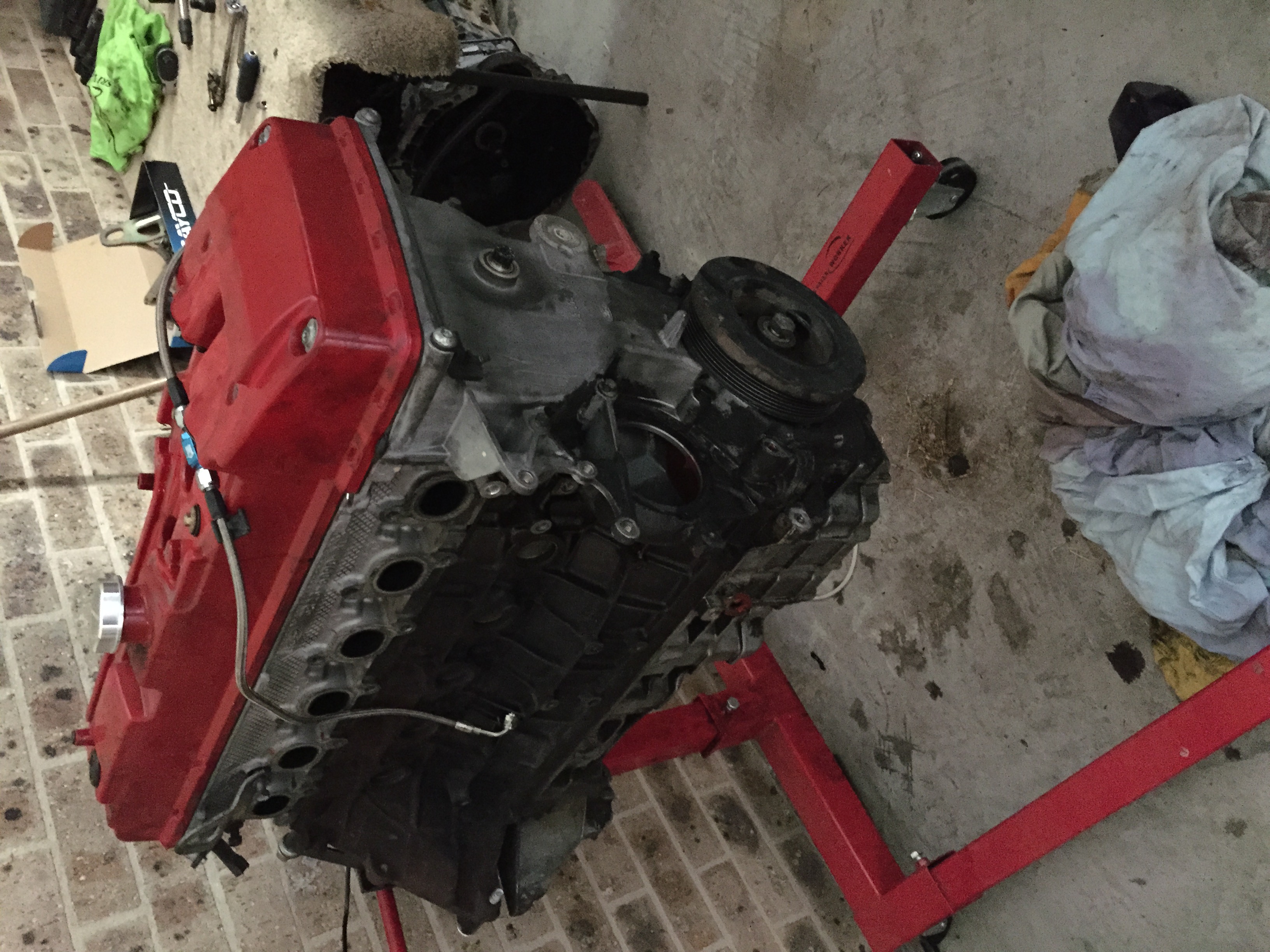

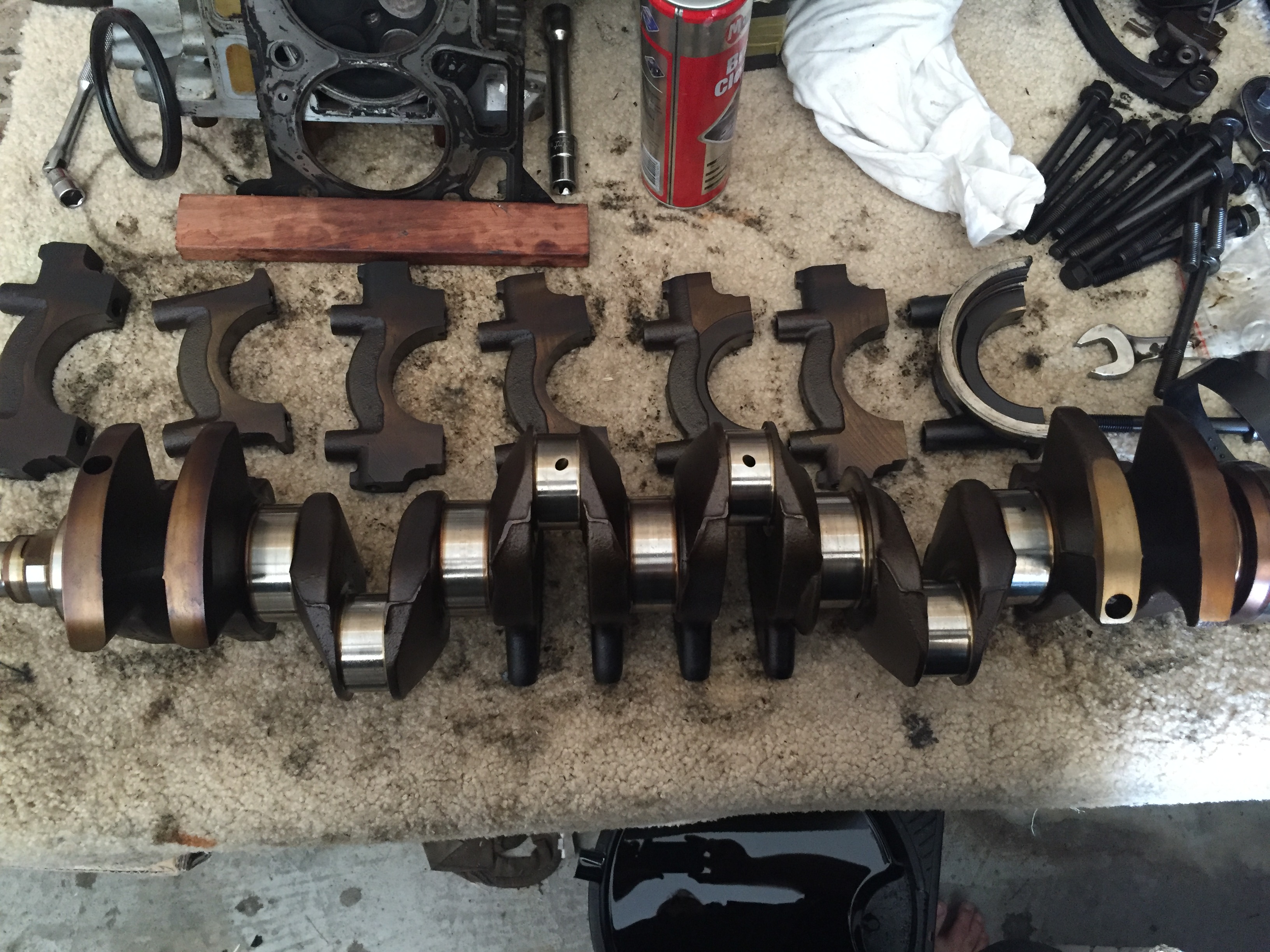

unmarkedf6 Member 50 Member For: 12y 2m 13d Gender: Female Location: The locker room, toweling down Posted 10/02/16 10:38 AM Share Posted 10/02/16 10:38 AM Hey guys thought I'd share my bf xr6 turbo manual ute. Was previously making 378kw till the fuzz defected me. Was running 80lb injectors, in tank herrod 265lph fuel pump, aps intercooler, x force full exhaust and high flowed( 64mm gtx wheel )standard turbo. And a heavy duty clutch that barely held up with the hell I put it through! so I lost interest in just repairing it. Now I've pulled the engine out and am currently rebuilding it! I went with spool rods, Ross forged Pistons, crank girdle, main studs atomic timing chain tensioner and chain and aftermarket oil pump so far. I'm still sussing a few things out with the top end besides valve springs obviously driveline will be another issue but I'll deal with that when I get there hahaha goal with the engine is to have a powerful, yet still drive able daily driver, (ideally 480+kW) being a manual limits my choice of turbo and drivability. I'll figure that out later here's some pics let me know what you think! also included parts of my timing guides which fell apart and (I think) caused a rattle on cold start up! 1 Link to comment https://www.fordxr6turbo.com/forum/topic/91706-my-bf-xr6-turbo-ute-build/ Share on other sites More sharing options...
