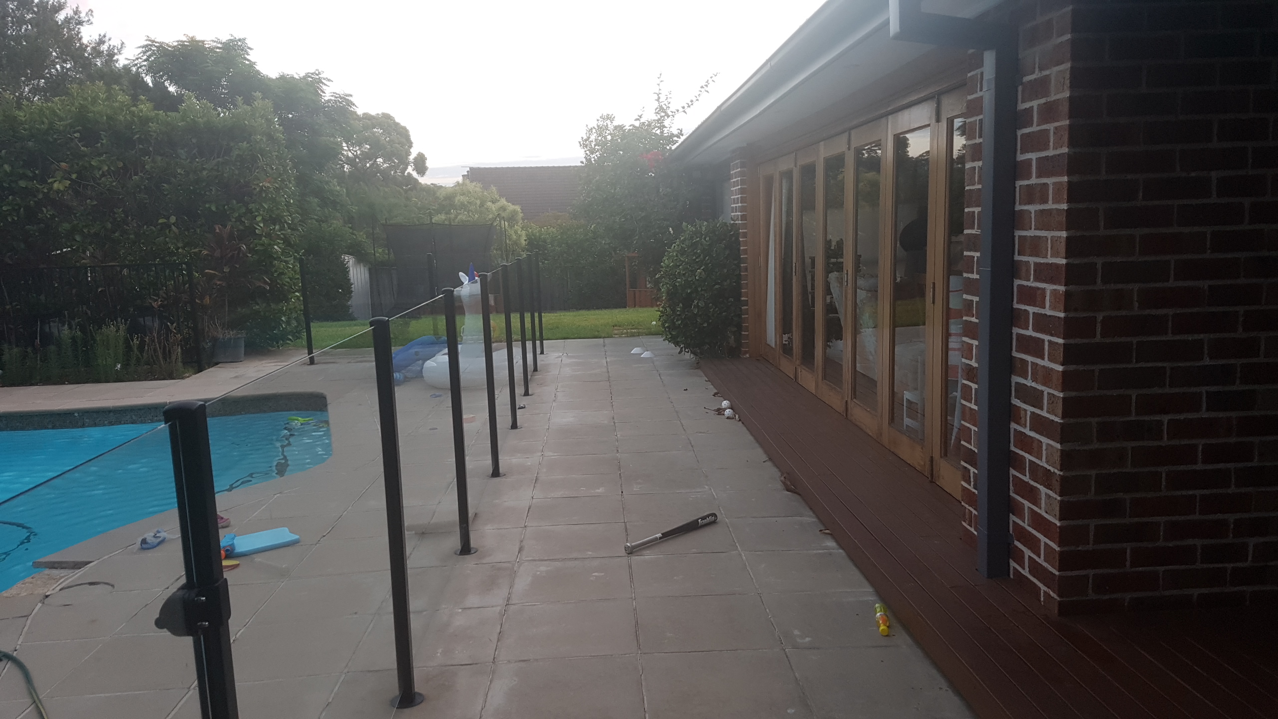

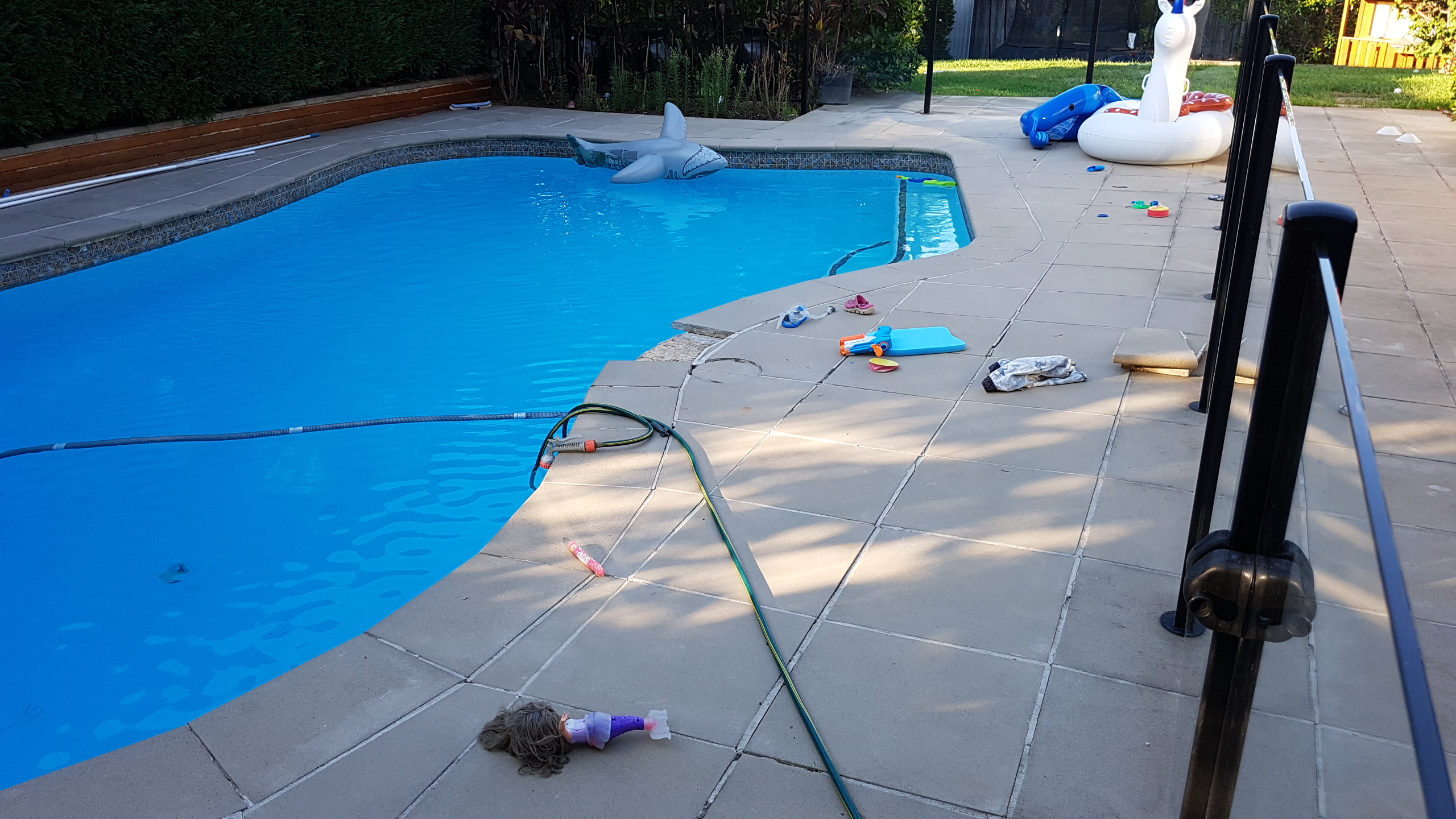

sixman Donating Members 601 Member For: 20y 6m 23d Gender: Male Location: Hills District, NSW Posted 16/02/17 01:00 AM Share Posted 16/02/17 01:00 AM This is interesting. I need to redo my pool surround. The sandstone pavers were there when we bought the place. The foundation is about 20cm of compacted sand and the pavers keep moving. Trying to work out the best way of settling the area. Link to comment Share on other sites More sharing options...
rednose RNS10S Donating Members 2,229 Member For: 18y 5m 28d Gender: Male Posted 16/02/17 07:26 AM Share Posted 16/02/17 07:26 AM (edited) Only way to do it properly is: Option 1: Fence out, pavers off. Concrete slab dowelled into pool and then pavers straight on top of new slab. Option 2: Fence out, pavers off. Buy a good quality mod wood and deck it the same height as the coping paver. Option 3: Fence out, pavers off. Concrete slab dowelled into pool, same height as the coping paver, diamond cut in squares or diamonds and spray-crete it like this Edited 16/02/17 07:27 AM by rednose Link to comment Share on other sites More sharing options...
Pixy Angel Expert Donating Members 9,132 Member For: 19y 11m 18d Gender: Male Location: North Jamberoo, NSW Posted 16/02/17 07:57 PM Author Share Posted 16/02/17 07:57 PM ^^ This guy knows Take you time and do your home work, search search search. Work out cost per m2 for what you want done. I think the travertine is best. It's not harsh on your feet, looks great and easy to maintain. Astro Tur? Some of that stuff these days look real. Link to comment Share on other sites More sharing options...
sixman Donating Members 601 Member For: 20y 6m 23d Gender: Male Location: Hills District, NSW Posted 16/02/17 08:25 PM Share Posted 16/02/17 08:25 PM Thanks guys, great advice. This is the side facing the house. I put the folding doors and the deck in about 4-5 years ago. Putting in a level deck with the coping pavers will probably be the cheapest option and might suit the back of the house. Although the more I look up diamond cut concrete its hard to surpass. Link to comment Share on other sites More sharing options...
rednose RNS10S Donating Members 2,229 Member For: 18y 5m 28d Gender: Male Posted 17/02/17 12:27 AM Share Posted 17/02/17 12:27 AM Looking at it from that view I would be using a composite type decking (mod wood) Reasons being: -Large amount of concrete will be needed -Dowelling a slab that big may cause too much stress on the pool if there is movement underneath Also, Modwood is hollow which will be cooler on the feet (have you ever walked on hot timer decking?) Link to comment Share on other sites More sharing options...
