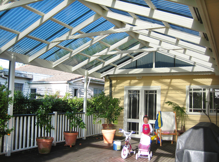

bossmang FREAKY Donating Members 12,440 Member For: 15y 6m 4d Gender: Male Location: Melbourne Posted 30/01/17 07:33 AM Share Posted 30/01/17 07:33 AM I dont get it go and google gable pergola and you will see plenty of them built the way it originally was. lel. for eg. Link to comment https://www.fordxr6turbo.com/forum/topic/91333-new-build-home-renovations-gardens-garages-sheds/page/143/#findComment-1630295 Share on other sites More sharing options...
.Stripes. All stock bar the k&n panel filter Silver Donating Members 8,061 Member For: 13y 3m 16d Gender: Male Location: Perth Posted 30/01/17 08:22 AM Share Posted 30/01/17 08:22 AM Yeah, dunno...but that's what the engineer said it needed, Trent. In the example you posted you'll notice there's actually considerably more cross-braces than on mine, so I'd say that plays into it perhaps? Link to comment https://www.fordxr6turbo.com/forum/topic/91333-new-build-home-renovations-gardens-garages-sheds/page/143/#findComment-1630301 Share on other sites More sharing options...
bossmang FREAKY Donating Members 12,440 Member For: 15y 6m 4d Gender: Male Location: Melbourne Posted 30/01/17 08:36 AM Share Posted 30/01/17 08:36 AM yer possibly that's just one I picked theres 100s more like it. I dunno im not an engineer either I used to install what they sent me haha (colourbond stuff) Link to comment https://www.fordxr6turbo.com/forum/topic/91333-new-build-home-renovations-gardens-garages-sheds/page/143/#findComment-1630309 Share on other sites More sharing options...
Wilko16 Donating Members 1,672 Member For: 17y 7m 8d Gender: Male Location: Melbourne Posted 30/01/17 08:46 AM Share Posted 30/01/17 08:46 AM Different pitch on the gable roofing material weight Timber size and hardwood or pine Lots of factors could come into play Good outcome for you stripes, when does the final contract come through to you? 1 Link to comment https://www.fordxr6turbo.com/forum/topic/91333-new-build-home-renovations-gardens-garages-sheds/page/143/#findComment-1630314 Share on other sites More sharing options...

El Andrew Gold Donating Members 2,040 Member For: 10y 2m 7d Gender: Male Location: Canberra ACT Posted 30/01/17 01:12 PM Share Posted 30/01/17 01:12 PM On 30/01/2017 at 8:22 AM, .Stripes. said: Yeah, dunno...but that's what the engineer said it needed, Trent. In the example you posted you'll notice there's actually considerably more cross-braces than on mine, so I'd say that plays into it perhaps?When I built mine, my design didn't pass first time because of this. I had planned for the horizontals (collar ties) to be quite high up. Apparently they need to be no higher than one third of the rafter rise, which looks to be exactly where your new ones are. 2 Link to comment https://www.fordxr6turbo.com/forum/topic/91333-new-build-home-renovations-gardens-garages-sheds/page/143/#findComment-1630347 Share on other sites More sharing options...
