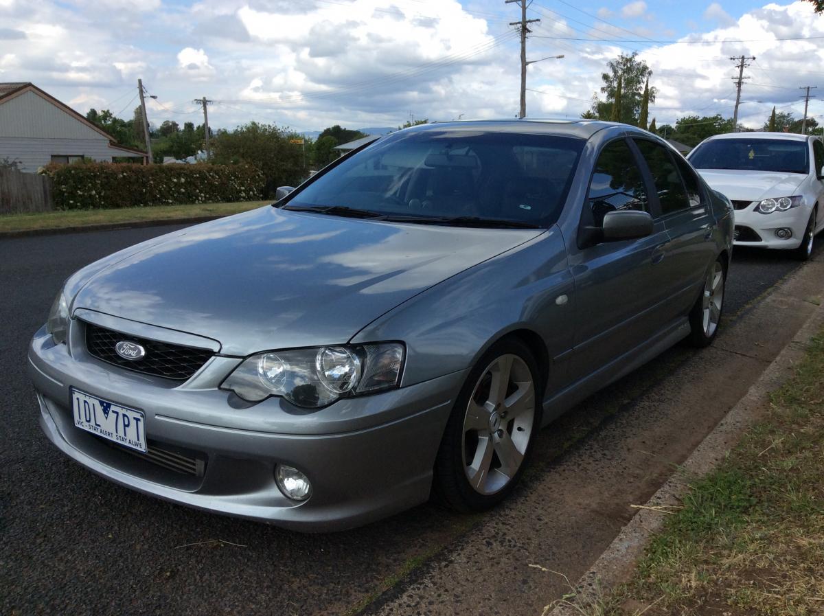

frozenxr6t Member 140 Member For: 10y 8m 5d Posted 24/10/15 02:13 AM Author Share Posted 24/10/15 02:13 AM Couple photos of the car. Currently got some gaskets to replace and then go in for leak down test. What's average price for a leak down test Link to comment https://www.fordxr6turbo.com/forum/topic/91263-ba-xr6t-2004-mk11/page/2/#findComment-1566360 Share on other sites More sharing options...
