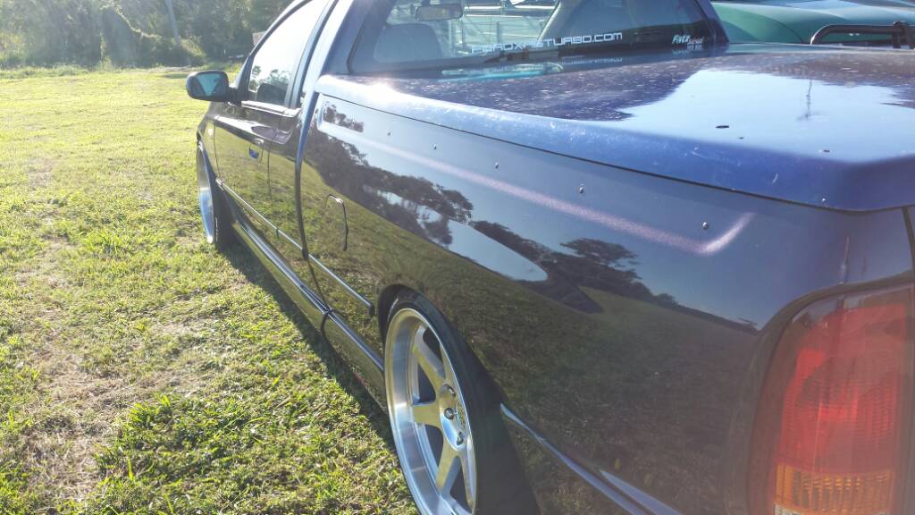

bamk2f6tornado Bronze Donating Members 777 Member For: 11y 6m 10d Gender: Male Location: Rockhampton Qld Posted 08/07/15 10:47 AM Share Posted 08/07/15 10:47 AM Iv got 10.5"+22 on the rear of my ute with 275's. If my quick maths is correct yours will sit in 10mm further than mine. From memory I have bucket loads of room on the inside so you should be sweet. Outside not so much 1 Link to comment https://www.fordxr6turbo.com/forum/topic/90811-babf-rear-ute-clearance/#findComment-1552563 Share on other sites More sharing options...
bamk2f6tornado Bronze Donating Members 777 Member For: 11y 6m 10d Gender: Male Location: Rockhampton Qld Posted 08/07/15 10:49 AM Share Posted 08/07/15 10:49 AM Your fronts are going to be pretty close the the suspension though. I have 9.5"+22 with 235's fronts and have about 6mm clearance. So you will have about 4ish. Will be sweet but won't be able to run wide tyres 1 Link to comment https://www.fordxr6turbo.com/forum/topic/90811-babf-rear-ute-clearance/#findComment-1552566 Share on other sites More sharing options...
