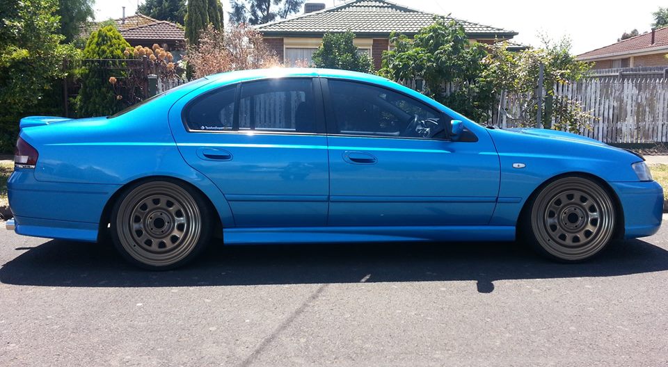

GUN-808 Member 251 Member For: 11y 5m 14d Gender: Male Location: Gold Coast Posted 03/07/15 08:15 AM Author Share Posted 03/07/15 08:15 AM yeah iv been searching for a few weeks now on sites.. +35 is the best iv seen 2nd hand..im trying to keep it simple and cheap and am not going near the $400+ea prices like some of those ya mentioned..Rota, Lenso, etc no go but as said the Drift Teks are the best option yet..Got 1 call back from a guy today late who will make custom jobs in SA and they are $480 for 2 , painted matched as good as possible, posted etc..They make them for FGs all the time.. Hes just checking on the availability of the 5 spoke centres but my other option is a D shaped Chaser.. They are all the same money and I can choose offset..Im sure he would have mentioned if they wouldnt fit BUT I will check and be 100% b4 I buy them..Thanx for the heads up though buddy , I wouldnt have thought of those bolts as im only going off measurements and offsets of my 18s and 20s and didnt think about the lack of clearance going smaller :/ It looks like the ball joint, bush thing bolt is the one that will trouble me the most after a quick look..Heres a pik of the D shaped ones that ill get if he cant get me the others..And they will see a bit of street here and there and running a drag radial that wont be 100% legal I dont want to attract any more unwanted attention so want it matched as close as possible I hate the look of cars with mismatched rims as it looks like they just are out doing burnouts hahaha Link to comment https://www.fordxr6turbo.com/forum/topic/90786-17-rims-for-drag-not-babf/#findComment-1551594 Share on other sites More sharing options...
