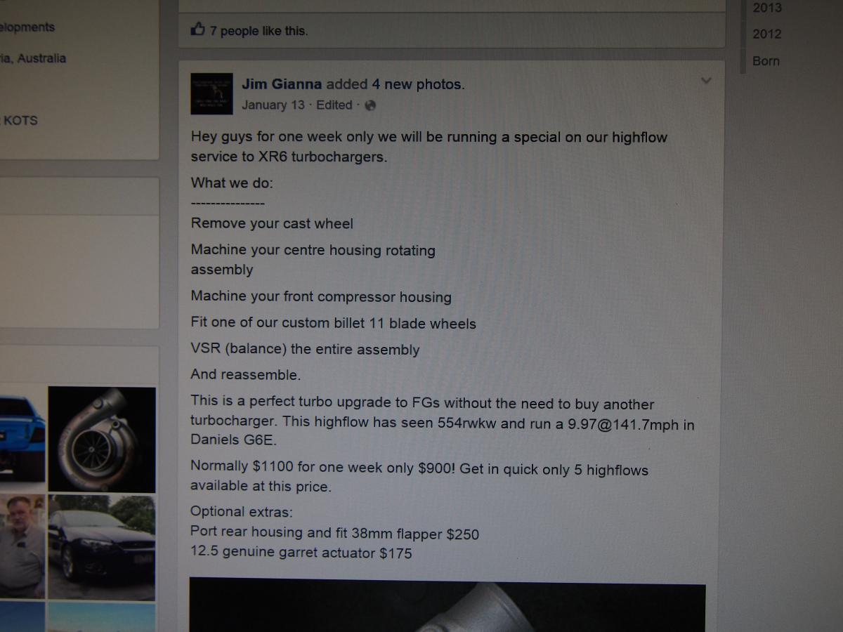

genuine honest person Member 2,769 Member For: 11y 2m 28d Gender: Male Location: near brisbane Posted 17/03/15 09:58 AM Author Share Posted 17/03/15 09:58 AM yes I will have different tunes for the road and the track . say 330 rwkw for the road and what ever it will end up with on the track . sorry but I can not remember what clutch material they said that they would use ,just that they have plates that would suit right up to 1500 hp . its not a daily driver ,just a weekend toy (it has always been that way )ratter the small turbo gets modified to fit a custom made gtx style wheel (he machines the housing to suit his own designed wheel ) he has one of his stage 3 turbos producing 550 rwkw ) the stage 2 (which I will use )has about 450 plus rwkw on E85 . but it spools up faster ,so it will suit my 6 speed manual better (that is what I am hopping for )there is a video on full boost (another super quick ford G6E a wolf in sheep's clothing ) it runs a high 9 second pass . that is the turbo from JIM GIANNA from xr6 turbo developmentsstripes at the drags with semi slicks it did not even spin the tyres on take off or when it hit boost . I am going also for some calttrax ? tramp rod things to stop axle tramp .lol I can not wait to start taking drift lessons ,might have to take it up just for a bit of fun . I will never be good at it ,but I will give it a go Link to comment https://www.fordxr6turbo.com/forum/topic/90247-am-i-gunna-get-there/page/2/#findComment-1535268 Share on other sites More sharing options...

genuine honest person Member 2,769 Member For: 11y 2m 28d Gender: Male Location: near brisbane Posted 17/03/15 10:17 AM Author Share Posted 17/03/15 10:17 AM there as some photos of the turbo conversion he does .also just want to add this .(traction or no traction ,I will have a BIG smile ear to ear . the only difference is I either sh*t or piss my pants or maybe even both . but I still will have a big smile ether way ) ps diapers are cheap and they even come in my size Link to comment https://www.fordxr6turbo.com/forum/topic/90247-am-i-gunna-get-there/page/2/#findComment-1535272 Share on other sites More sharing options...

ratter Member 6,793 Member For: 18y 10m 29d Gender: Male Location: @ my laptop Posted 17/03/15 10:27 AM Share Posted 17/03/15 10:27 AM I know what Jim does, but the "small turbo" is the "small turbo" because it has a small compressor wheel, putting a bigger compressor wheel would mean it is not the small turbo anymore.Are you are Caltracs for traction or to stop axle tramp? if for traction you need more than just the springs, if for tramp, there are cheaper options which would be more streetable. p.s. I still think his mums clutch is not operating correctly 3 Link to comment https://www.fordxr6turbo.com/forum/topic/90247-am-i-gunna-get-there/page/2/#findComment-1535274 Share on other sites More sharing options...
