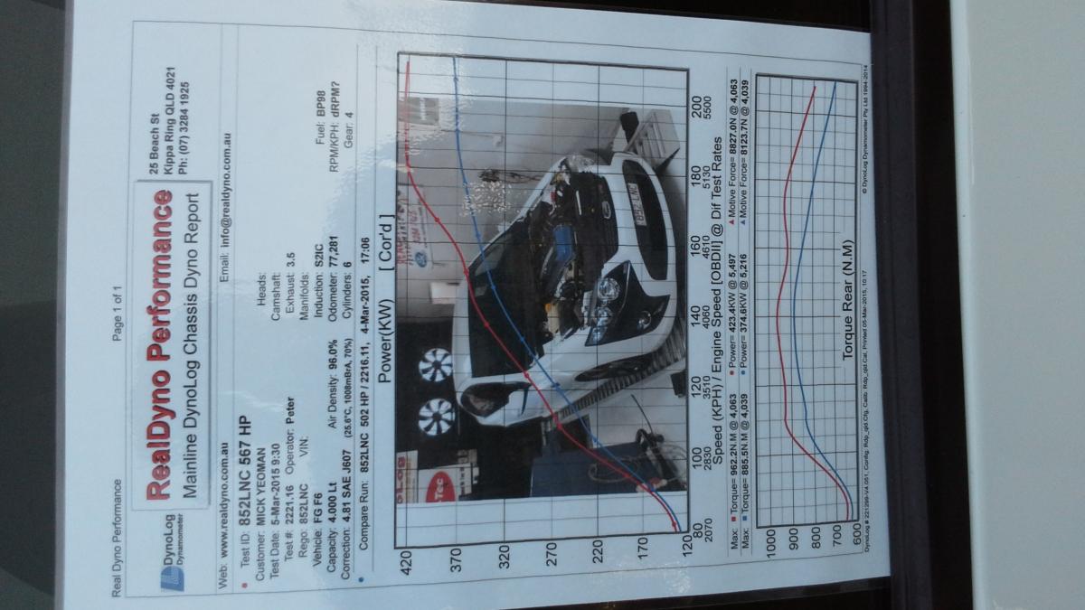

skippy228 New Member 17 Member For: 14y 1m 17d Gender: Male Location: Gladstone, QLD Posted 10/03/15 12:24 PM Share Posted 10/03/15 12:24 PM (edited) Finally modded my F6,, let the boys at real dyno in kippa ring loose on it,, managed 423rwkw on E85 @ 20 lbs of boost, while it was on the hoist I had xyz coilovers and superpro diff bushes fitted,, the blue line is on bp ultimate mods were,, pw batt relocationpw air box pw stage 2 cooolerinjectorsvalve springshead studsWalbro intank fuel pumpported exhaust housing flapper mod as it was making too much boost4 " dump high flow cat 3 1/2" mild systemzf service and cooler kitzf tune turbo oil line kit Edited 10/03/15 12:29 PM by skippy228 1 Link to comment https://www.fordxr6turbo.com/forum/topic/90220-rdp-tuned-fg-f6/ Share on other sites More sharing options...
pro346 Member 63 Member For: 13y 25d Posted 11/03/15 09:52 AM Share Posted 11/03/15 09:52 AM big dip at 4600rpm in e85 tune in power and torque... considering there dyno has smooth feature for power readings I wonder how bad it was before is was smoothed!! Link to comment https://www.fordxr6turbo.com/forum/topic/90220-rdp-tuned-fg-f6/#findComment-1534243 Share on other sites More sharing options...
skippy228 New Member 17 Member For: 14y 1m 17d Gender: Male Location: Gladstone, QLD Posted 11/03/15 11:31 AM Author Share Posted 11/03/15 11:31 AM Yeah beats me,, he said it doesn't usually do that on other similar setups and get little more torque than that,,, ,, but im happy itsma totally different car to drive now,,, cant just floor it as u could in stock trim,, gotta search for the traction 1 Link to comment https://www.fordxr6turbo.com/forum/topic/90220-rdp-tuned-fg-f6/#findComment-1534263 Share on other sites More sharing options...

matt036 Donating Members 280 Member For: 15y 3m 29d Gender: Male Posted 16/03/15 10:10 AM Share Posted 16/03/15 10:10 AM that's the real dyno dip in the power curve. A trademark of there tunes trying to control boost and failing. 4 Link to comment https://www.fordxr6turbo.com/forum/topic/90220-rdp-tuned-fg-f6/#findComment-1535059 Share on other sites More sharing options...
