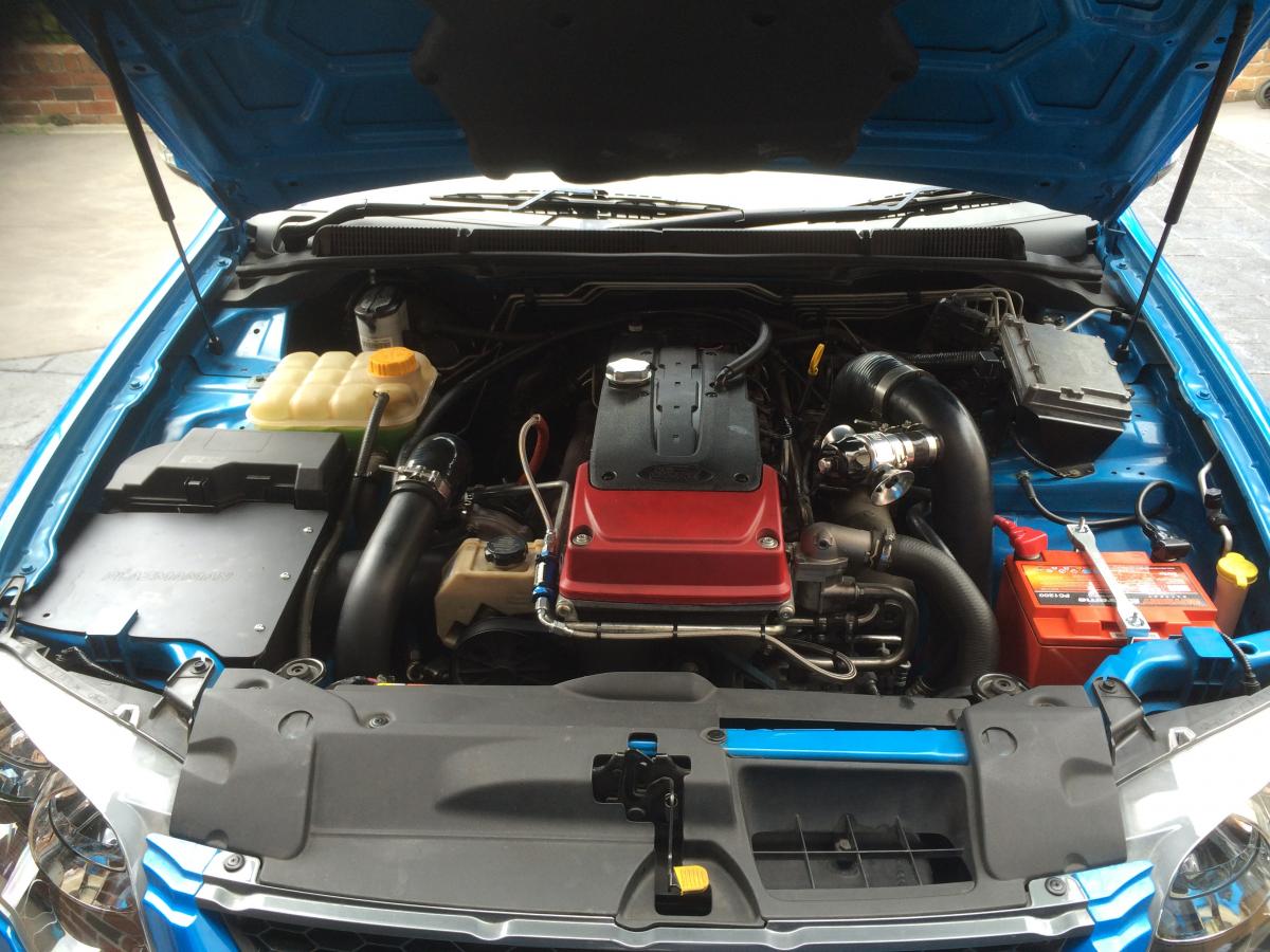

Andy777 Member 28 Member For: 13y 6d Posted 26/01/15 11:57 PM Share Posted 26/01/15 11:57 PM on Friday finally made it to the 300 clubwhat started with an el xr8 with some engine work, a drive home from work getting absolutely toasted by an fg xr6 turbo, making me jump ship from a v8 to a boosted 6with a growing family and the need for a bigger more reliable car and just after having my ass handed to me, I stumbled across this xr50 turbo, wifes car was already sorted with a kluger (now I have her into a new territory) and a promise to keep it stock.. famous last wordsfirst thing was throw in the 3 baby seats requiredcar already had pedders coilovers (which I hated)car had the wrong rims on it, had snow flakes instead of the 50th anniversary ones so straight away lined up a set of fpv twist in immac conditionthen the power bug started to hitk&n panelrapid cooler kitxforce 4" dump and cat still standard cat backid1000sflapper and actuatorand a tunewe encountered a small problem turbo was running out of puff and not holding 15psi once we hit over 4500rpm would drop to 10psistep 2 started, got turbo side and battery relocate and a mate had a f6 turbo sitting around, only problem was I was that busy I never got around to fitting it..the turbo gods were not happy with my laziness and just before Christmas they forced my hand by making my standard turbo cark iton my holidays ripped it off, the f6 turbo my mate gave me ended up being from a b series, fitted my rear housing and actuator spun the cover around, fitted up the relocate, turbo side and an earls line, also got rid of the coil overs from some shock and king springs so much comfier, the pedders coilovers just kept popping shocklast Friday it went to joe at cms, she made a nice 345 at 15psi, was a ripper hot day in Sydney as wellnow for the next step, get a 4" cat back, e85 set up and some valve springsleft the dyno sheet at cms, 3 Link to comment https://www.fordxr6turbo.com/forum/topic/89983-fg-xr6t-journey-to-345rwkw/ Share on other sites More sharing options...
BRK Member 361 Member For: 13y 4m 10d Gender: Male Location: Perth Posted 27/01/15 03:23 AM Share Posted 27/01/15 03:23 AM Well done. Yáll gotta be very happy with 345 at the tyres through stock mufflers - - - - I am beeting there is no drone, cabin roar, drumming harmonics at 95 - 100km/hr, pipes banging on the diff cradle or kids in the back seat with headaches. Good luck with the next steps. Link to comment https://www.fordxr6turbo.com/forum/topic/89983-fg-xr6t-journey-to-345rwkw/#findComment-1526082 Share on other sites More sharing options...
Andy777 Member 28 Member For: 13y 6d Posted 27/01/15 04:13 AM Author Share Posted 27/01/15 04:13 AM yea stoked it did so well with the stock cat back, you can drive it around like normal and no one will know it has any performance mods at all. Link to comment https://www.fordxr6turbo.com/forum/topic/89983-fg-xr6t-journey-to-345rwkw/#findComment-1526089 Share on other sites More sharing options...
Cjafpv Member 110 Member For: 10y 8m 27d Posted 27/01/15 08:00 AM Share Posted 27/01/15 08:00 AM Yea stock cat back really flow well on these fgs although sometimes the dead quietness gets abit boring for me gonna have to rip it off soon I think. Nonetheless great car mate enjoy. Link to comment https://www.fordxr6turbo.com/forum/topic/89983-fg-xr6t-journey-to-345rwkw/#findComment-1526126 Share on other sites More sharing options...
