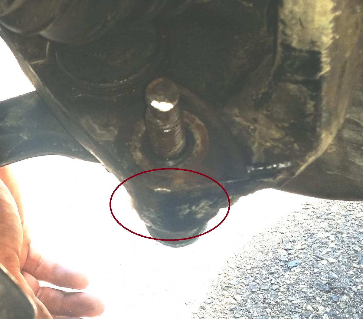

fastfwd Member 103 Member For: 13y 6m 6d Posted 30/12/14 06:36 AM Share Posted 30/12/14 06:36 AM Hi all,Other day at the servo in my territory ghia turbo the ball joint on the LCA just crapped itself and popped out. Tow truck driver said its common problem on these cars. I had trouble getting parts over xmas but I made it happen so I got all the parts and im working on it today and the ball joint that goes into the rear section of the hub is stuck.Does anyone know if this is threaded or just a shaft. The damn thing just wont come out.Pictures below of the new arm, old arm and ball joint stuck in the hub. Link to comment https://www.fordxr6turbo.com/forum/topic/89826-lower-control-arm-ball-joint-stuck/ Share on other sites More sharing options...
fastfwd Member 103 Member For: 13y 6m 6d Posted 30/12/14 09:38 AM Author Share Posted 30/12/14 09:38 AM (edited) Tried everything today...hammering the sh*t out of it. Tried to vice grip onto the ball end and twist it, the end of the tread has a 10mm socked end on it so I tried turning it. Nothing worked so I just ended up hammering the crap out of it but still no go. Unsure if I can get a 10mm onto it anymore cos ive bent the crap out of the end of the thread. I still dont thing it threads onto the hub, it makes no sense to do that I just think its stuck inside it some how.any idea's? Edited 30/12/14 09:39 AM by fastfwd Link to comment https://www.fordxr6turbo.com/forum/topic/89826-lower-control-arm-ball-joint-stuck/#findComment-1520027 Share on other sites More sharing options...
Ralph Wiggum Moar Powar Babeh Lifetime Members 19,332 Member For: 19y 8m 6d Gender: Male Location: Perth Posted 30/12/14 09:52 AM Share Posted 30/12/14 09:52 AM It's a tapered ball joint. You either need to heat the the upright to release the tape or get a ball joint splitter to press it out Link to comment https://www.fordxr6turbo.com/forum/topic/89826-lower-control-arm-ball-joint-stuck/#findComment-1520034 Share on other sites More sharing options...
fastfwd Member 103 Member For: 13y 6m 6d Posted 30/12/14 10:01 AM Author Share Posted 30/12/14 10:01 AM On 30/12/2014 at 9:52 AM, Ralph Wiggum said: It's a tapered ball joint. You either need to heat the the upright to release the tape or get a ball joint splitter to press it outthis one http://www.supercheapauto.com.au/online-store/products/Stanley-Ball-Joint-Separator-Mini.aspx?pid=105533#Recommendationsor this one?http://repcoequipment.businesscatalyst.com/repco/repco-ball-joint-separator Link to comment https://www.fordxr6turbo.com/forum/topic/89826-lower-control-arm-ball-joint-stuck/#findComment-1520036 Share on other sites More sharing options...
Ralph Wiggum Moar Powar Babeh Lifetime Members 19,332 Member For: 19y 8m 6d Gender: Male Location: Perth Posted 30/12/14 11:45 AM Share Posted 30/12/14 11:45 AM Repco unit. I still think you'll need to heat it thoughI would suggest this http://www.supercheapauto.com.au/online-store/products/Hot-Devil-Pro-Torch-Kit.aspx?pid=340613#Recommendationsand a bit f'n hammerAlso where are you striking it? Usually hitting the end of the ball stud will achieve SFA, you need to be striking In the area I have marked on your pic. Link to comment https://www.fordxr6turbo.com/forum/topic/89826-lower-control-arm-ball-joint-stuck/#findComment-1520084 Share on other sites More sharing options...
