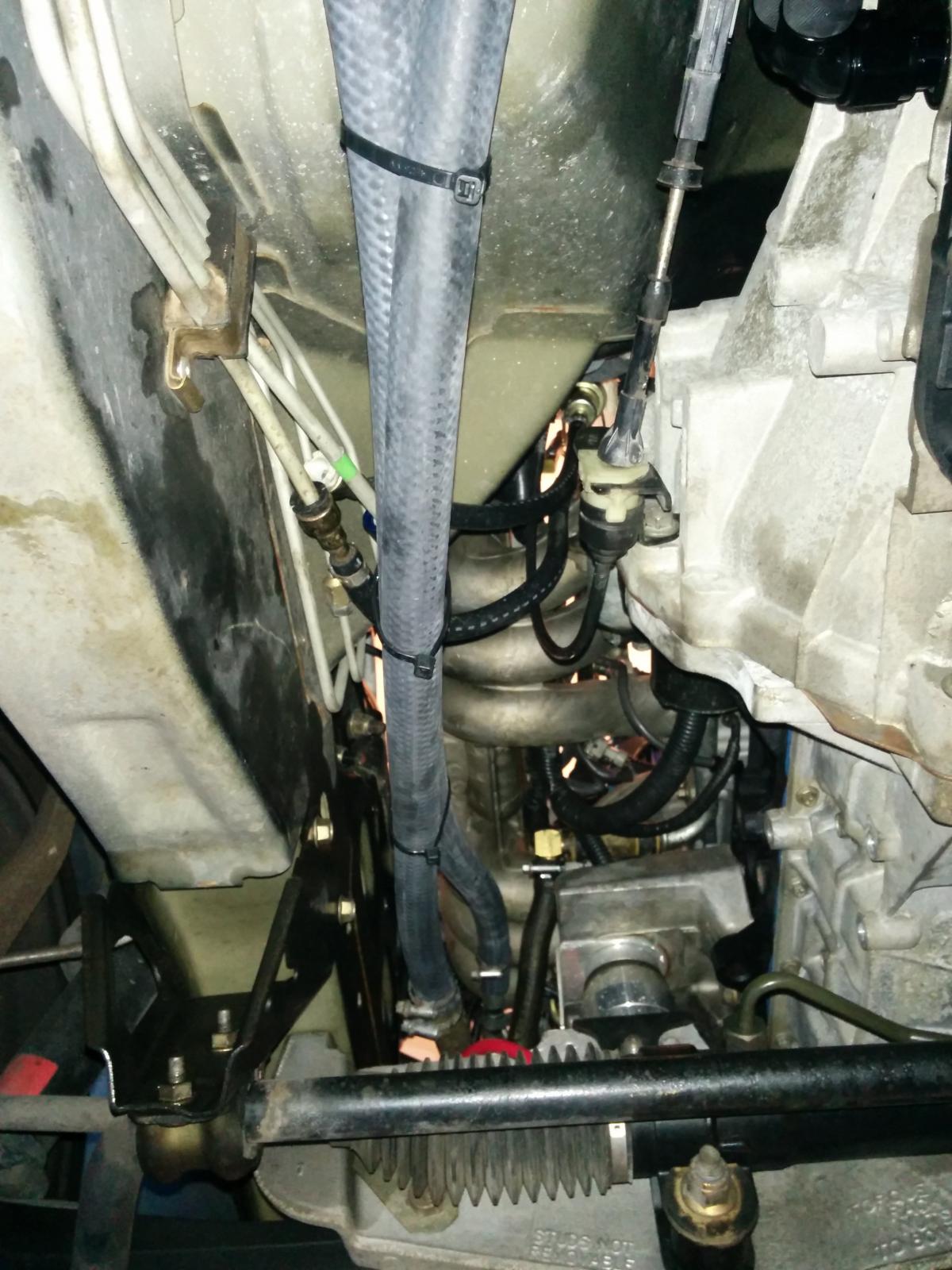

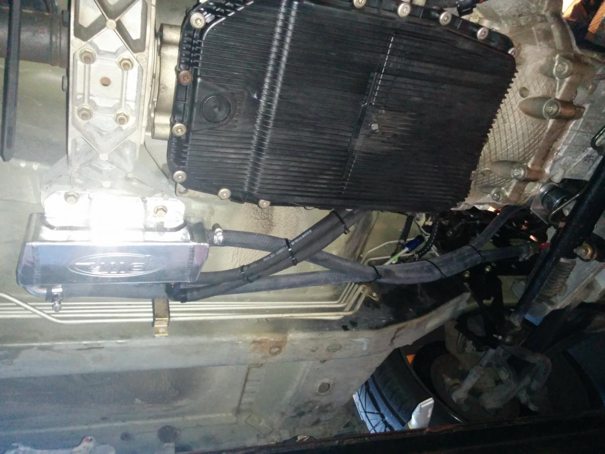

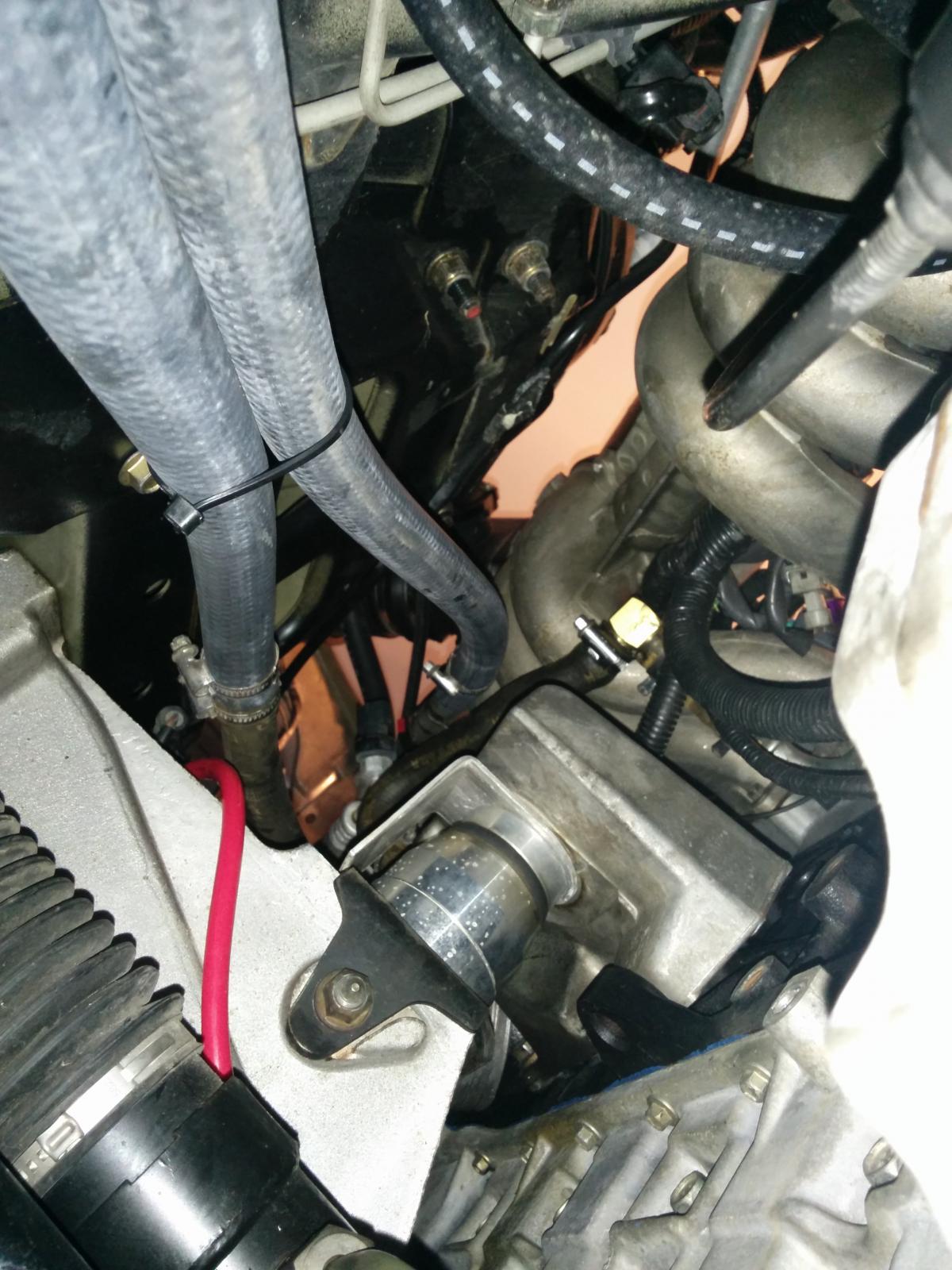

GeGe6 Donating Members 1,980 Member For: 12y 9m 13d Gender: Male Location: Perth, SOR Posted 01/01/15 01:56 AM Share Posted 01/01/15 01:56 AM Pic's of PWR heat exchanger for all interested. 2 Link to comment https://www.fordxr6turbo.com/forum/topic/89815-zf-heat-exchanger/page/6/#findComment-1520518 Share on other sites More sharing options...
Ralph Wiggum Moar Powar Babeh Lifetime Members 19,331 Member For: 19y 6m 28d Gender: Male Location: Perth Posted 01/01/15 02:20 AM Share Posted 01/01/15 02:20 AM And same/same fitted to a B seriesI had to modify the hosing arrangement slightly as my car was originally fitted with a thermostat valve for the trans cooler circuit. This was leaking and is no longer available from Ford ( or aftermarket) this ment the pipework on my car was different to PWR's supplied lay out.It was an easy enough fix I just had to buy another couple of meters of heater hose and a 19mm 90deg elbow and a 19mm straight joiner. (aprox $30 all up). Im happy with this layout as it removed 5 pipe connections compared to the stock set up and the joiner's PWR supplied. Less joines= Less chances to leak.Apart from that minor hurdle I cannot fault the quality of the kit. 3 Link to comment https://www.fordxr6turbo.com/forum/topic/89815-zf-heat-exchanger/page/6/#findComment-1520522 Share on other sites More sharing options...
