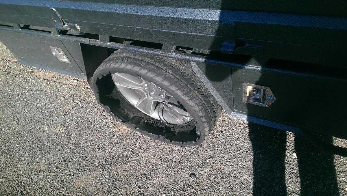

bupalooga Silver Donating Members 261 Member For: 12y 6m 8d Gender: Male Location: Griffith NSW Posted 12/12/14 10:52 AM Share Posted 12/12/14 10:52 AM So Iv been working out of town this week & was carrying both mine, my workmates tools and the bosses tool trailer.This is my ute Monday morningThen first thing this morning (friday) after towing 500km over the week.Had only just left motel and was going bout 40km/h when it went so I figured it must have been flat.Then another 220km later on the way home this avo.Going at 100km/h round a tight bend on a skinny road with 2 cars coming the other way.Also rubbed through the tail light wiring so ill be fixing that tomorrow.While the 19" 50th Anniversary rims with 245/35R19 93W tyres do look incredibly beautiful, especially on my ute. The tyres just aint tough enough with 650kg being the best weight rating that will fit, plus the road noise was getting a bit annoying.SOOOOOOOOOOOOOoooooooooooo I need new wheels! do people have any suggestions? Or should I just put steelies on the back for skiddies? I want thicker rubber, and a weight rating 100W minimum (800kg) I think will be enough. Ill have to find something quick for the work trip next week but ill make up my mind after new years.#Also does anyone have links to FG ute specs like front/back weight distribution, axle loads & ratings and that stuff? Link to comment https://www.fordxr6turbo.com/forum/topic/89732-i-need-nice-rims-tough-tyres-for-a-tradies-fg-ute/ Share on other sites More sharing options...

(Locky) Member 85 Member For: 11y 3m 12d Gender: Male Posted 17/12/14 10:28 AM Share Posted 17/12/14 10:28 AM Unless I read wrong you said it started to go flat and then 200Km the tyre failed?Sure it just didnt get driven around flat for a while and started chewing out the sidewall, then down the track something made the weakened sidewall let go?I just did a 1200Km round trip this weekend with towing 1200kg car on trailer with the back loaded up with spares, wheels, fuel and tools on a 225/35/19 on 19x9.5 rim no issues. Though am going to go to a 40 profile when these wear out just as they look too small on this size car Link to comment https://www.fordxr6turbo.com/forum/topic/89732-i-need-nice-rims-tough-tyres-for-a-tradies-fg-ute/#findComment-1518069 Share on other sites More sharing options...
bupalooga Silver Donating Members 261 Member For: 12y 6m 8d Gender: Male Location: Griffith NSW Posted 21/12/14 02:41 PM Author Share Posted 21/12/14 02:41 PM On 15/12/2014 at 3:06 AM, barnz said: Realistically your probably going to end up with a 17inch rim...which is the minimum that will clear your front brakes.I would say a bigger dual axle trailer is a better solution. Coz its going to look sh*te with 17's. You have oodles of pulling power.Or....a dual axle conversion but with a second diff not a lazy axle lol, coz 4 wheel burnouts are coolIts my bosses trailer that he tows behind his small truck usually. Just on this job he was driving his big truck so I got stuck with the trailer. 4 wheel burnouts do sound very interesting though! On 17/12/2014 at 10:28 AM, (Locky) said: Unless I read wrong you said it started to go flat and then 200Km the tyre failed?Yea u read wrong. 1st one failed then 200km later the 2nd one failedLight truck tyres start with 800kg ratings but only come in 16" rims or smaller which wont fit, & I'm guessing its illegal to have different size rims front & back?So my stock 245/35/19 tyres had a load rating of 93(650kg) but I found a single model of Tyre of the same size rated at 97(730kg) which are like $350 a Tyre: Goodyear Eagle F1 Directional 5.Is there any affect to increasing tyre circumference other than speedo being out a few km? can it be re-calibrated? Cause then I could go a 245/40/19 98(750kg) that are alot cheaperThe best similar sized 18" I could find is 255/40/18 99(775kg)& 17" is a 235/50/17 100(800kg) Link to comment https://www.fordxr6turbo.com/forum/topic/89732-i-need-nice-rims-tough-tyres-for-a-tradies-fg-ute/#findComment-1518679 Share on other sites More sharing options...
barnz Member 3,047 Member For: 11y 4m 25d Gender: Male Location: Brisbane Posted 21/12/14 08:31 PM Share Posted 21/12/14 08:31 PM A 249/40/19 has an overall diameter around 23mm bigger than a 35 series of the same size. Will probably make the abs chuck a fit and is illegal I'm pretty sure. Which is bs. Those goodyears sound like the go albeit the expensive option. No burnouts for you... Link to comment https://www.fordxr6turbo.com/forum/topic/89732-i-need-nice-rims-tough-tyres-for-a-tradies-fg-ute/#findComment-1518681 Share on other sites More sharing options...
