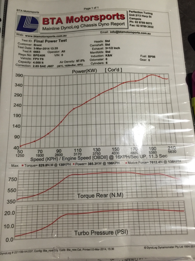

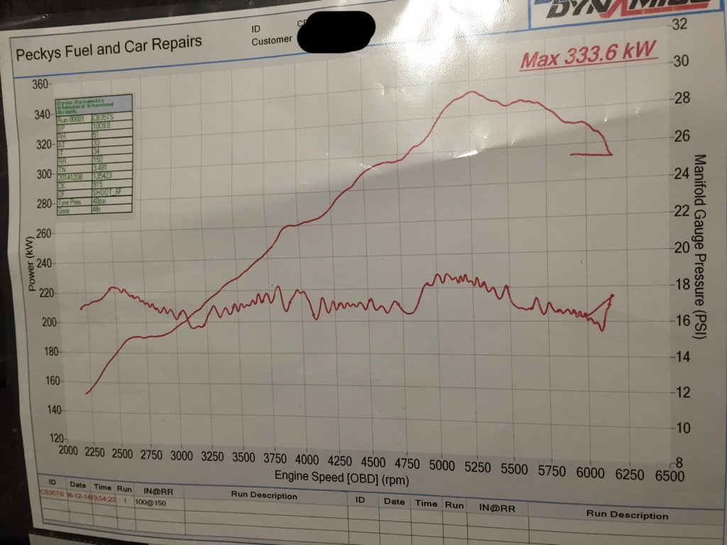

norrs Donating Members 448 Member For: 17y 10m 26d Gender: Male Location: Darwin Posted 08/12/14 12:15 PM Share Posted 08/12/14 12:15 PM (edited) Ok so since mods finished on my car in February this year had it on three dynosCv for a tuneBta for a tuneThen got it checked in Darwin for a power run to check it was ok in our weatherFrickin 53 Rwkw loss!!!Dude up here said it was running a but lean for our heat. He suggested I send my xcal to bta to have them adjust it.53!!!! Edited 08/12/14 12:22 PM by norrs Link to comment https://www.fordxr6turbo.com/forum/topic/89713-power-loss-from-humidity-and-heat/ Share on other sites More sharing options...

norrs Donating Members 448 Member For: 17y 10m 26d Gender: Male Location: Darwin Posted 09/12/14 03:19 AM Author Share Posted 09/12/14 03:19 AM I see. It was about 19 and now it is about 17 psi. Is that just heat or am I losing boost somehow Link to comment https://www.fordxr6turbo.com/forum/topic/89713-power-loss-from-humidity-and-heat/#findComment-1516707 Share on other sites More sharing options...
ratter Member 6,793 Member For: 19y 21d Gender: Male Location: @ my laptop Posted 09/12/14 04:43 AM Share Posted 09/12/14 04:43 AM boost pressure does change with temperature which is why I asked was it tuned in closed loop which will normally try to keep things constant, have you checked for boost leaks though? Link to comment https://www.fordxr6turbo.com/forum/topic/89713-power-loss-from-humidity-and-heat/#findComment-1516718 Share on other sites More sharing options...
stretch4660 Member 122 Member For: 12y 5m 25d Posted 09/12/14 05:50 AM Share Posted 09/12/14 05:50 AM What about the variation between the dyno's.? Some read higher some read lower.? Link to comment https://www.fordxr6turbo.com/forum/topic/89713-power-loss-from-humidity-and-heat/#findComment-1516731 Share on other sites More sharing options...
ratter Member 6,793 Member For: 19y 21d Gender: Male Location: @ my laptop Posted 09/12/14 09:24 AM Share Posted 09/12/14 09:24 AM boost should read the same Link to comment https://www.fordxr6turbo.com/forum/topic/89713-power-loss-from-humidity-and-heat/#findComment-1516757 Share on other sites More sharing options...

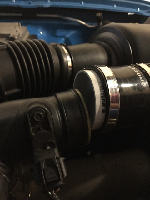

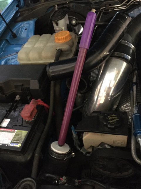

norrs Donating Members 448 Member For: 17y 10m 26d Gender: Male Location: Darwin Posted 09/12/14 11:27 AM Author Share Posted 09/12/14 11:27 AM On 09/12/2014 at 4:43 AM, ratter said: boost pressure does change with temperature which is why I asked was it tuned in closed loop which will normally try to keep things constant, have you checked for boost leaks though?Yeah I checked the other day. Everything looked fine. All clamps tight, unless there is a hole down low if rubbing. I'm assuming boost leaks are just visually checked, or should I put the garden hose in the intake and see if it leaks (joking) Link to comment https://www.fordxr6turbo.com/forum/topic/89713-power-loss-from-humidity-and-heat/#findComment-1516777 Share on other sites More sharing options...
norrs Donating Members 448 Member For: 17y 10m 26d Gender: Male Location: Darwin Posted 09/01/15 01:41 PM Author Share Posted 09/01/15 01:41 PM Checked for leaks bodgy style but none found Link to comment https://www.fordxr6turbo.com/forum/topic/89713-power-loss-from-humidity-and-heat/#findComment-1522294 Share on other sites More sharing options...
