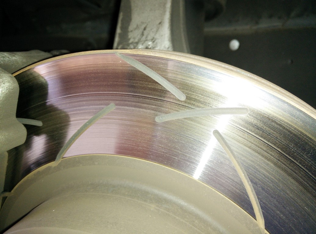

FormulaFG Donating Members 68 Member For: 11y Posted 19/01/15 05:57 AM Share Posted 19/01/15 05:57 AM (edited) If your rotors have resin on them is that something easily identified visually?I currently run Bremtec Endures with T3 rotors on recommendation from Matt @ Race Brakes Sydney. Stock calipers and braided lines.I was braking hard down from 100+km/h the other day and the wheels felt like they were going to vibrate off. I know the car has ABS and it will pulsate a bit, but damn......Think I should machine the rotors and put the OEM pads back in? Edited 19/01/15 05:58 AM by FormulaFG Link to comment https://www.fordxr6turbo.com/forum/topic/89687-brake-shudder-on-the-hunt-for-the-problem-over-heated-brake-fluid/page/9/#findComment-1524728 Share on other sites More sharing options...

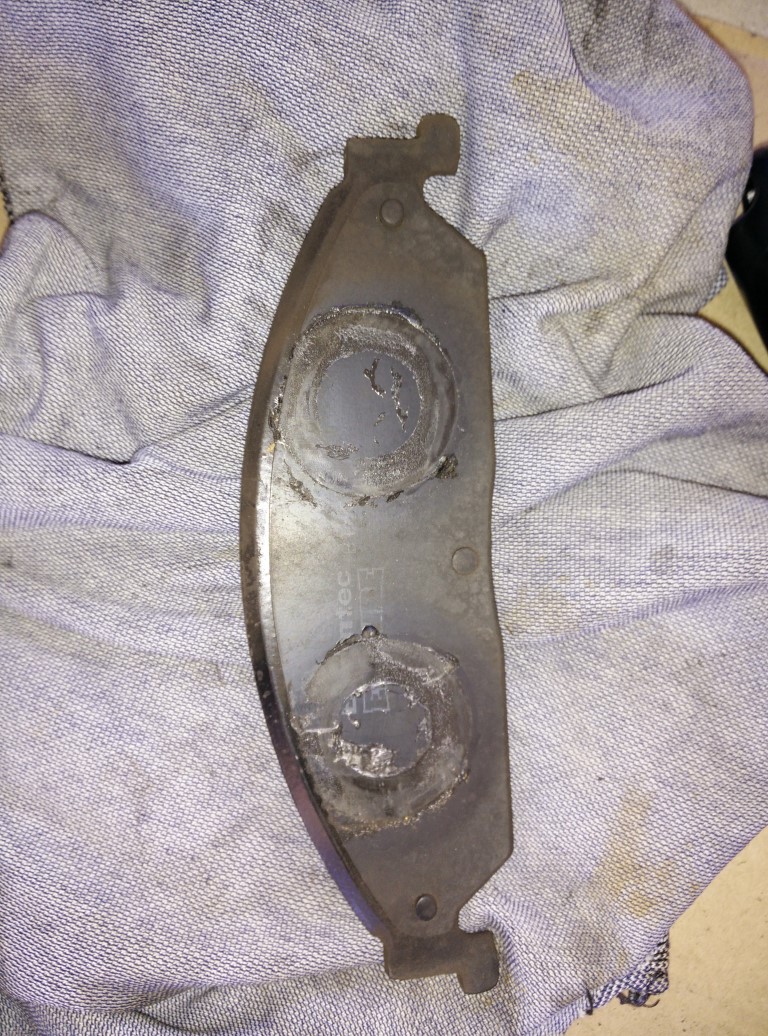

masda74 To Loud Gold Donating Members 4,112 Member For: 13y 6m 19d Gender: Male Location: WA, Perth Posted 19/01/15 07:35 AM Author Share Posted 19/01/15 07:35 AM Ahh I see that it looks like it may be the pads after all. This is the second occurrence of this happening.Well I put the stock pads(after scuffing them up on the side of the road) back in and did some hard braking.Most of the shudder has gone, but there is still a bit under hard braking.I would suggest taking out the Endure pads, scuff them up on the side of the road and then put them back.allow the car about 200-300km to bed the pads in. no hard braking.Then do some controlled emergency braking and see if it reduces the shudder.This is a different approach to what I have done, but I am curious to find out if it scrub the resin off completely. Link to comment https://www.fordxr6turbo.com/forum/topic/89687-brake-shudder-on-the-hunt-for-the-problem-over-heated-brake-fluid/page/9/#findComment-1524739 Share on other sites More sharing options...

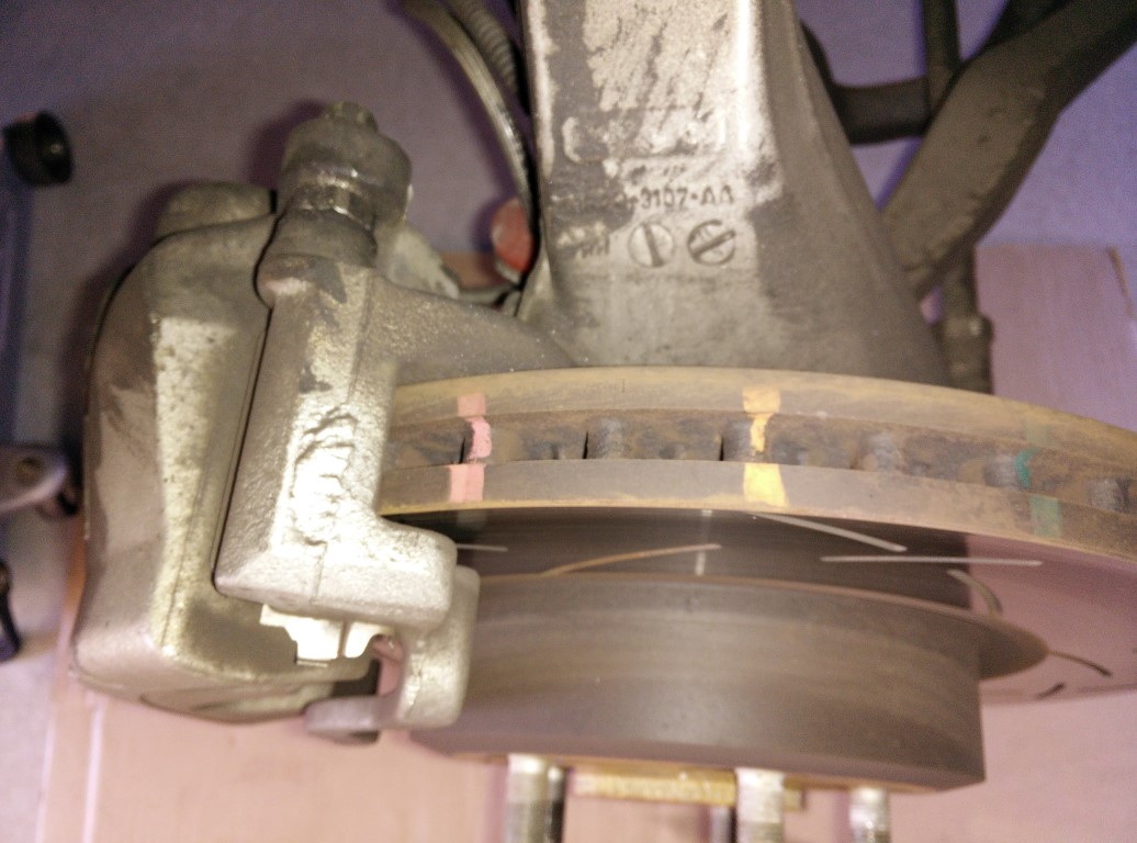

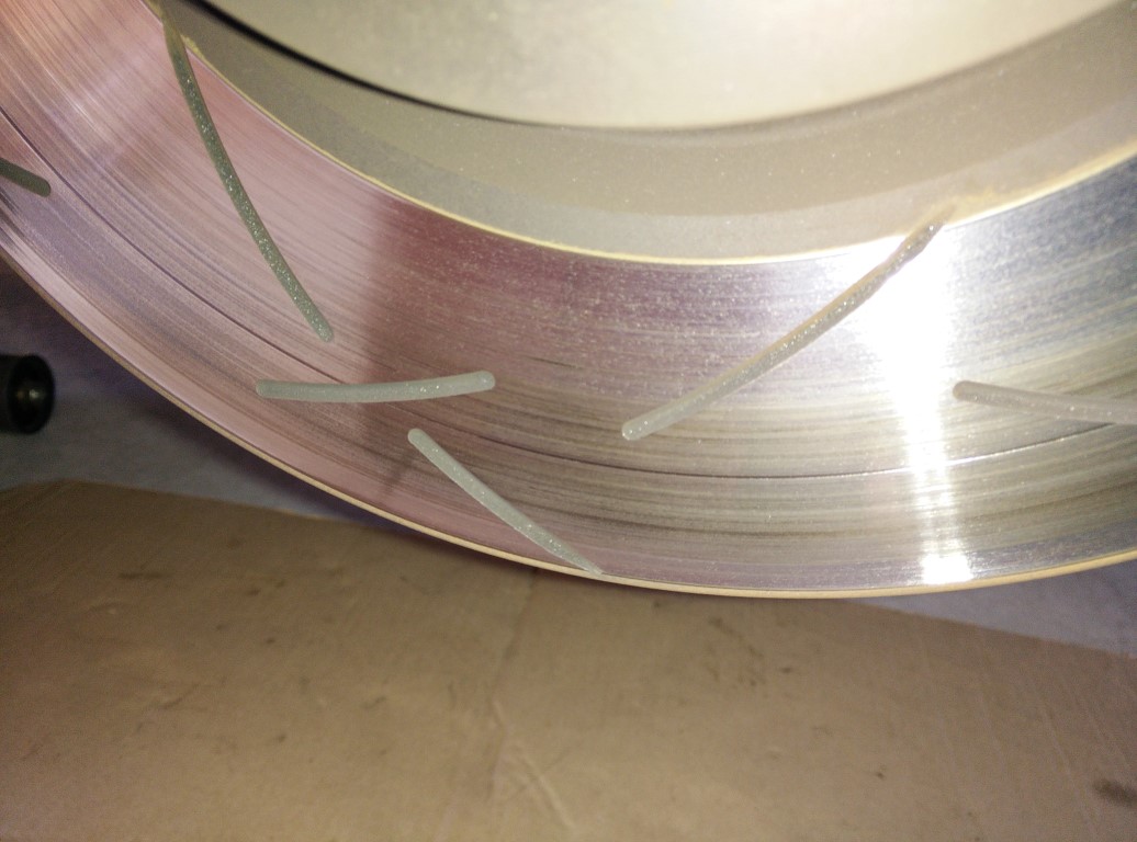

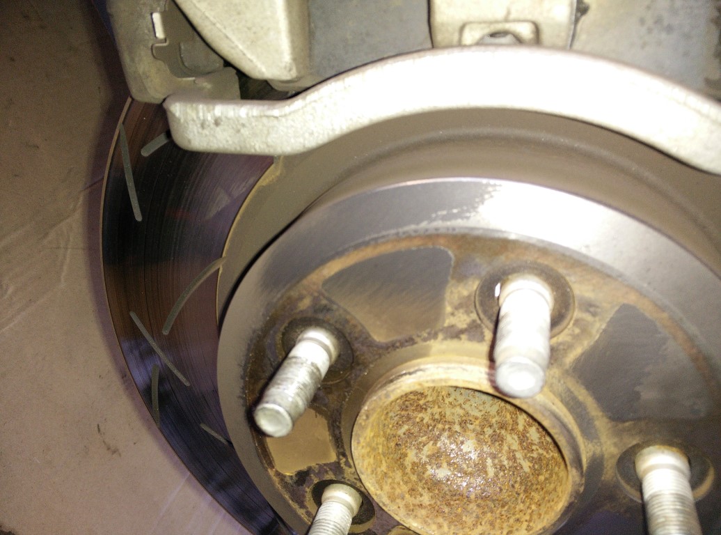

masda74 To Loud Gold Donating Members 4,112 Member For: 13y 6m 19d Gender: Male Location: WA, Perth Posted 19/01/15 08:05 AM Author Share Posted 19/01/15 08:05 AM Thought I would post an update. This was all done the previous weekend of the 10th of Jan.From this pic, you can see the goo on the back of the pads. The stuff was like glue and made my life a living hell for 15-20 mins.I was told that if I took one of the bolts off the back the calliper (not of the support bracket), I could rotate the calliper out of the support bracket and swap the pads.Easier said than done, when you doing this for the first time.I even jumped on the forum to do a search. I eventually could not find the answer and just decided to grab a spanner and use it to wedge the calliper out.I put CRC red goo on afterwards to stop the squealing.Here you can see the different angles of the rotor and the different colours. The back of the rotor was the same thing.The indicators on the top of the rotor indicated that the rotors had not reached a set temperature.Since the Endure pads are meant to endure temperatures of up to 450 degrees Celsius(I think that is what Matt said.) if it had reached that temp, then the markers on the rotor would show that.however the markers do not indicate this. Matts words were that it cold be the pads.I did it all down to the book. The rims were cleaned on the inside. Before and after pics. Here you can see that the rotor face the meets up with the rim, is half way to being cleaned out.Yes I did get it all cleaned out.I got the torque wrench out and tightened them calliper nuts to spec(well at first I thought I did.) I did them to 124nm which is the same as what wheel nuts were done at.I then realised hat they should have been between 115nm. The support bracket is between 98-132nm from what I can tell from the BF manualA week of very sedative driving and taking it easy was done. Then one day I got stuck behind two cars travelling at 85-90km/h in a 100 zone.Lost my patience and over took at the first opportunity that I had, with all the rage in the world.It was at this point that I spotted someone up ahead in the bushes and so I did the first CONTROLLED emergency stopping since putting the OEM pads back in.I believe this cleared out most of the resin from the rotors.Now during normal driving, I can not feel the shudder at all. At 80km/h and above there is a small amount of shudder but not noticeable unless you looking for it.If you do any emergency braking at 100km/h you then feel the shudder. It is not as un-nerving as it was previously.At this point, I plan on putting the OEM rotors back in, then put the OEM pads back in as well.Grab the DBA rotor and take it either to Ellenbrook or Nick in East Perth and get them machined. Link to comment https://www.fordxr6turbo.com/forum/topic/89687-brake-shudder-on-the-hunt-for-the-problem-over-heated-brake-fluid/page/9/#findComment-1524743 Share on other sites More sharing options...
FormulaFG Donating Members 68 Member For: 11y Posted 19/01/15 06:42 PM Share Posted 19/01/15 06:42 PM Thanks for the update. Looks like I'll have to pull the wheels off and investigate further. Looks like the bremtecs might be headed for the bin. Link to comment https://www.fordxr6turbo.com/forum/topic/89687-brake-shudder-on-the-hunt-for-the-problem-over-heated-brake-fluid/page/9/#findComment-1524818 Share on other sites More sharing options...
