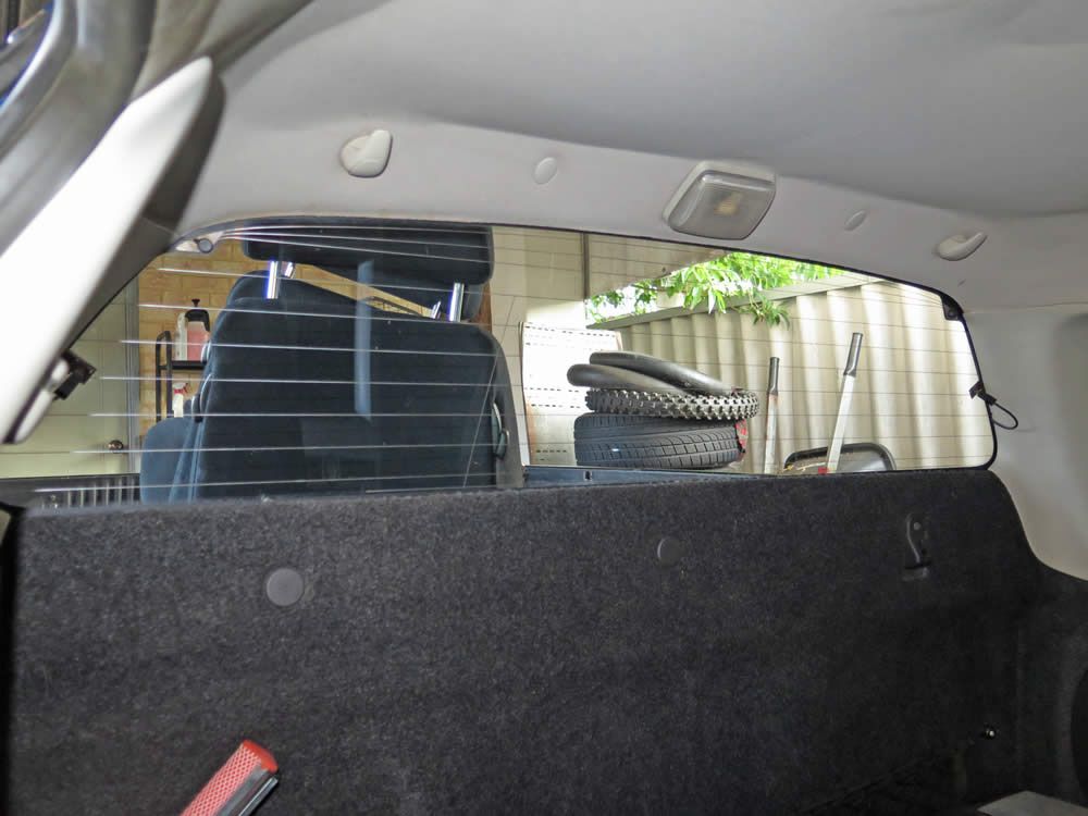

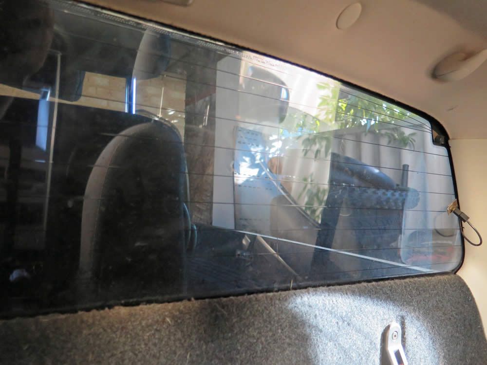

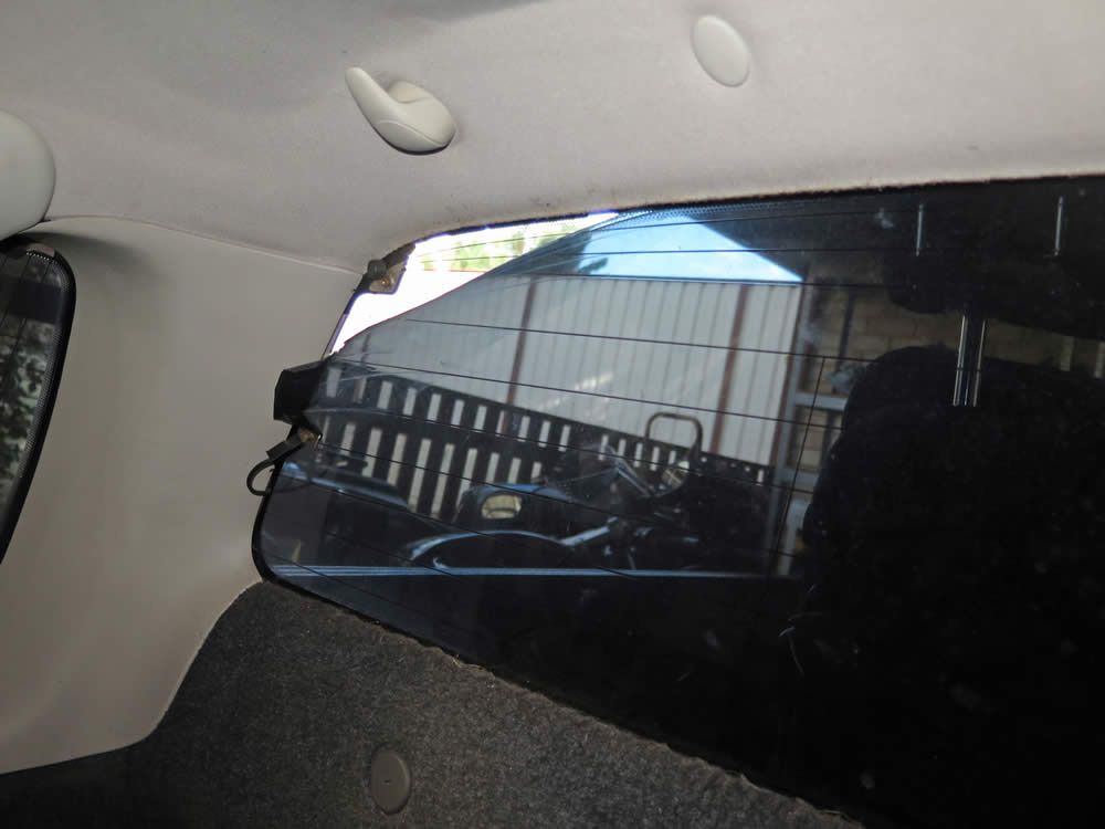

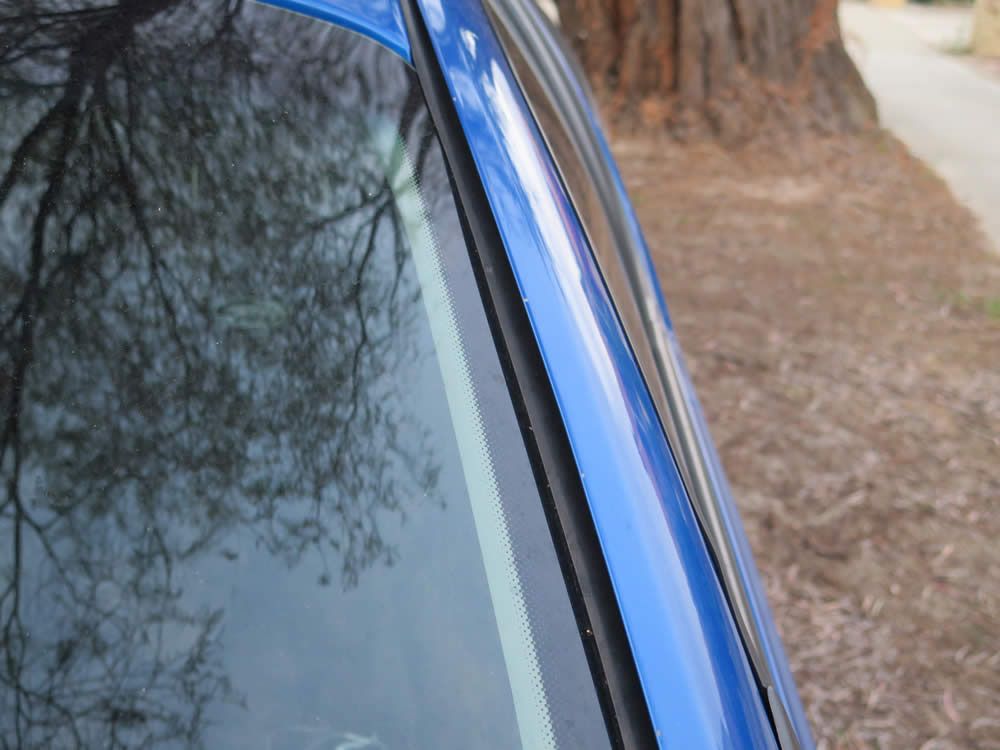

Since I started driving the Tornado I’ve been hating the dark tint on the back window. Also, with a motorbike background, I’m used to maintaining a constant awareness of everything that is happening around my vehicle. The dark tint means that even in daylight, seeing things behind the car requires a split second of hesitation, instead of seeing and identifying things instantaneously.
The photos don’t show it, but it’s extremely dark and rear vision at night is almost nothing. When parking, I always reverse in, including reversing the Tornado up my long driveway at night.
The black plastic tray also makes it hard to see where the ute ends when reversing.

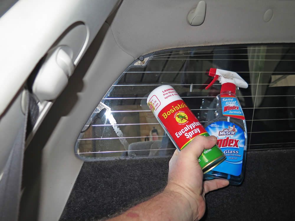

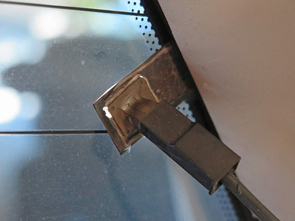

At first I couldn’t tell whether the tint was the usual stick-on stuff or part of the glass. Then I saw the clear part and realised that it was definitely stick-on.
I assumed that it was going to be difficult to remove, so took the car to a windscreen place. The girl at the front counter gave me a price of $77 to remove the tint from just the one window. One of the workshop staff questioned her on this, and when she said that was the cheapest that she could quote, he went out to the car and peeled off one corner so that I could do it myself at home.
He said to peel it off carefully and slowly. However, once at home I found that the whole lot peeled off in seconds.
Then I went over it with some eucalyptus aerosol spray to remove the remaining sticker residue, before finishing the job off with some Windex.
I’ve now got a clear back window, and can see behind the ute at night.

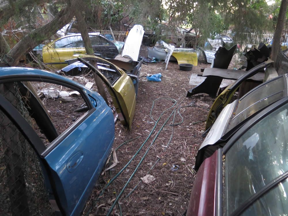

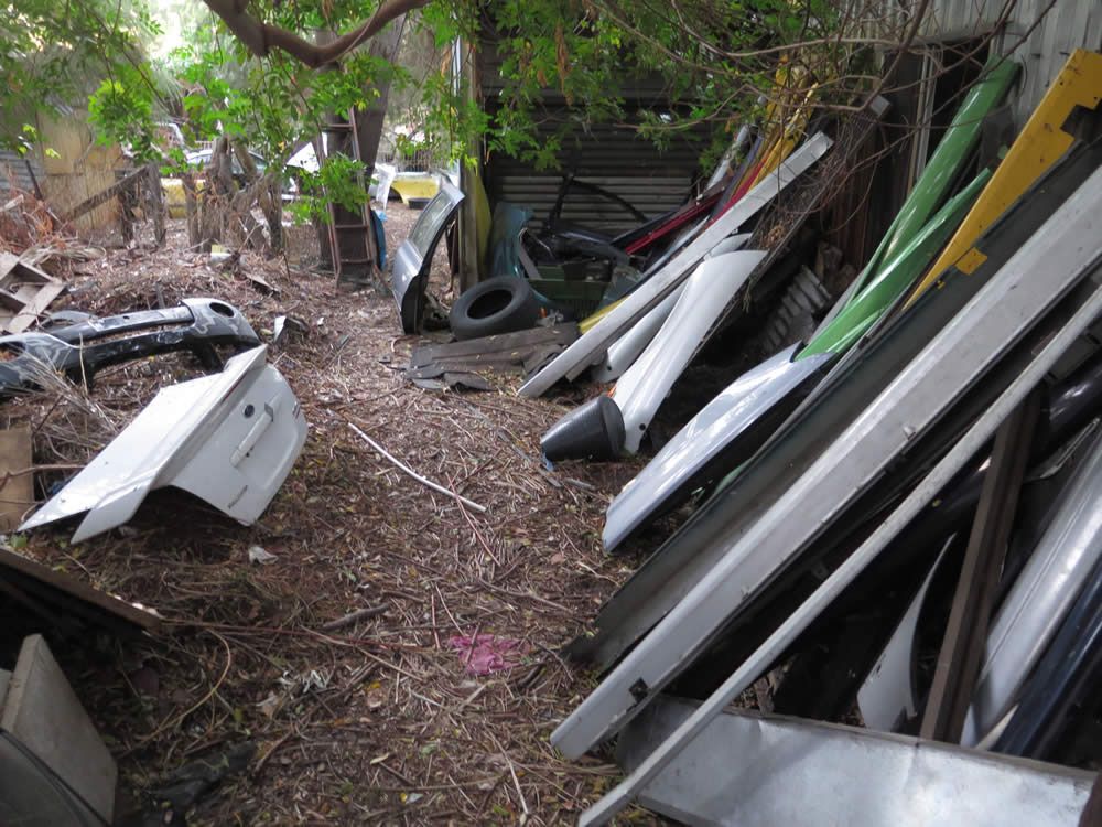

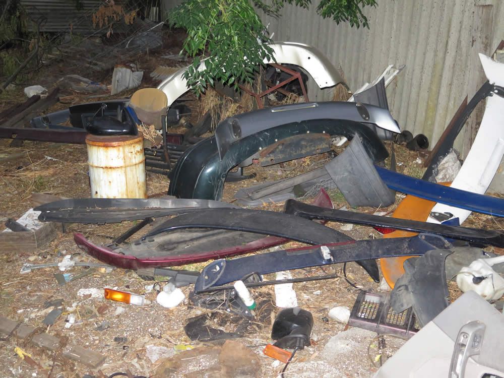

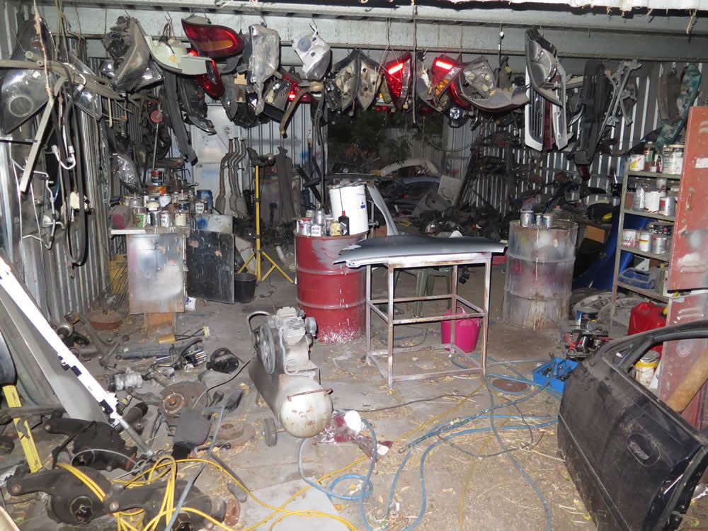

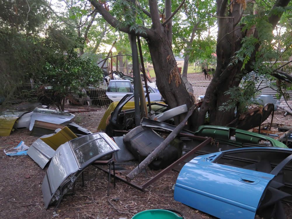

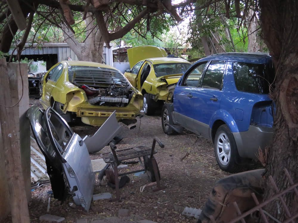

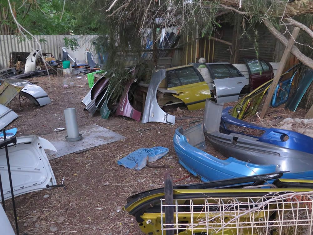

Then it was time to go shopping for some parts. There’s a guy that I know who buys crashed Falcons at auction and wrecks them from home.
He is extremely disorganised and the place is always a mess. But he’s cheap and usually has whatever I’m after at the time.

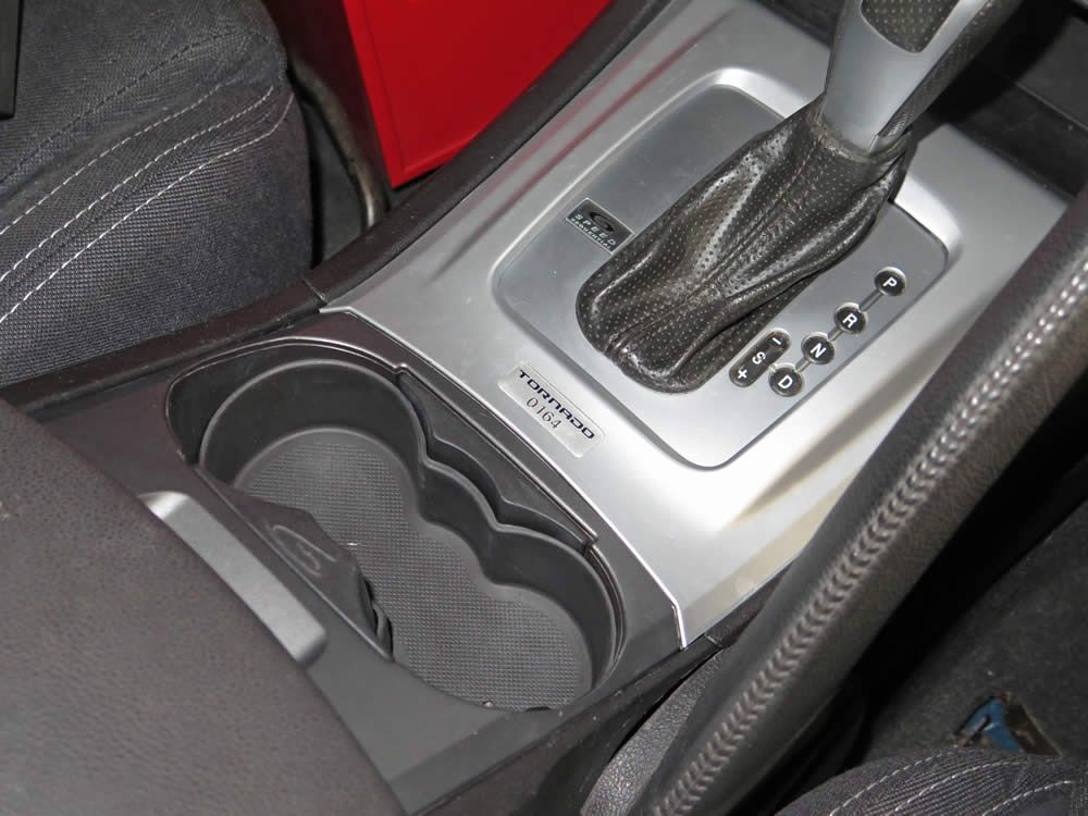

I bought a BF cup holder, another station wagon switchgear (so now I’ve got two spares), an airbag with side buttons and a seat mount bolt. This all cost me $80.

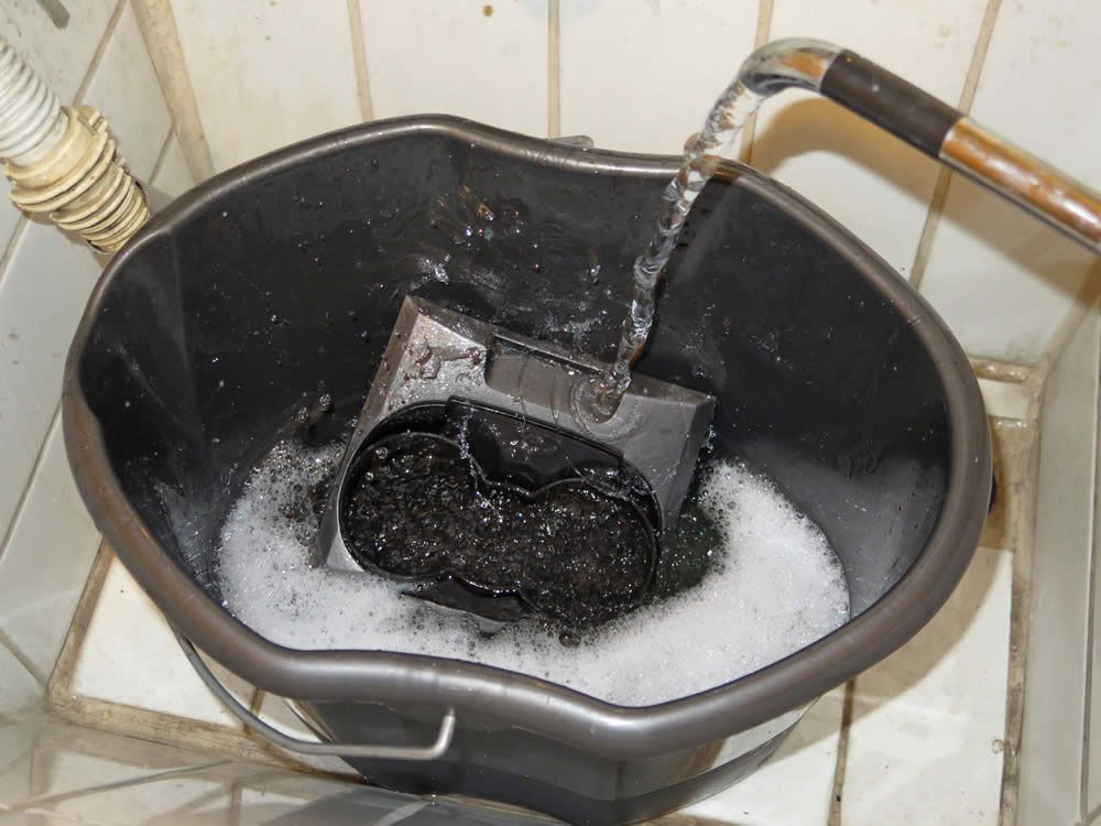

The cup holder got washed with detergent and water.

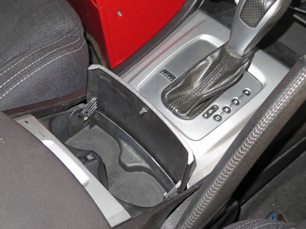

I don’t like the standard BA-style cup holder with the flip-over lid. It doesn’t hold drinks in place properly, hence the mess from a previously spilled drink that I cleaned up on Sunday when the carpet was cleaned.
The BF cup holder stands out because it’s a different colour to the gear lever surround. I’ll paint the top of the cup holder once I figure out what paint to use.

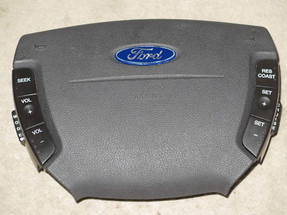

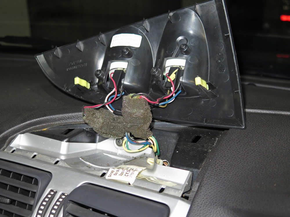

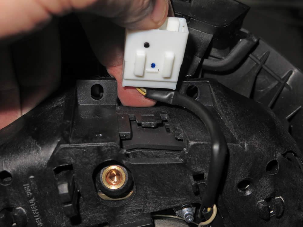

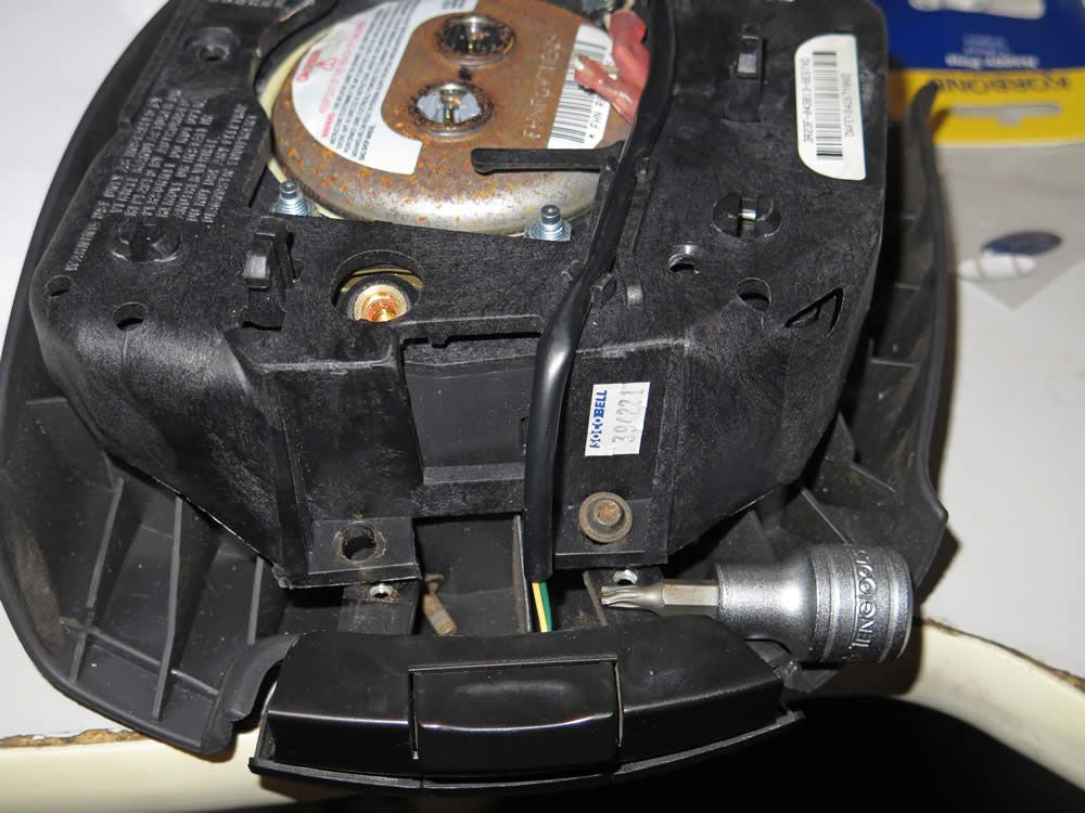

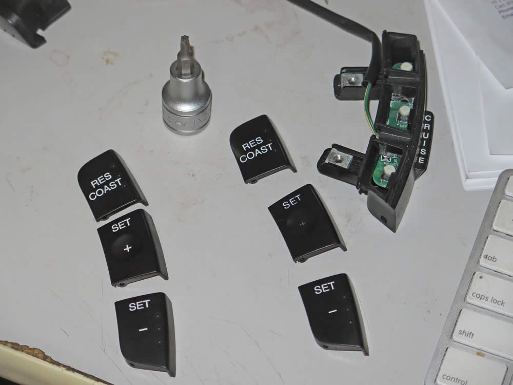

I removed the side buttons from the airbag that I bought. I used a Torx T25 socket for this.
The cable for the side buttons has this connector, which sits on a plastic mount. You can see the small plastic bump near the blue dot - to remove the white connector from the black plastic mount, lift the white connector at the rear (where the yellow and brown wires come out of) and slide the connector off the black plastic mount.
The connectors on the back of the airbag were difficult to remove, so I used some needle-nose pliers to firmly jiggle each connector side to side to slide them off.

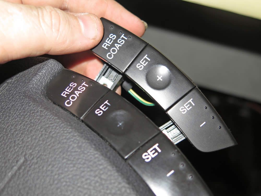

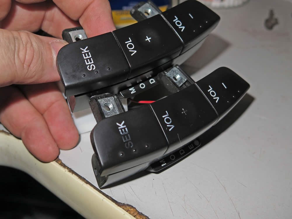

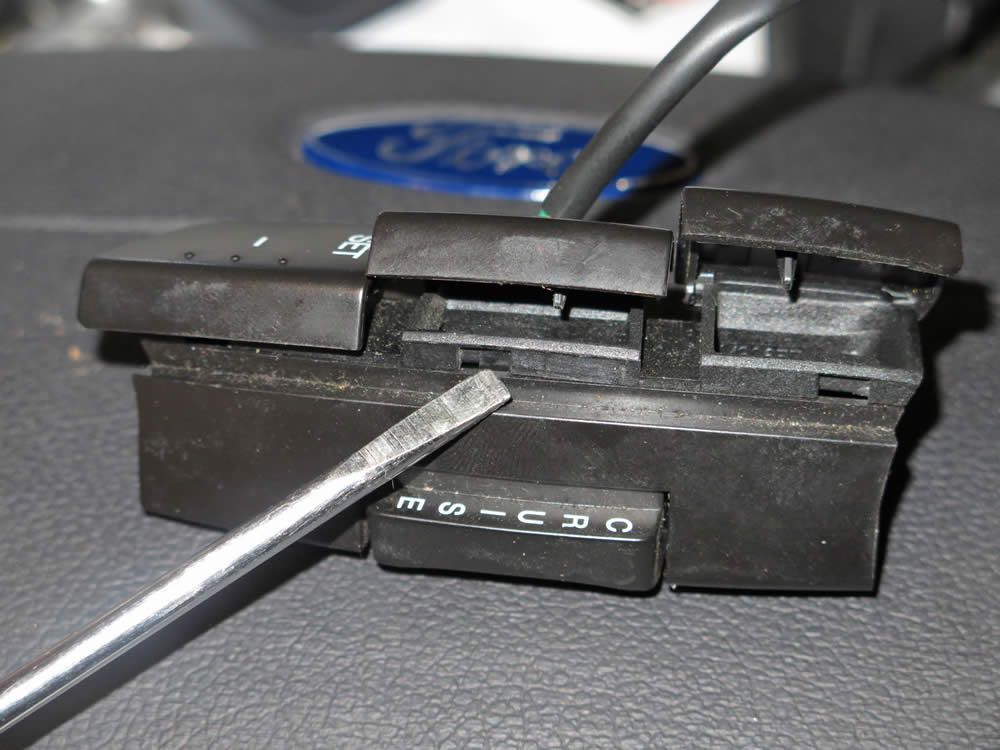

Here you can see the difference between the two sets of audio control buttons. The lower ones are the old ones, and the top ones are the ones that I’m going to replace them with.
The two sides of buttons are on the same wiring loom. However, the cruise control buttons on my new set were showing signs of wear.
With a flat-blade screwdriver, I removed the cruise control buttons from each set.
Once I had both sets of buttons off, I was able to pick out the best ones to keep.

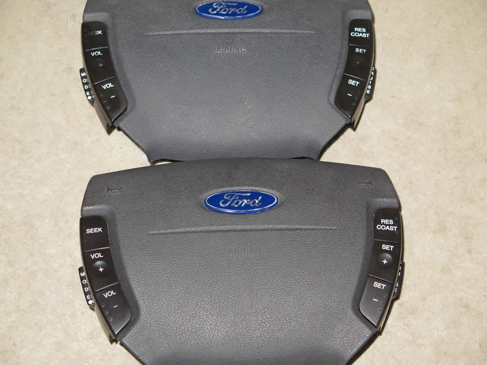

I put it all back together. I tried cleaning the old airbag, but the pre-existing one was in better condition.
The two airbags. The bottom one is the previous one, with the best of the buttons. I’ll resell the one above.

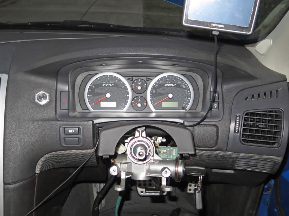

Tonight I wanted to replace the station wagon switchgear that I had put on with the original ute one - the difference is the switch for the rear window wiper on the station wagon set. This isn’t required on the ute, so I wanted to put the ute switchgear back on.
I had replaced the ute switchgear with the station wagon one because the indicator self-cancel wasn’t working on the ute one. When I was shopping for parts I looked at another switchgear and compared it with photos from this thread.
I figured out what was wrong with the ute switchgear, and it turned out to be an extremely easy fix.
This photo shows the ute switchgear on the left, and the station wagon one on the right. The difference is the white plastic ring in the centre. It turns out that this is what controls the self-cancel, and that plastic ring was missing on my ute switchgear.
Here’s how it works - the white plastic ring rotates with the steering wheel and and steering column shaft. The switchgear stays stationary. You can see the two plastic tabs on the ring - one on each side. It is these tabs that control the self-cancel.
Imagine that the car was turning to the left. If that centre ring rotates just a fraction more then it will push the plastic rod on the left, forcing the indicators to cancel. It’s actually very simple.
This time I have lined up a tab so that it is about to self-cancel when turning right (ie rotating the steering wheel clockwise). The plastic rod gets pushed, which builds up tension in the spring (there’s a ball bearing ball on the end), which forces the indicator stick to go back to its central position.
In this photo, if the centre ring continues to rotate clockwise (ie turning right) then it doesn’t push the plastic rod far enough over to force the indicators to self-cancel.
It had taken me some time to figure all this out, but now I know how to fix any future self-cancel problems that I might have with my taxis in the future. It’s all about that plastic ring in the centre.
By now I had pulled everything apart and re-assembled it all several times. I learned that the clockspring didn’t have to be disconnected and completely removed each time, so just left it hanging there.
I removed the plastic ring from the station wagon switchgear.
As the plastic ring will be regularly rotating within the switchgear, I added some grease.
I pushed the plastic ring into place and made sure that there was also plenty of grease where the ball bearing is (on the end of the spring).
Doing all of this with wheelie bins made it easier. Putting the cable between the handle and bin meant that the switchgear couldn’t slide off and onto the ground.
You can see here how the steering column shaft rotates the white plastic ring when the steering wheel is turned. The black plastic of the switchgear remains in the same place.
The switchgear is attached to the top of the steering column at three mounting points. One of them is at the end of the screwdriver. There is another screw on the left side and one on the top. A ratchet screwdriver made it easier to undo and tighten the screws, and a magnet made it easy to remove them without them dropping onto the floor and bouncing into some corner where they couldn’t be found.
Finally getting somewhere. The switchgear and clockspring are in place, and the next step is to put the steering wheel back on.
Then I got curious and wanted to check the headlight switch wires. When the headlight switch doesn’t work then it is because one or more of these wires has broken. This is what had happened to the original switchgear that was in the ute when I bought it. Although those wires can be easily soldered back together, I had a spare working switchgear at home so put that on. I just didn’t notice at the time that my replacement switchgear was missing that plastic ring in the centre.
I finally got it all back in one piece and went for a test drive. I was pretty pissed off when the headlights wouldn’t work at all - only the high beam would. It was night, and the ute was also low on petrol, so I made my way to the nearest servo via some backstreets. Then I had to go home, pull it all apart again and try and figure out why the switchgear that has been working for the last few months (except for the self-cancel) was now not working.

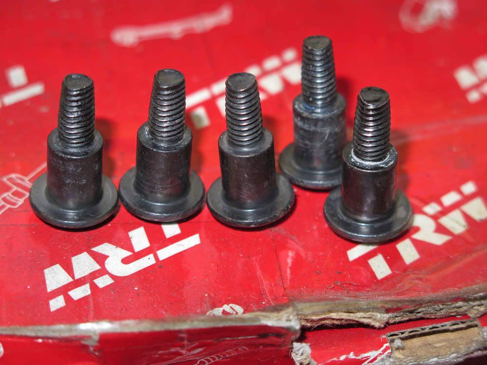

To further make sure that I put the bolt back in place securely, I looked up the torque setting in the service manual. I then used a digital torque wrench to tighten the bolt to the specified 38Nm.

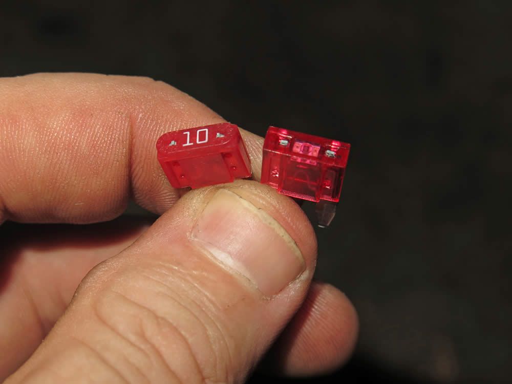

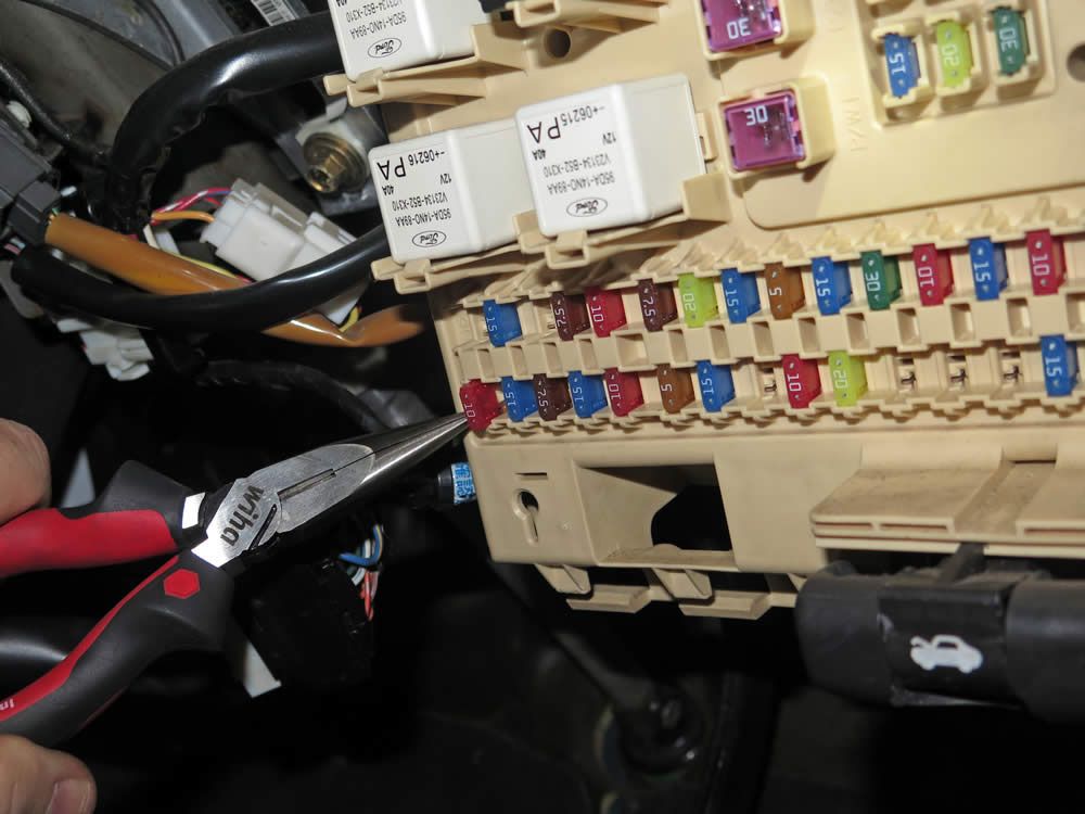

During re-assembly I had accidentally touched something on the back of the switchgear with some metal on the steering column. Sure enough, the indicators now weren’t working at all. I figured that it might be a fuse, so looked up which fuse was for the indicators - it’s the bottom right one, which is a 10A fuse.
On the left is the blown fuse, and on the right is one that I bought from Jaycar last year. The Jaycar fuses have an LED in them which lights up if the fuse blows, making it obvious that it has blown.

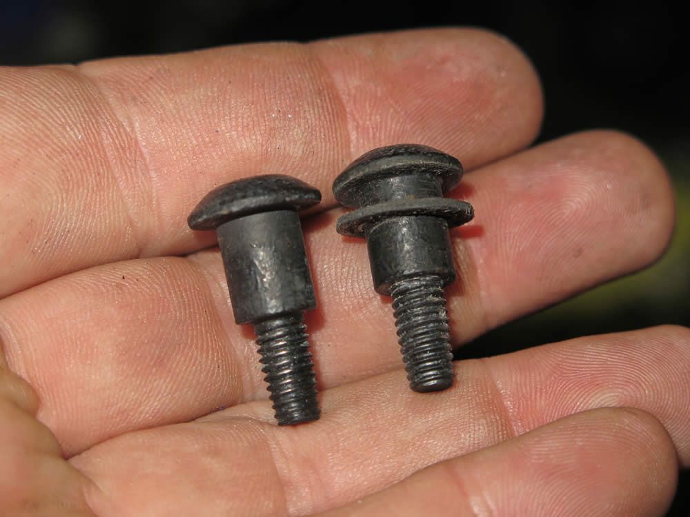

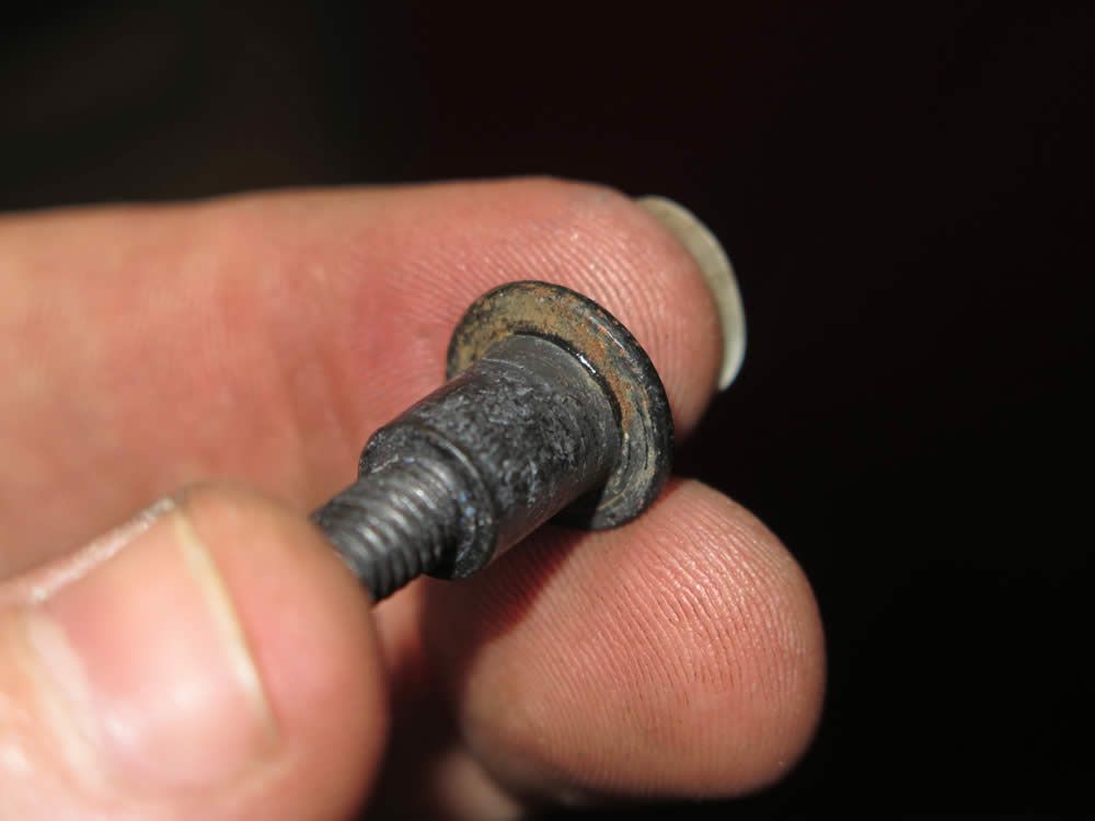

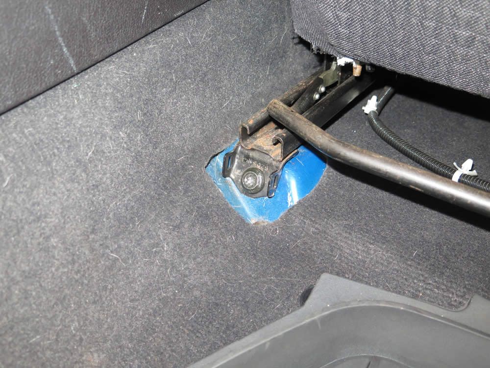

I also tried a different seat mounting bolt, in the faint hope that it was the bolt threads that were damaged instead of the floor threads. I was very pleased when the replacement bolt went straight in, meaning that I won’t have to re-tap the thread.

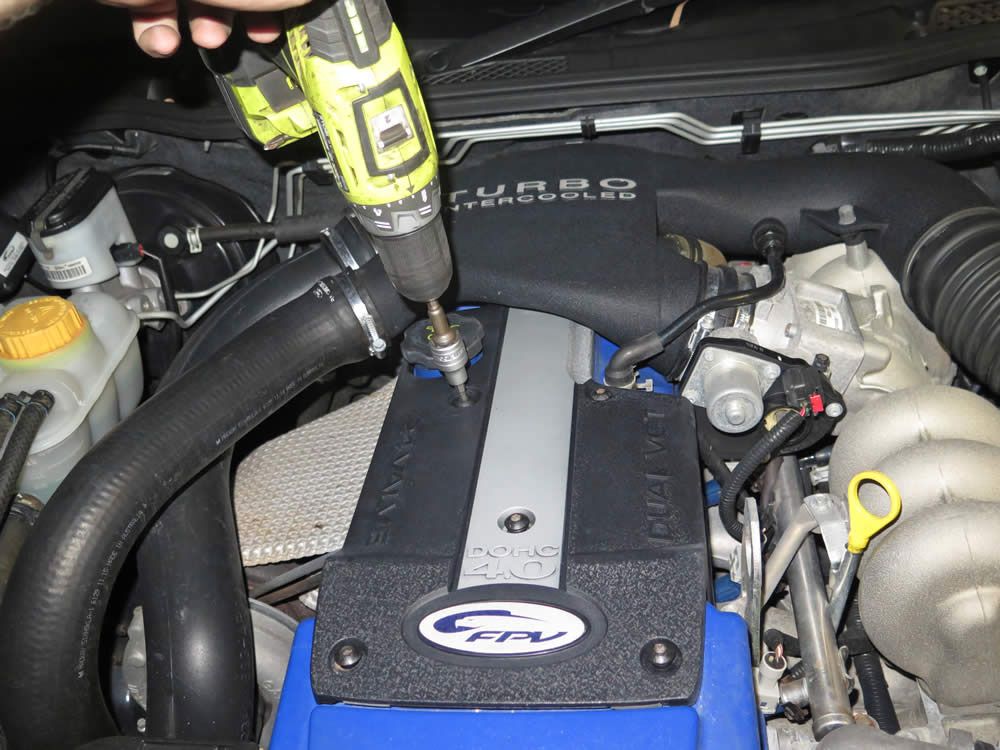

I wash my engine bays regularly as I like to keep them clean and easy to work on. However, on the Falcons, water can get past the coil cover bolts and then down into the spark plug holes. This then shorts out the plugs, resulting in the car running on less than six cylinders.

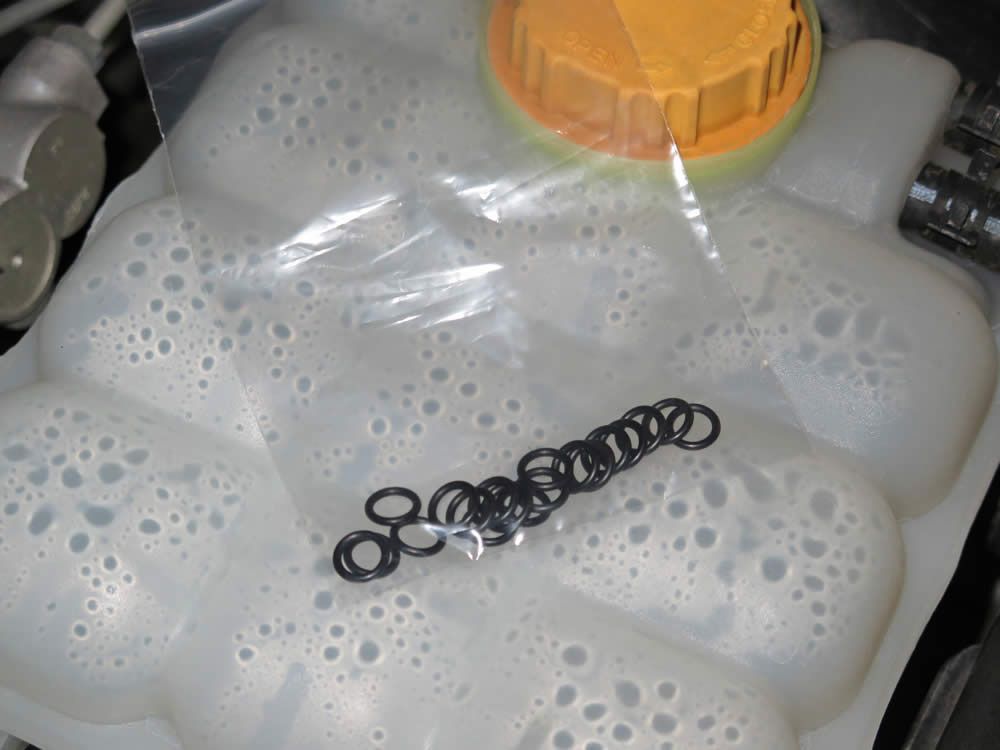

On my taxi I tried some heat-proof o-rings a while ago. They have worked well, and I can now wash the engine bay without risking water getting past the coil cover bolts. I went and bought a bunch to use in the future.

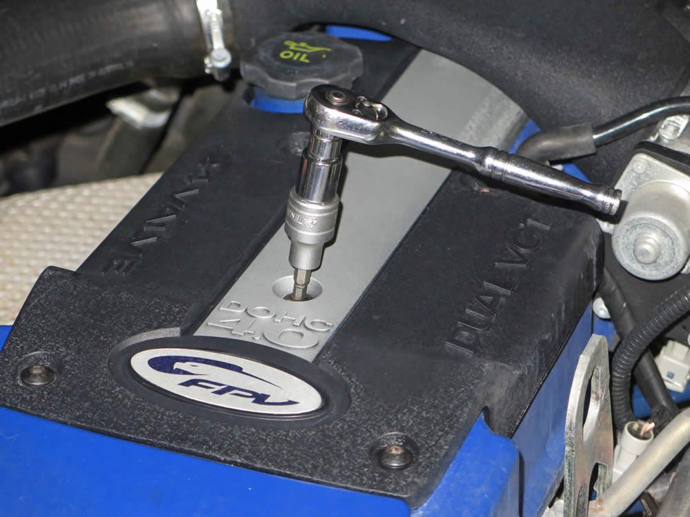

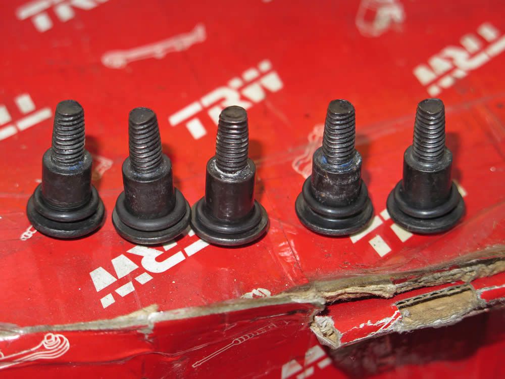

From the factory the coil cover bolts have a fibre washer on each one. However, on secondhand cars those washers are often broken or missing. I only removed the front five bolts because I couldn’t be bothered removing the intercooler piping, but two of those bolts were missing the fibre washers.
I checked under the head of each bolt to make sure that the o-rings would seal, and found corrosion on some of them.

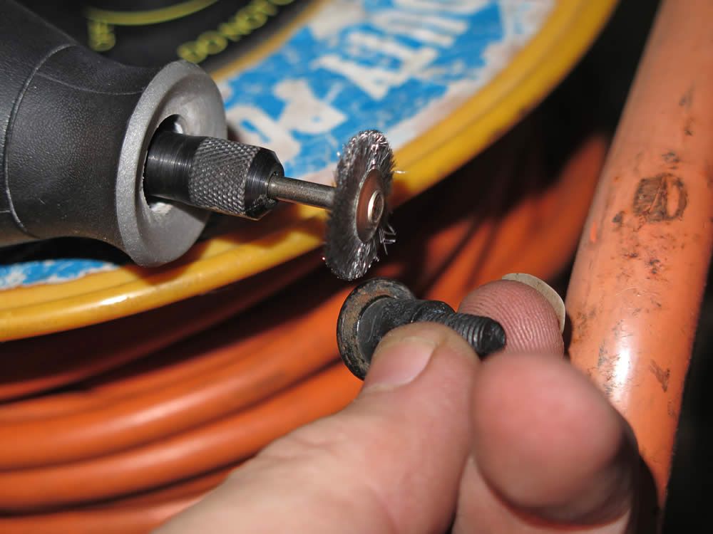

I recently bought a Dremel, so had a go with that and a small wire brush to see if it would clean up underneath the head of each bolt.
This worked much better than expected, resulting in clean surfaces for the o-rings to seal against.
I put an o-ring on each bolt.
I use a Ryobi cordless drill all the time for this sort of job, but for coil cover bolts I set it to the minimum torque setting to ensure that I don’t strip the threads in the head (ie where the coil cover bolts screw into).
Once the bolts are in place I use a small 1/4” drive ratchet to finish tightening them. Using something so small helps to ensure that I don’t overtighten them with a full size 1/2” ratchet.

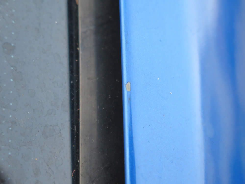

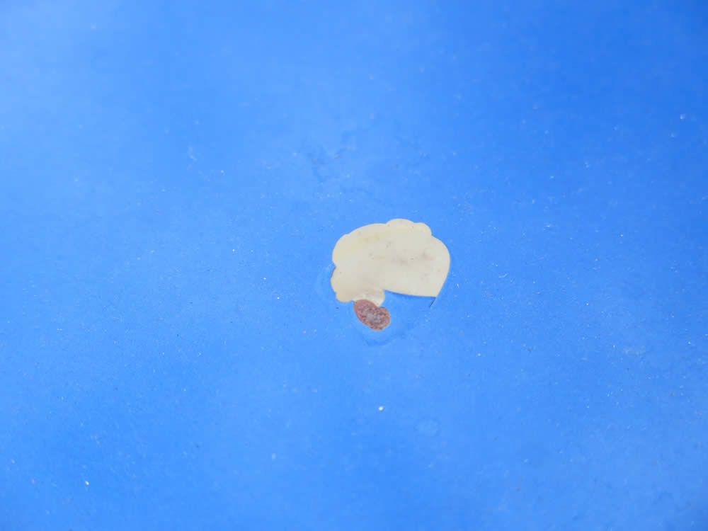

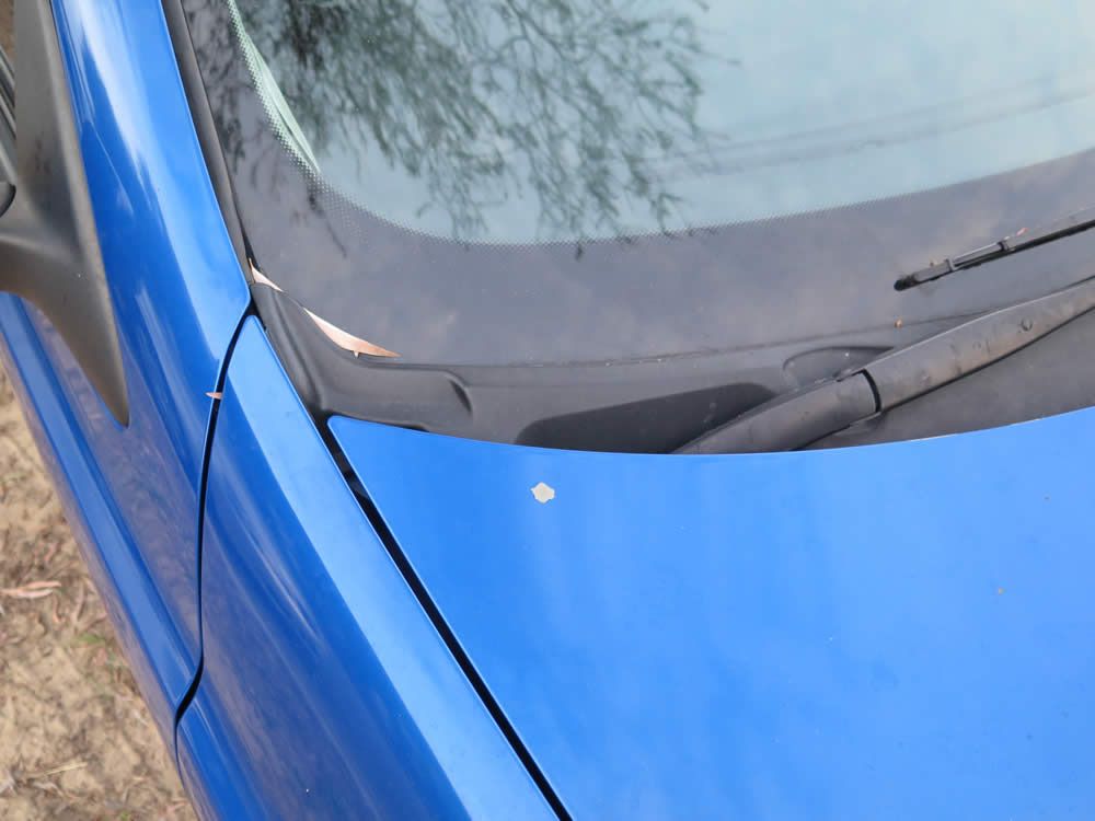

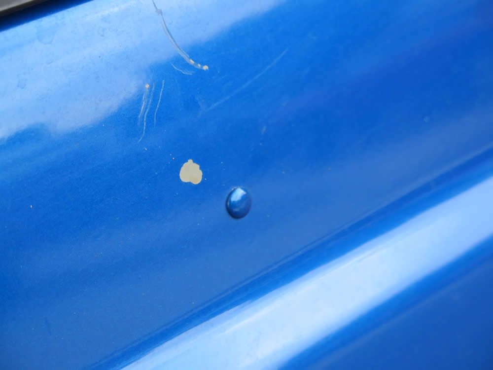

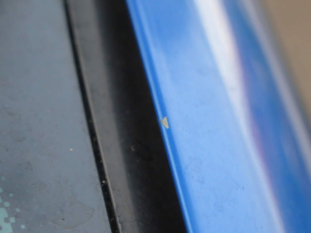

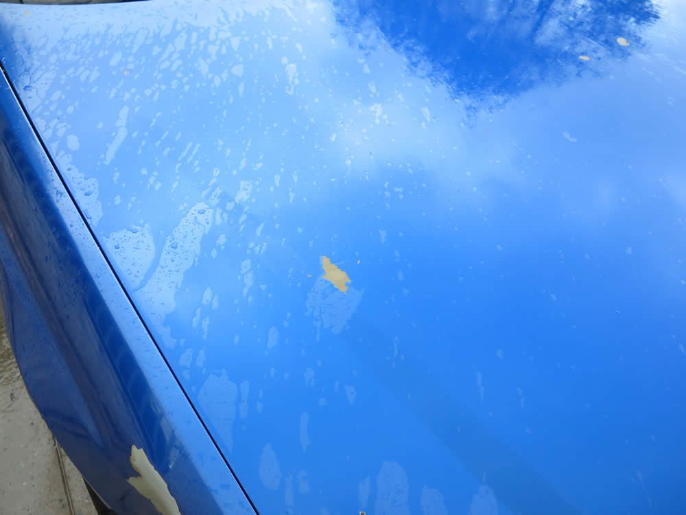

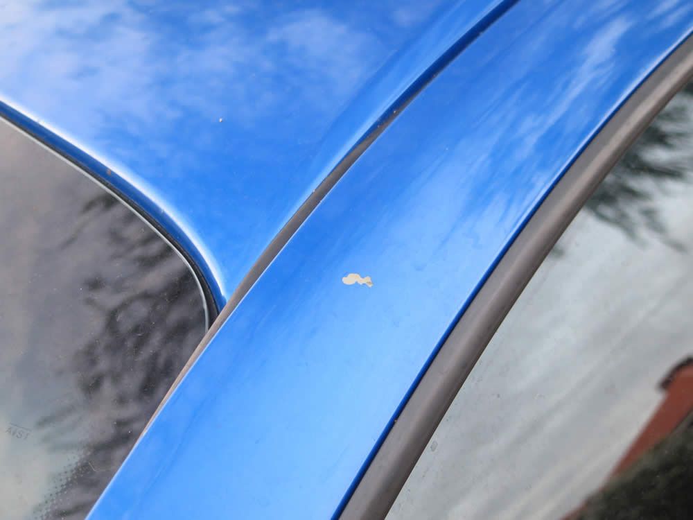

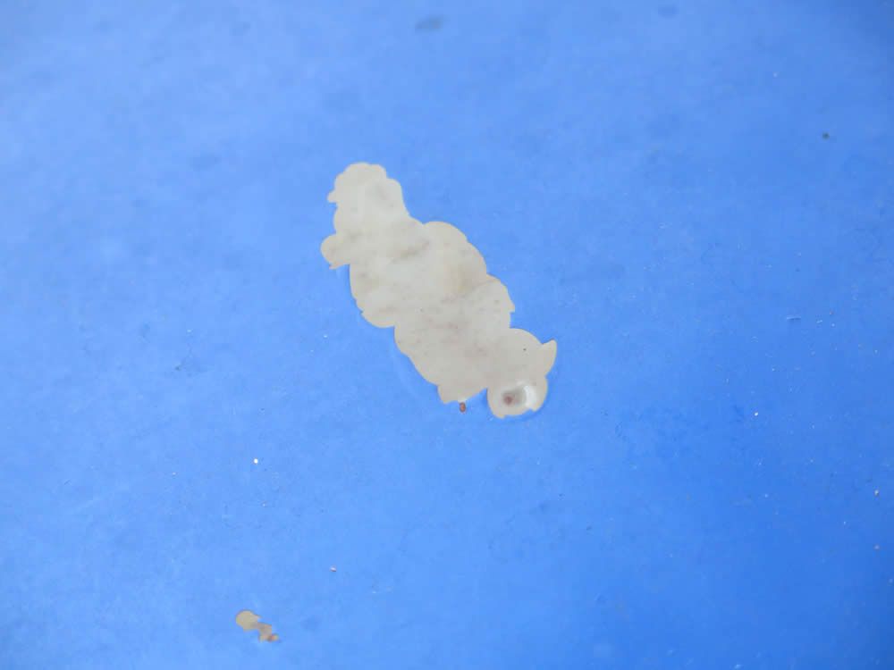

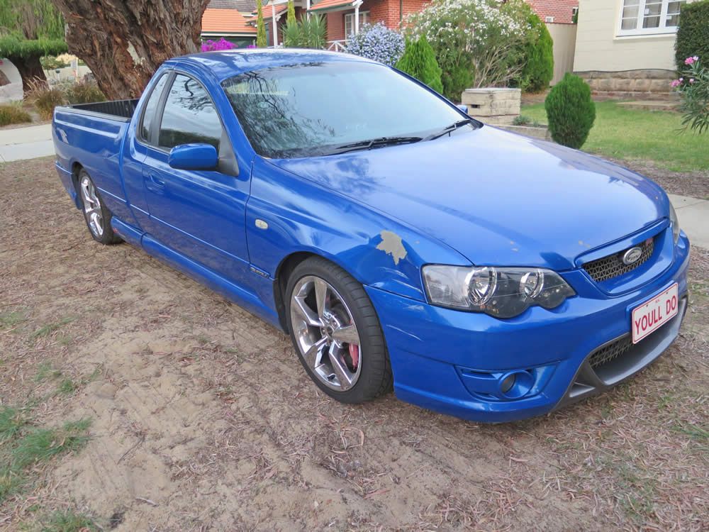

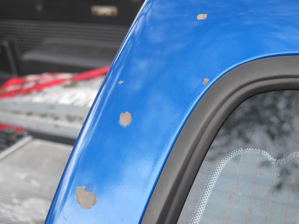

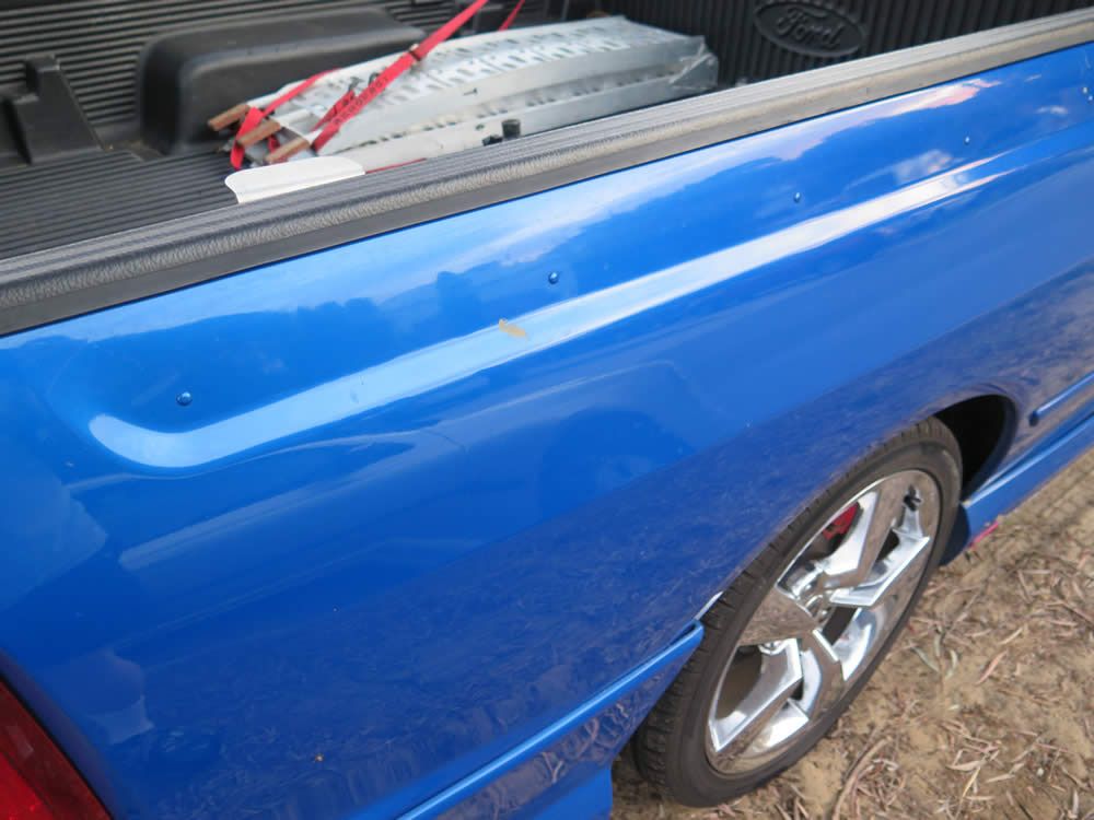

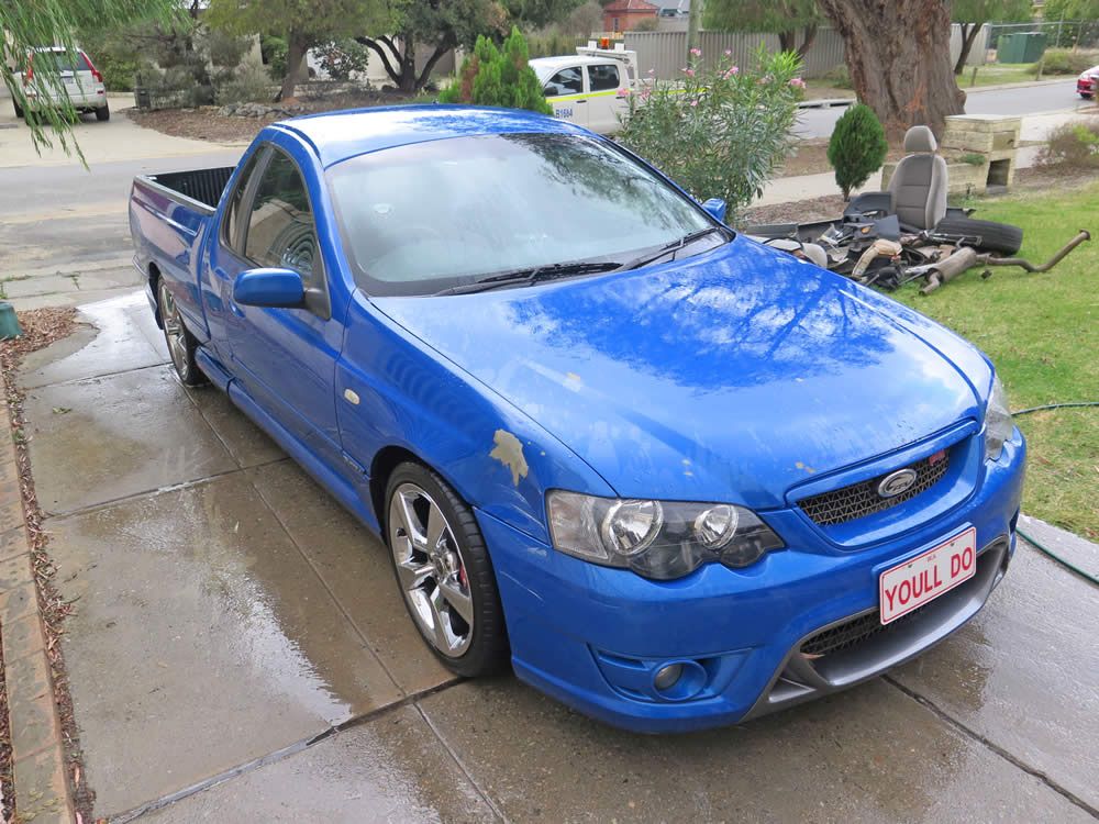

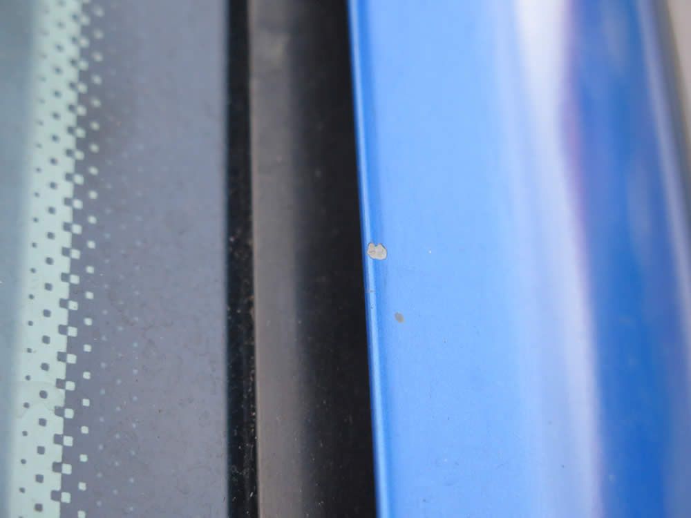

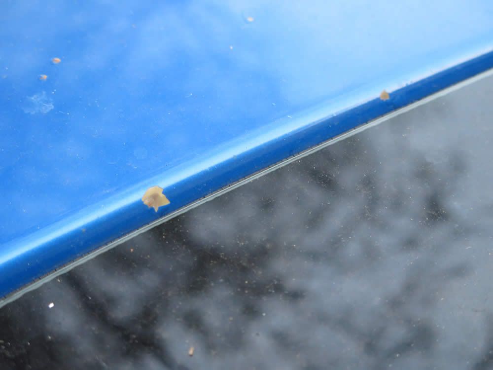

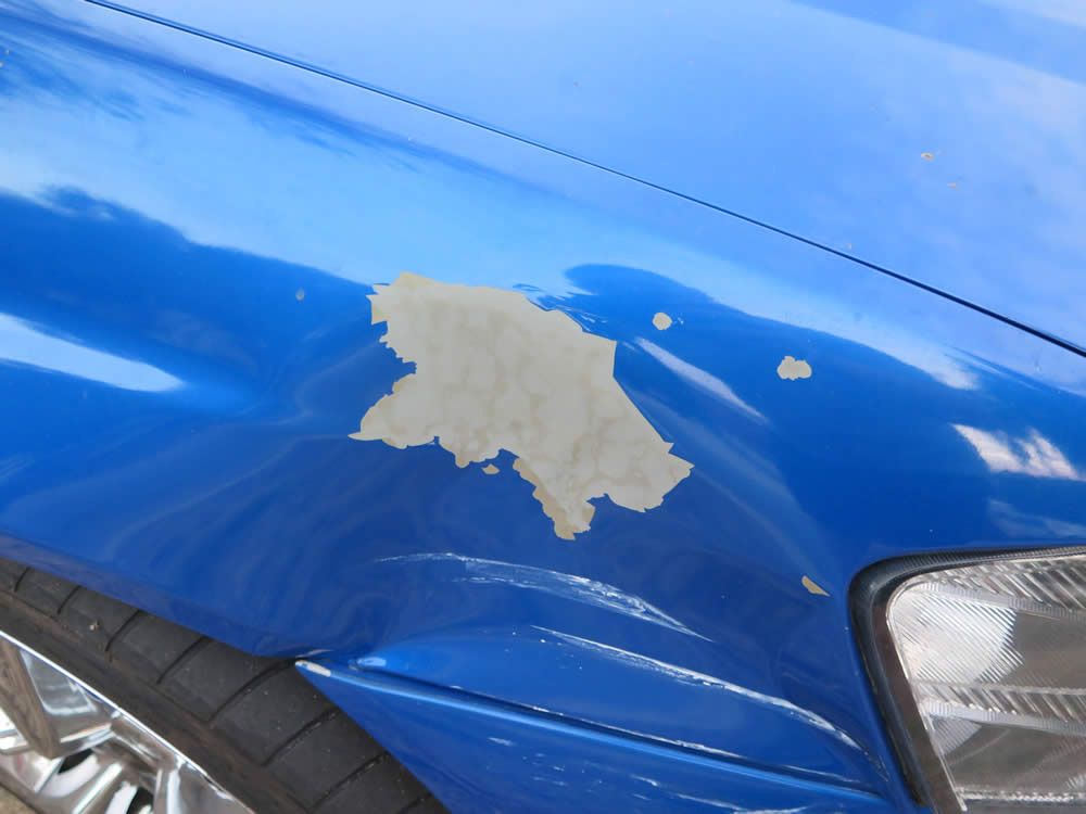

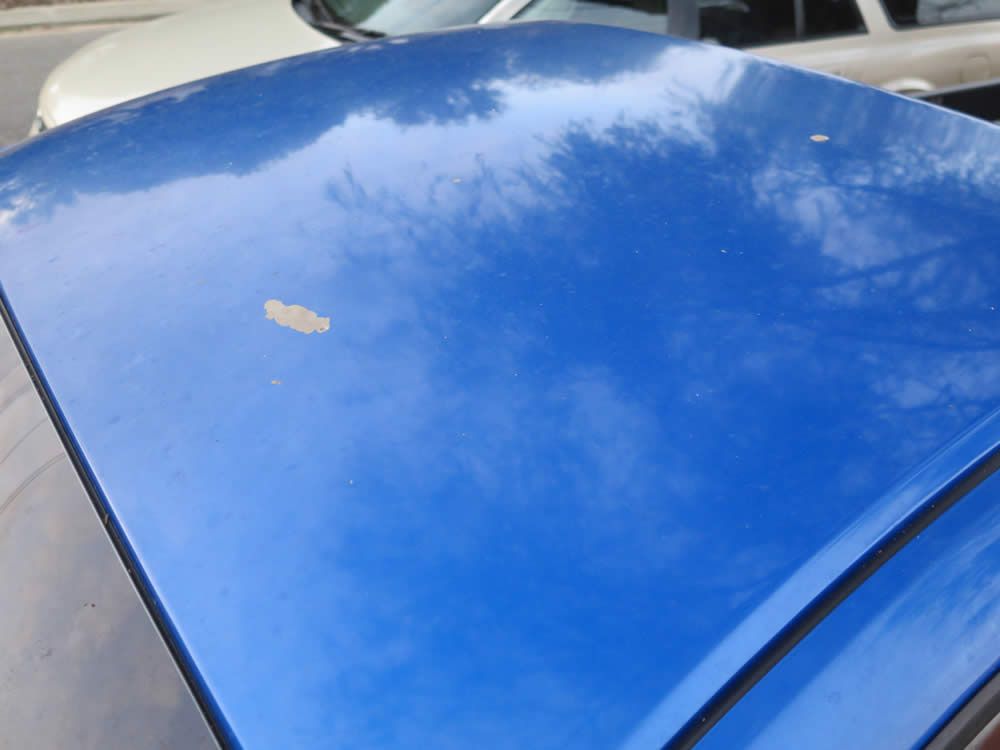

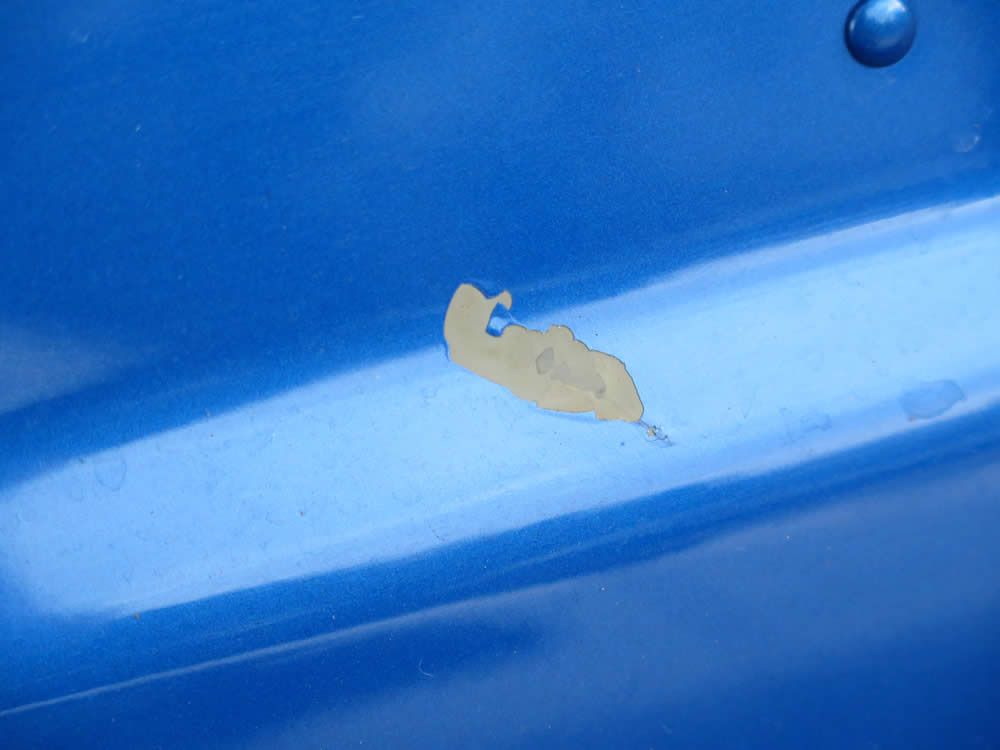

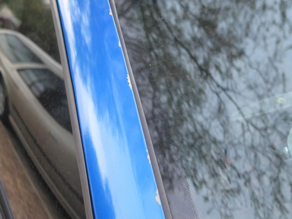

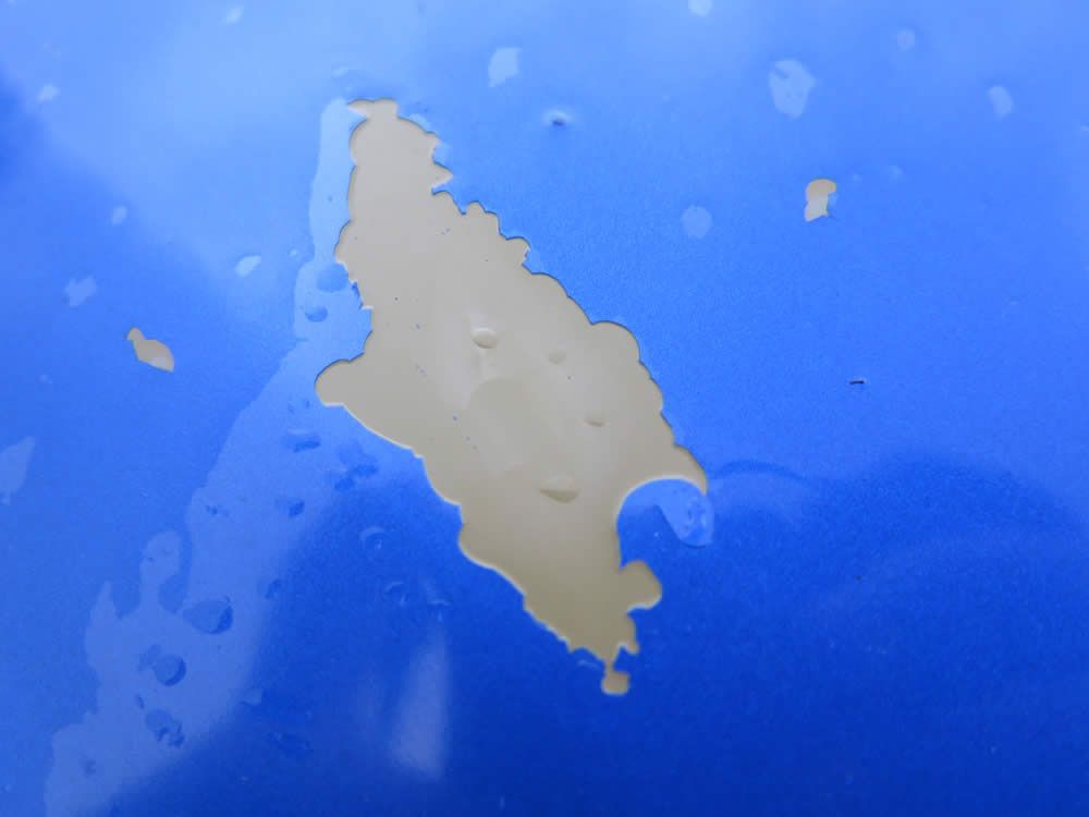

So far my efforts with this car have been focused on cleaning up the interior and general mechanical areas. There are exterior cosmetic issues, but the first priority was to get the car licenced and running properly so that I could enjoy driving it.

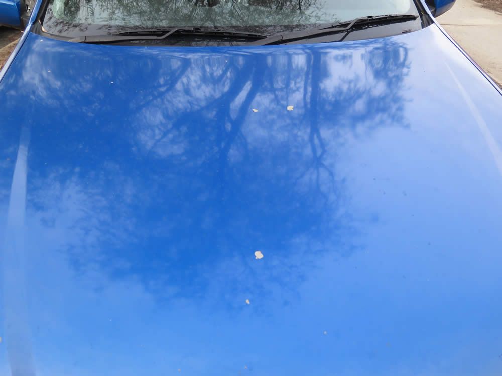

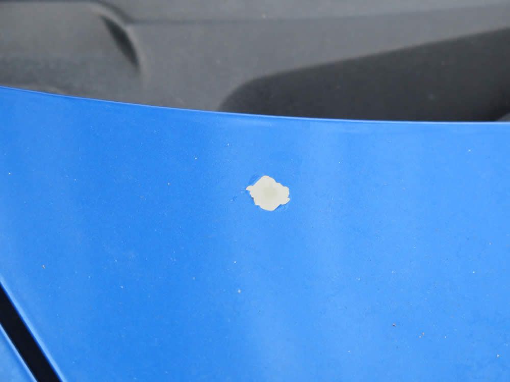

There were various chips in the paint when I got the car, but it wasn’t until this week that I became aware that this has been a common problem with the Shockwave colour on BA and BF Falcons.
Ford has been respraying cars over the years. Some cars got a full back-to-metal respray and some cars only had the affected panels done. This has depended on the number of panels that needed respraying.
I rang Ford Australia on Friday afternoon and spoke to someone familiar with this. She said that they had stopped the respraying program a couple of months ago, but would create a case file for a Case Manager to look at. I acknowledged that this now a nine year old car, but the fact is that the paint chips aren’t due to bad luck on my part or mistreatment by a previous owner, but a manufacturing fault by Ford. And if any previous owners had been made aware of this then the car would have been resprayed years ago.
I’ve got the case number and will be calling Ford almost daily. There’s a possibility that I’ll buy another Tornado next week and end up selling this one, so time is critical.
One of the major problems is that I am now aware that it’s a manufacturing problem, so even if I spend my own money getting the paint chips sorted out then paint will chip off the car in other areas in the future.
If anyone is familiar with legislation that is relevant to this that defines Ford’s obligations, then please let me know.

Photos:
The front bumper was scratched when I bought the car. Getting it repainted has been on the list of things to do.
This photo shows the damage to the front fender panel from when the taxi reversed out and collided with my car.
This has also caused a large amount of paint to come away from the car. The smaller paint chips above were already there.
There are numerous paint chips on the bonnet.
Big chip on the roof.
Close-up of one of the roof chips.
Close-up of the other roof chip.
The tub has a couple of chips as well.
Close-up of the main tub chip.
Several chips behind the driver’s window.
Various chipping around the windscreen area.
Above the windscreen.
Another bonnet chip.
Close-up of the same bonnet chip.
Three minor chips on the passenger side of the windscreen.

Sunday, 3rd May, 2015

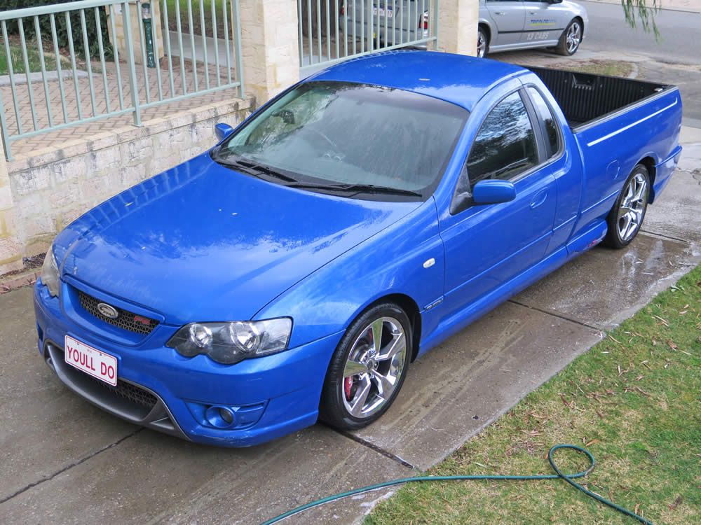

Having spent the weekend reading through endless forum posts and discussions about the problems with Ford’s Shockwave paint, I’ll be taking the car to a Ford dealer tomorrow to hopefully be photographed and assessed.
Although I washed the car only a few days ago, I wanted to make sure that it’s presented as tidily as possible. So I washed it again, including paying a bunch of extra attention to the wheels. I also went through the interior of the car with my weed blower to blow dust off the dashboard, centre console, speedo gauges, etc.
Most of the photos in this thread have been close-up photos of particular parts of the car that I was working on at the time. Time for a couple of photos that show the whole car.
Even from a distance, you can see a couple of paint chips on the roof, as well as numerous paint chips on the bonnet.
During washing the car today, another chunk of paint came off.
A close-up of where the paint came off today. As you can see, the Shockwave paint completely fails to adhere to the metal bodywork.
