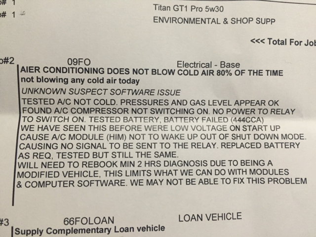

norrs Donating Members 448 Member For: 17y 9m 7d Gender: Male Location: Darwin Posted 15/09/15 09:20 AM Share Posted 15/09/15 09:20 AM Well this is my update. ford tried to blame the battery again even though it's my second ultra high performance battery from century (I own two now thanks to ford) Link to comment https://www.fordxr6turbo.com/forum/topic/89644-fg-xr6t-aircon-is-rubbish/page/5/#findComment-1561728 Share on other sites More sharing options...
Lennox Member 2,586 Member For: 12y 2m 3d Gender: Male Location: Perth Posted 15/09/15 11:46 AM Share Posted 15/09/15 11:46 AM Did they put 5w30 oil in it as well? Link to comment https://www.fordxr6turbo.com/forum/topic/89644-fg-xr6t-aircon-is-rubbish/page/5/#findComment-1561746 Share on other sites More sharing options...
norrs Donating Members 448 Member For: 17y 9m 7d Gender: Male Location: Darwin Posted 15/09/15 12:45 PM Share Posted 15/09/15 12:45 PM Did they put 5w30 oil in it as well?Yes it appears so is that a problem. It's was apparently $98 of oil Link to comment https://www.fordxr6turbo.com/forum/topic/89644-fg-xr6t-aircon-is-rubbish/page/5/#findComment-1561751 Share on other sites More sharing options...
Lennox Member 2,586 Member For: 12y 2m 3d Gender: Male Location: Perth Posted 15/09/15 12:52 PM Share Posted 15/09/15 12:52 PM Well it's the wrong grade according to the manual Link to comment https://www.fordxr6turbo.com/forum/topic/89644-fg-xr6t-aircon-is-rubbish/page/5/#findComment-1561752 Share on other sites More sharing options...
norrs Donating Members 448 Member For: 17y 9m 7d Gender: Male Location: Darwin Posted 15/09/15 01:32 PM Share Posted 15/09/15 01:32 PM I live in Darwin, do you think that is why? Link to comment https://www.fordxr6turbo.com/forum/topic/89644-fg-xr6t-aircon-is-rubbish/page/5/#findComment-1561758 Share on other sites More sharing options...
