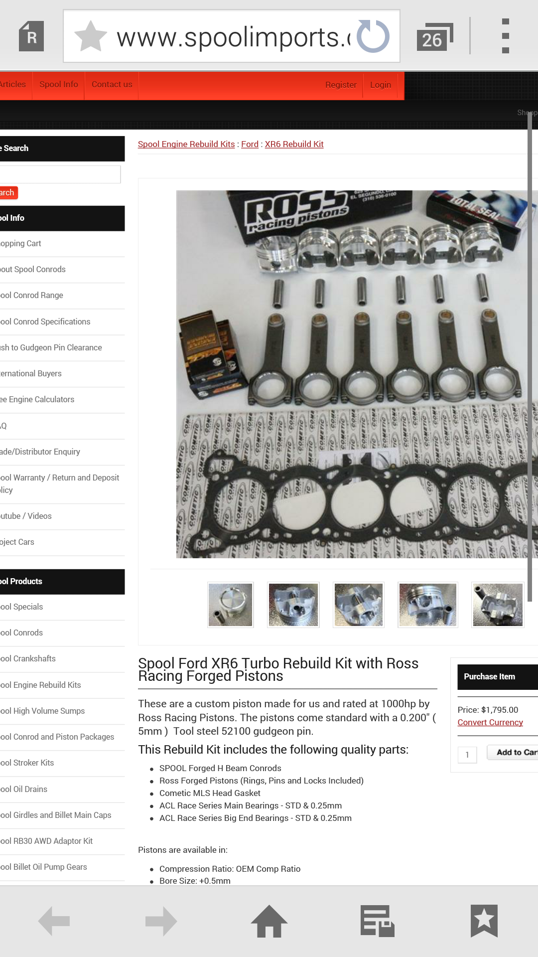

Peppy_t92 Silver Donating Members 748 Member For: 12y 2m 24d Gender: Male Location: Liverpool Posted 05/11/14 04:24 AM Share Posted 05/11/14 04:24 AM It says "Bore size +0.5mm" plus whatever piston to bore clearance they recommend, I'm sure that your machinist will be able to tell you this? Link to comment https://www.fordxr6turbo.com/forum/topic/89524-ross-forged-pistons/#findComment-1510418 Share on other sites More sharing options...
FORCEDG6E Member 145 Member For: 13y 10m 29d Gender: Male Location: adelaide Posted 05/11/14 04:28 AM Author Share Posted 05/11/14 04:28 AM Didnt see that aha Link to comment https://www.fordxr6turbo.com/forum/topic/89524-ross-forged-pistons/#findComment-1510419 Share on other sites More sharing options...
