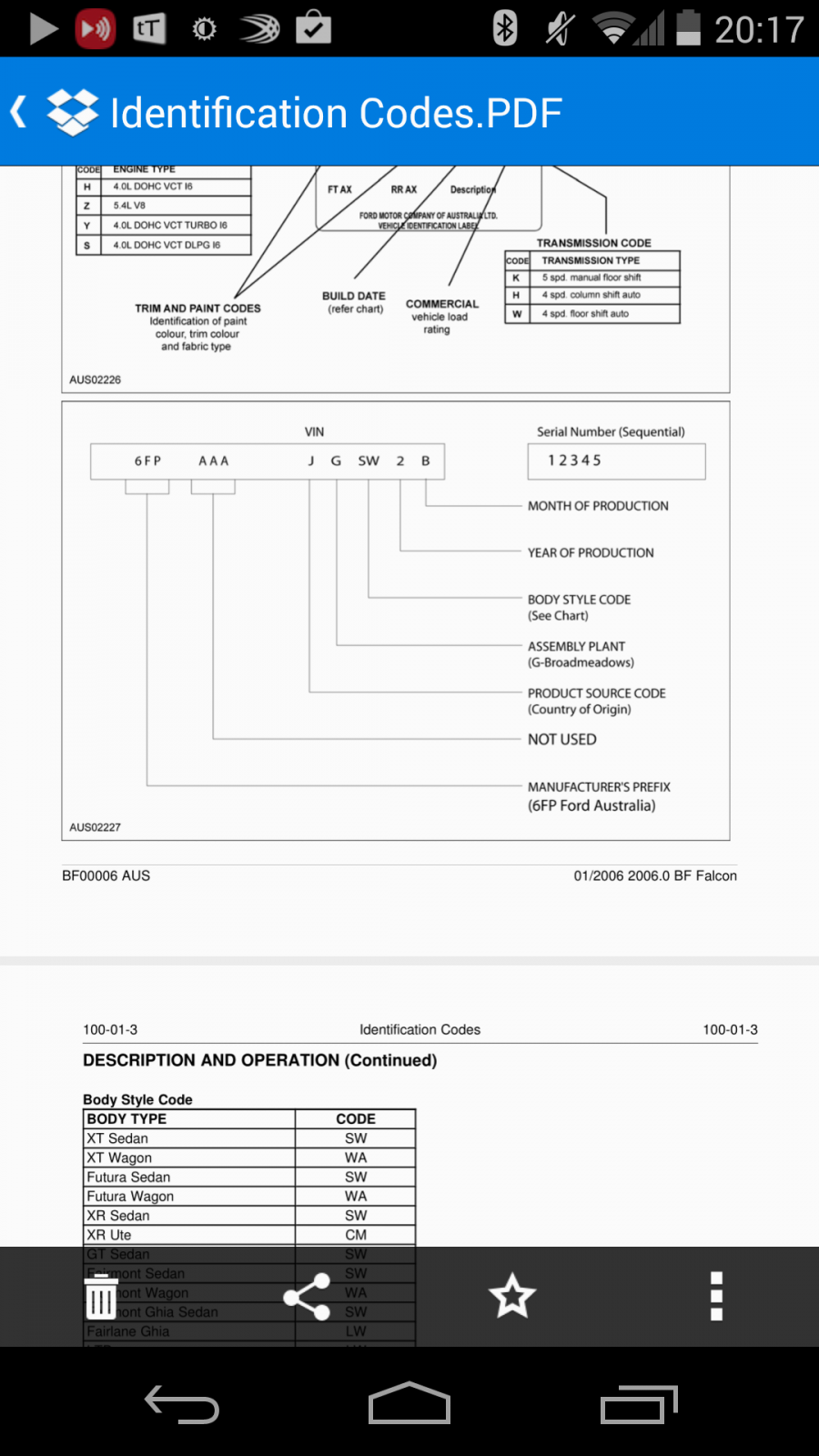

QIK06T Member 39 Member For: 10y 7m 19d Gender: Male Posted 24/08/14 12:14 PM Author Share Posted 24/08/14 12:14 PM On 24/08/2014 at 12:12 PM, Ralph Wiggum said: Post the engine numberJGSW3T99312I've got a gut feeling it's a BA motor Link to comment Share on other sites More sharing options...
Ralph Wiggum Moar Powar Babeh Lifetime Members 19,331 Member For: 19y 6m 17d Gender: Male Location: Perth Posted 24/08/14 12:19 PM Share Posted 24/08/14 12:19 PM Looks like it.... Link to comment Share on other sites More sharing options...
QIK06T Member 39 Member For: 10y 7m 19d Gender: Male Posted 24/08/14 12:28 PM Author Share Posted 24/08/14 12:28 PM What does 3 T mean? Link to comment Share on other sites More sharing options...
RB Snake Donating Members 327 Member For: 11y 3m 18d Gender: Male Location: Perth SOR Posted 24/08/14 12:32 PM Share Posted 24/08/14 12:32 PM 2003? That sucks man. Link to comment Share on other sites More sharing options...
