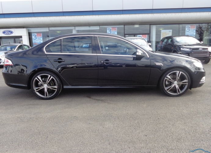

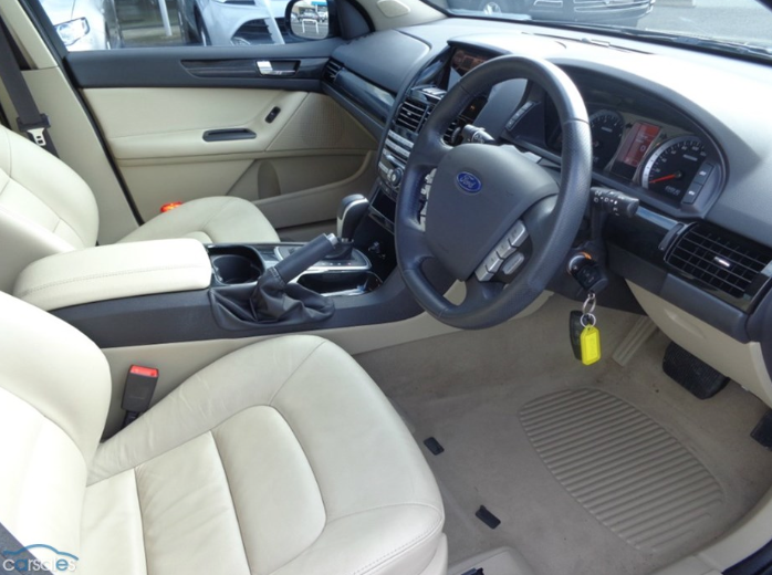

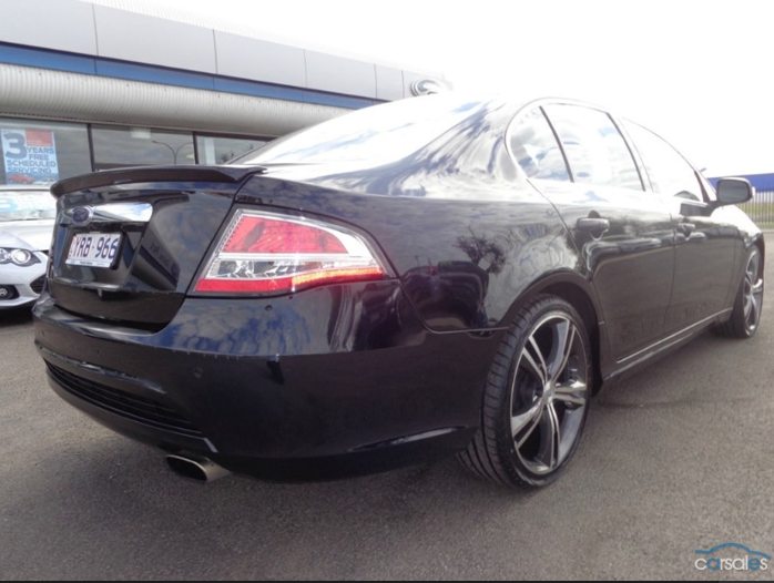

grimie16 Member 45 Member For: 10y 10m 3d Gender: Male Location: ACT Posted 18/08/14 02:49 AM Author Share Posted 18/08/14 02:49 AM (edited) Thanks guys!They're all the advertising photos! Haven't taken any decent ones my self yet!! In ACT aswell, Any particular order I should be doing things in other than what I have there? PW quite abit better or just marginally? From what I've read up on both aren't bad. Some coil overs will be going in soon also!Got it for 28500 with 34 on the clock, bargin I reckon! Edited 18/08/14 02:49 AM by grimie16 Link to comment https://www.fordxr6turbo.com/forum/topic/88994-new-g6et/#findComment-1493221 Share on other sites More sharing options...
MattyP MattyP Cruise Control 6,317 Member For: 13y 1m 13d Gender: Male Location: Central Coast Posted 18/08/14 03:09 AM Share Posted 18/08/14 03:09 AM Oh cashmere interior niceShock works coil overs I've heard are amazing and still keep a good ride in our boats.Um intercooler and intake can be put on without a tune.The injectors and dump/cat can't be put on without a tune Link to comment https://www.fordxr6turbo.com/forum/topic/88994-new-g6et/#findComment-1493222 Share on other sites More sharing options...
grimie16 Member 45 Member For: 10y 10m 3d Gender: Male Location: ACT Posted 18/08/14 03:26 AM Author Share Posted 18/08/14 03:26 AM On 18/08/2014 at 3:09 AM, MattyP said: Oh cashmere interior niceShock works coil overs I've heard are amazing and still keep a good ride in our boats.Um intercooler and intake can be put on without a tune.The injectors and dump/cat can't be put on without a tuneYea sweet that's what I was planning on doing anyway! Don't want to over boost! I've been looking at xyz, they have a pretty good rep Yea I like the cashmere over the black by far, looks way nicer! Not as hot in summer either! Would have loved to find a winter white one with this interior but they were all a little north of the budget Link to comment https://www.fordxr6turbo.com/forum/topic/88994-new-g6et/#findComment-1493223 Share on other sites More sharing options...
