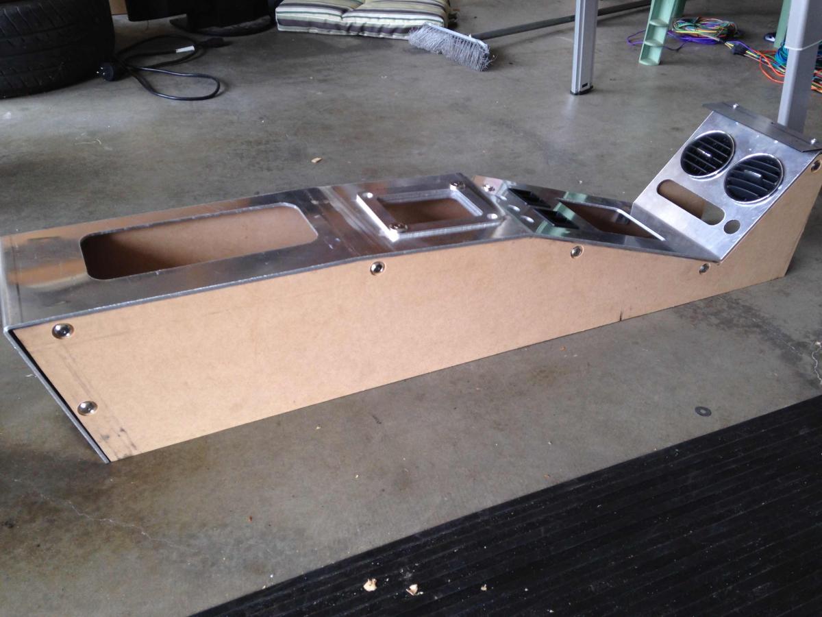

crikeyrob New Member 20 Member For: 11y 11m 29d Posted 07/11/14 10:21 AM Author Share Posted 07/11/14 10:21 AM Decided to change the materials used for the center console moving towards a 4mm folded aluminium sheet. Took a lot of learnings from the polycarbonate mockup, so this was still a worth while exercise. I have designed the entire console in TurboCad and its currently getting laser cut and folded. Once complete it will be wrapped in leather and then two sides put on. Here is the PDF file for reference. I will upload images once I get it back.Centre Console Steel Centre Final.PDF 1 Link to comment https://www.fordxr6turbo.com/forum/topic/88890-1966-mustang-with-fg-xr6-turbo-engine-and-zf-auto/page/3/#findComment-1510939 Share on other sites More sharing options...
crikeyrob New Member 20 Member For: 11y 11m 29d Posted 18/11/14 09:01 AM Author Share Posted 18/11/14 09:01 AM So the laser cutting went to plan! AG Holding did a great job in Braeside Vic. It's coming together well! Small square plates will be welded to the underside of the console at a certain offset to the edge. These will then be tapped and allow me to bolt on the sides easily.I will provide an update as things progress further. 4 Link to comment https://www.fordxr6turbo.com/forum/topic/88890-1966-mustang-with-fg-xr6-turbo-engine-and-zf-auto/page/3/#findComment-1512802 Share on other sites More sharing options...

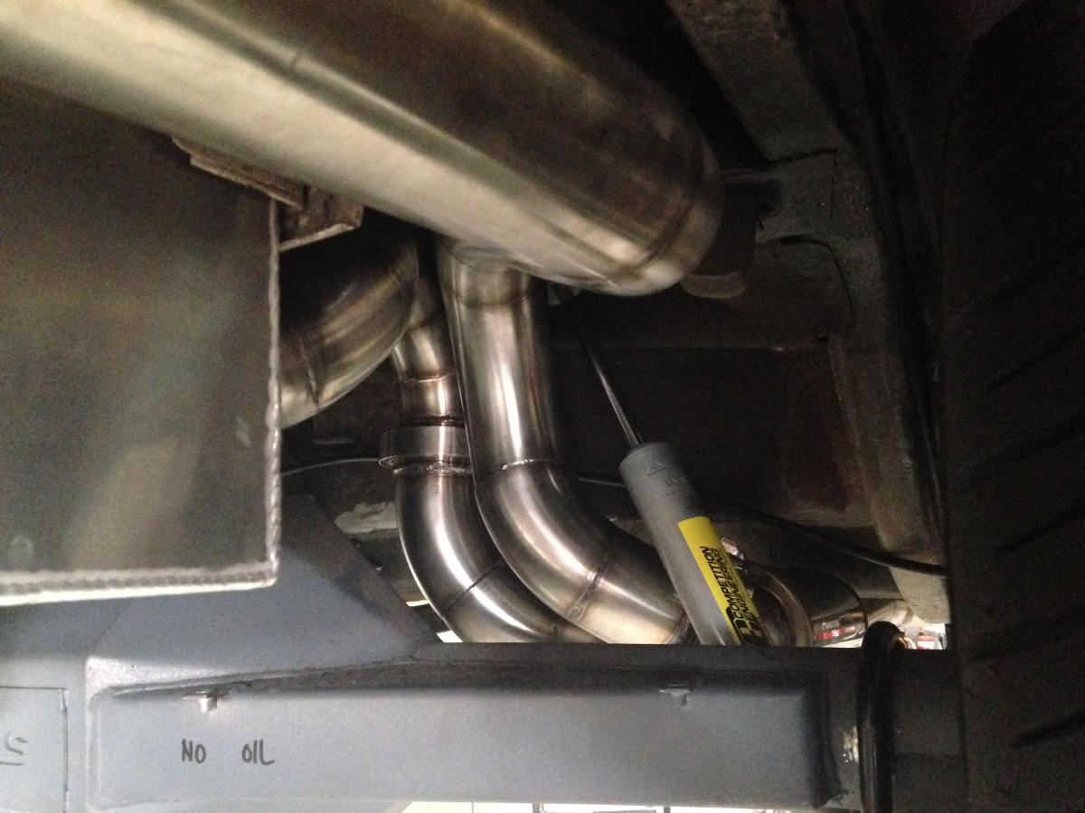

crikeyrob New Member 20 Member For: 11y 11m 29d Posted 26/11/14 06:42 AM Author Share Posted 26/11/14 06:42 AM Full stainless exhaust now complete. Single dump from turbo then twin system through GT Valance. 4 Link to comment https://www.fordxr6turbo.com/forum/topic/88890-1966-mustang-with-fg-xr6-turbo-engine-and-zf-auto/page/3/#findComment-1514265 Share on other sites More sharing options...
