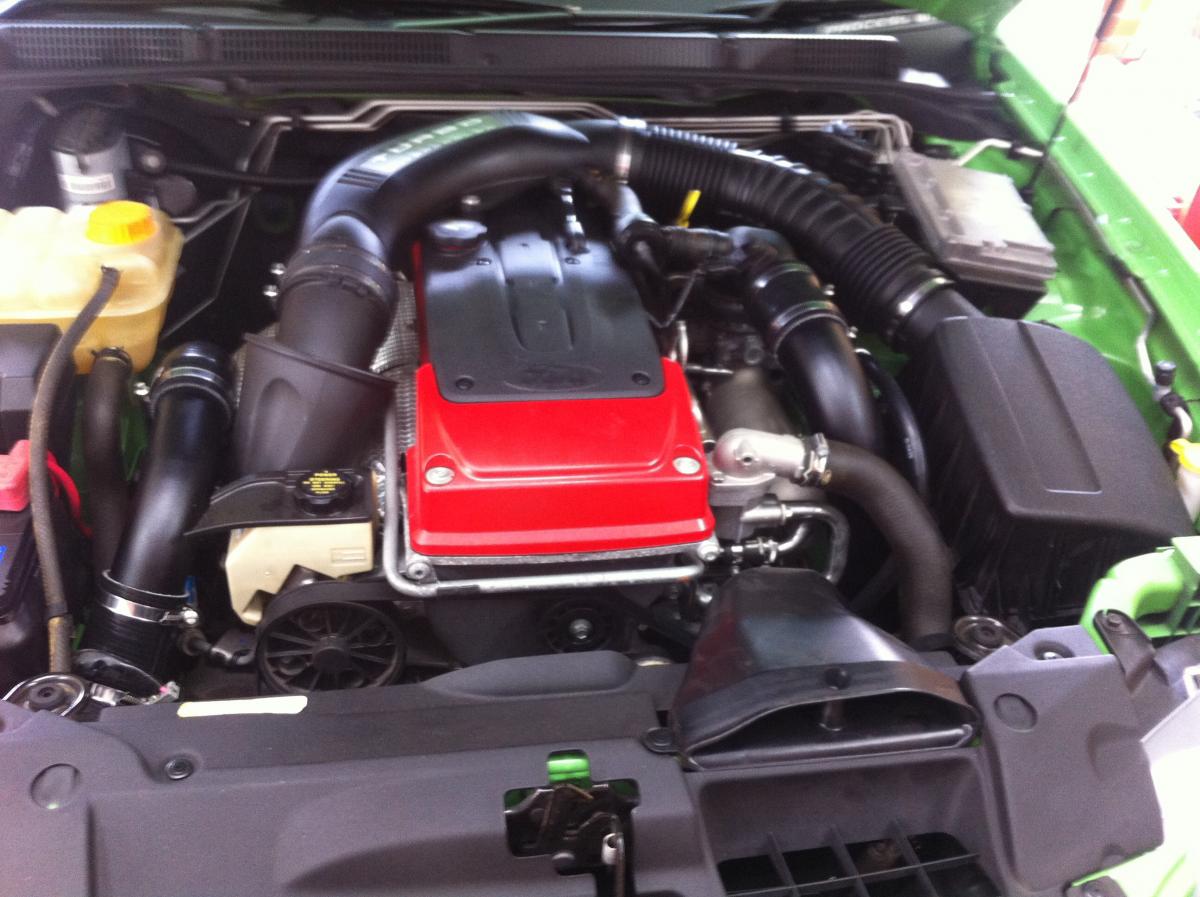

GUN-808 Member 251 Member For: 11y 6m 10d Gender: Male Location: Gold Coast Posted 01/08/14 10:53 AM Share Posted 01/08/14 10:53 AM (edited) I wanted the exact same as u mate and wanted that stock look..I ended up with the PW Street Airbox as mentioned above..I love the look of my setup and was happy to sacrifice a few KW for the look I wanted..Iv modded the PW unit to fit the stock OTR air intake.. Sik'ad a piece of silicone into the side with a hole cut into side panel..On a "normal" QLD day the intake sits at about 29deg and iv seen it as low as 19 (it usually adds around 6deg from a few tests).. which I dont think is too bad.. im positive under normal driving it lowers the intake temps..I cant comment on the pressure etc but I think its a good mod to do if your stuck on the crossover.. Edited 01/08/14 10:54 AM by GUN-808 4 Link to comment https://www.fordxr6turbo.com/forum/topic/88841-crossover-pipe-at-450rwkw/page/2/#findComment-1489163 Share on other sites More sharing options...
