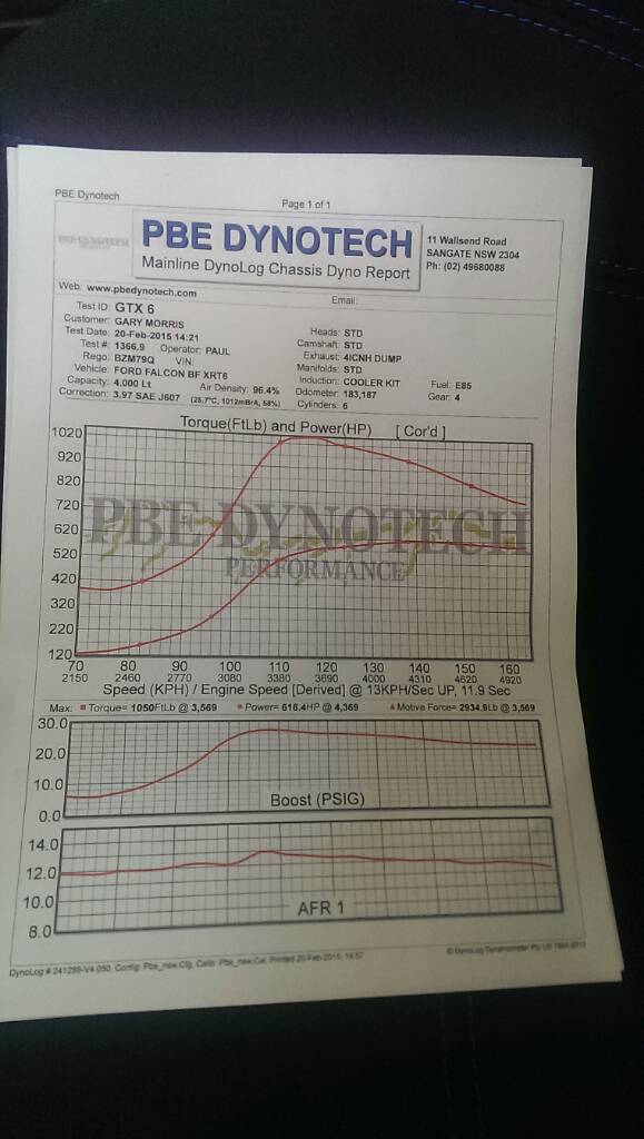

gaz097 Bronze Donating Members 1,752 Member For: 13y 8m 24d Posted 18/02/15 06:57 AM Author Share Posted 18/02/15 06:57 AM Update. Fitted a gtx and a gfb boost controller. Got to admit, just playing with it on the street they should have been my first mods lol. Boost controller is awesome fun to play with . Hopefully get it on the dyno this week to see how it goes. Supriesed how low I can get the boost as well. Gate pressure is around 16psi Link to comment https://www.fordxr6turbo.com/forum/topic/88767-gazzas-turbo-build/page/3/#findComment-1530920 Share on other sites More sharing options...
gaz097 Bronze Donating Members 1,752 Member For: 13y 8m 24d Posted 20/02/15 05:32 AM Author Share Posted 20/02/15 05:32 AM 460kw at 28psi tapering down to 22ish. B series manifolds are not built for power Link to comment https://www.fordxr6turbo.com/forum/topic/88767-gazzas-turbo-build/page/3/#findComment-1531271 Share on other sites More sharing options...
Bizkets is Drunk? Too heavy needs boost Member 5,929 Member For: 11y 8m 8d Gender: Male Location: Adelaide Posted 20/02/15 06:02 AM Share Posted 20/02/15 06:02 AM Dyno pics Link to comment https://www.fordxr6turbo.com/forum/topic/88767-gazzas-turbo-build/page/3/#findComment-1531280 Share on other sites More sharing options...
gaz097 Bronze Donating Members 1,752 Member For: 13y 8m 24d Posted 20/02/15 09:01 AM Author Share Posted 20/02/15 09:01 AM As attached Link to comment https://www.fordxr6turbo.com/forum/topic/88767-gazzas-turbo-build/page/3/#findComment-1531365 Share on other sites More sharing options...
