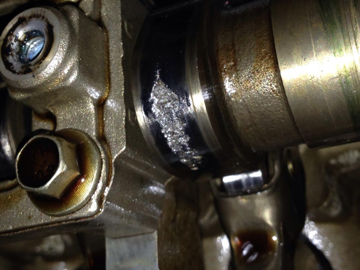

az6 turbo Member 38 Member For: 13y 4m 1d Gender: Male Location: shellharbour Posted 02/08/14 04:27 AM Share Posted 02/08/14 04:27 AM So to ad to this just took the cam cover off to fix a small weep of oil and found this.Anyone have a inlet cam for sale?? Link to comment https://www.fordxr6turbo.com/forum/topic/88472-fg-cams-beware-of-wear/page/13/#findComment-1489273 Share on other sites More sharing options...
k31th less WHY; more WOT Site Developer 29,467 Member For: 17y 23d Gender: Male Location: Melbourne Posted 02/08/14 04:35 AM Share Posted 02/08/14 04:35 AM wow... that's a lot of damage. what was it rubbing on? Link to comment https://www.fordxr6turbo.com/forum/topic/88472-fg-cams-beware-of-wear/page/13/#findComment-1489275 Share on other sites More sharing options...
arronm Dropping a turd Gold Donating Members 9,520 Member For: 17y 6m 6d Gender: Male Location: Perth Posted 02/08/14 04:59 AM Share Posted 02/08/14 04:59 AM Cam roller. Link to comment https://www.fordxr6turbo.com/forum/topic/88472-fg-cams-beware-of-wear/page/13/#findComment-1489278 Share on other sites More sharing options...
"Captain Retard" Member 1,417 Member For: 11y 1d Gender: Male Location: Shellharbour NSW Posted 02/08/14 05:07 AM Share Posted 02/08/14 05:07 AM It doesn't even look like its on the lobe, it looks like the hardening has just flaked off, WTF !!! Link to comment https://www.fordxr6turbo.com/forum/topic/88472-fg-cams-beware-of-wear/page/13/#findComment-1489280 Share on other sites More sharing options...
BenDoCo I'm getten too old for this s**t Bronze Donating Members 4,509 Member For: 12y 26d Gender: Male Location: A big bridge over a river in South Australia Posted 02/08/14 05:08 AM Share Posted 02/08/14 05:08 AM It's not a normal thing for it to rub and cause that much damage is it? Link to comment https://www.fordxr6turbo.com/forum/topic/88472-fg-cams-beware-of-wear/page/13/#findComment-1489281 Share on other sites More sharing options...
Wilko16 Donating Members 1,672 Member For: 17y 5m 12d Gender: Male Location: Melbourne Posted 02/08/14 05:11 AM Share Posted 02/08/14 05:11 AM Oh dear!!! Did the roller hardening fail or the cam hardening? Prob to hard to tell, pretty hardcore would have been tapping its ass off Link to comment https://www.fordxr6turbo.com/forum/topic/88472-fg-cams-beware-of-wear/page/13/#findComment-1489284 Share on other sites More sharing options...
JETURBO ...JD TUNING ADELAIDE... Gold Donating Members 23,708 Member For: 16y 11m 2d Gender: Male Location: Adelaide Posted 02/08/14 05:14 AM Share Posted 02/08/14 05:14 AM What oil were u running out of intrest ....? Link to comment https://www.fordxr6turbo.com/forum/topic/88472-fg-cams-beware-of-wear/page/13/#findComment-1489285 Share on other sites More sharing options...
"Captain Retard" Member 1,417 Member For: 11y 1d Gender: Male Location: Shellharbour NSW Posted 02/08/14 06:00 AM Share Posted 02/08/14 06:00 AM Is that wear on the heel of the cam or the lobe?If it's on the heel then what does the lobe look like?Very curious! Link to comment https://www.fordxr6turbo.com/forum/topic/88472-fg-cams-beware-of-wear/page/13/#findComment-1489295 Share on other sites More sharing options...
az6 turbo Member 38 Member For: 13y 4m 1d Gender: Male Location: shellharbour Posted 02/08/14 06:11 AM Share Posted 02/08/14 06:11 AM Bought the car with 110xxx ks so can't say what oil was in before but had full service history. I use castrol edge titanium 0-40.I know the rumours about full synthetic, but if it was true I'd expect to see wear like that on all lobes, not just one!It was worn like that on cyl no4, inlet valve closest to the front of car. I'm sort of thinking its bad case hardening just because of the way it looks or I was getting really bad float on just that valve.And their was no rattle to even suspect there was something wrong. Link to comment https://www.fordxr6turbo.com/forum/topic/88472-fg-cams-beware-of-wear/page/13/#findComment-1489297 Share on other sites More sharing options...
arronm Dropping a turd Gold Donating Members 9,520 Member For: 17y 6m 6d Gender: Male Location: Perth Posted 02/08/14 06:21 AM Share Posted 02/08/14 06:21 AM (edited) What oil were u running out of intrest ....?Oil type is not the major cause of the cam lobe wear. Edited 02/08/14 06:24 AM by arronm 2 Link to comment https://www.fordxr6turbo.com/forum/topic/88472-fg-cams-beware-of-wear/page/13/#findComment-1489300 Share on other sites More sharing options...
