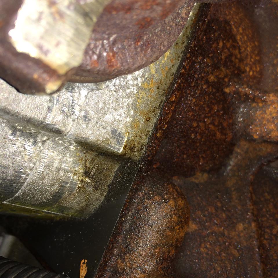

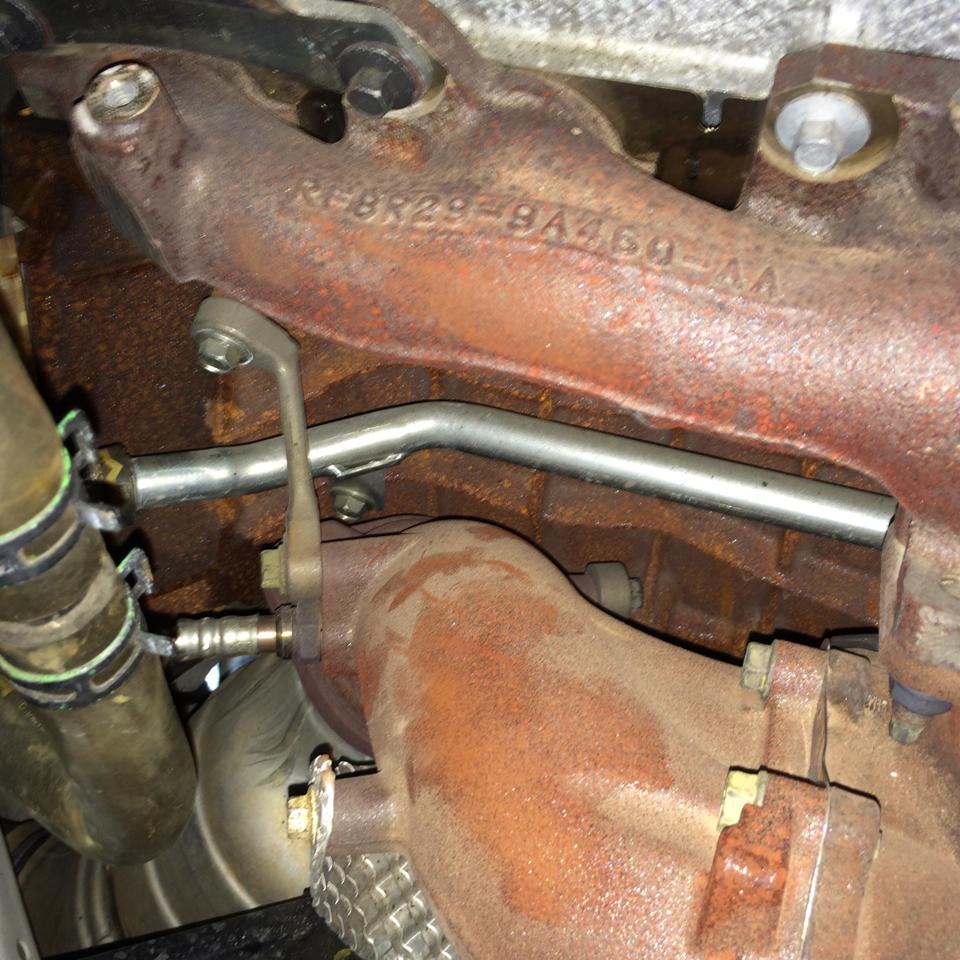

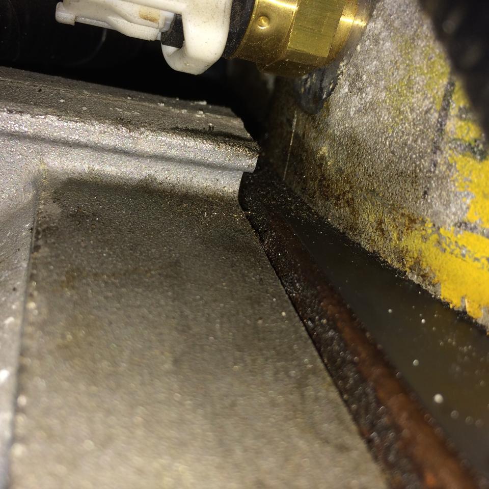

***VX*R8*** Member 202 Member For: 11y 8m 14d Gender: Male Posted 14/08/14 09:09 AM Author Share Posted 14/08/14 09:09 AM I took the heat shield off tonight and got some better pics.I still have no idea where this leak is coming from :( Link to comment https://www.fordxr6turbo.com/forum/topic/88425-timing-cover-resealed-coolant-smell/#findComment-1492553 Share on other sites More sharing options...
timwds Member 54 Member For: 13y 5m 10d Gender: Male Location: Tamworth Posted 14/08/14 10:41 PM Share Posted 14/08/14 10:41 PM That looks a lot like my head gasket leak... I hope I'm wrong for your sake. What I did with mine is take all the shielding off, wash all the coolant off with water and ran a cooling system pressure test. After about 15 minutes coolant started to show around the offending parts of head gasket. Link to comment https://www.fordxr6turbo.com/forum/topic/88425-timing-cover-resealed-coolant-smell/#findComment-1492653 Share on other sites More sharing options...
