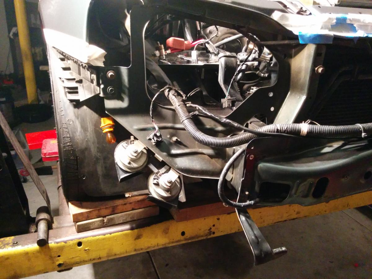

genuine honest person Member 2,769 Member For: 11y 3m 9d Gender: Male Location: near brisbane Posted 17/06/14 11:51 AM Author Share Posted 17/06/14 11:51 AM take a look at my pictures on the last page ,I have a cooler there for the transmission .thanks mate but I actually will use my single horn instead of the xr twin one Link to comment https://www.fordxr6turbo.com/forum/topic/88393-327-rwkw-760nm-xt-one-tonne-ute-was-a-v8/page/4/#findComment-1479169 Share on other sites More sharing options...

genuine honest person Member 2,769 Member For: 11y 3m 9d Gender: Male Location: near brisbane Posted 28/06/14 09:45 PM Author Share Posted 28/06/14 09:45 PM getting there slowly ,but I got the front bar fitted -strengthened the battery mounting supports -wired up the autometer gauges -fitted a on and of switch for the oil cooler fan - fixed the bonnet cable slop -painted all the visible parts behind the grill -shortened the cold side piping so that they join better . today I will modify the air box so that I can remove the air filter more easily . and might even change the spark plugs to new ones .have changed the coil packs already .will post more pictures soon Link to comment https://www.fordxr6turbo.com/forum/topic/88393-327-rwkw-760nm-xt-one-tonne-ute-was-a-v8/page/4/#findComment-1481631 Share on other sites More sharing options...
