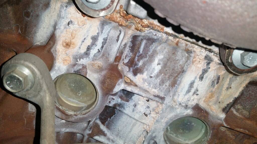

FORCEDG6E Member 145 Member For: 13y 6m 12d Gender: Male Location: adelaide Posted 27/06/14 08:38 AM Share Posted 27/06/14 08:38 AM Okay ive done some research and I stand corrected some addatives are ok but if you plan on keeping the car id do it properly im abiut to do the hesd on my fg turbo... Link to comment Share on other sites More sharing options...
"Captain Retard" Member 1,417 Member For: 10y 9m 7d Gender: Male Location: Shellharbour NSW Posted 27/06/14 08:45 AM Share Posted 27/06/14 08:45 AM Eeooo yuk !!!! Link to comment Share on other sites More sharing options...
FORCEDG6E Member 145 Member For: 13y 6m 12d Gender: Male Location: adelaide Posted 27/06/14 02:31 PM Share Posted 27/06/14 02:31 PM Yep fun begins Link to comment Share on other sites More sharing options...
