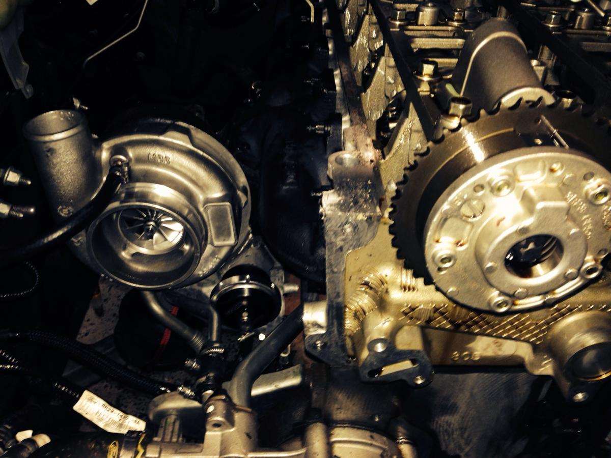

Ralph Wiggum Moar Powar Babeh Lifetime Members 19,332 Member For: 19y 7m 18d Gender: Male Location: Perth Posted 23/03/14 01:41 AM Share Posted 23/03/14 01:41 AM Post a pic of the turbo. Im tipping dodgy cat or an exhaust restriction.keen for lowball offers on the turbo if it is a gtx3576r? 1 Link to comment https://www.fordxr6turbo.com/forum/topic/87815-gtx-wont-hold-or-increase-boost/page/3/#findComment-1461456 Share on other sites More sharing options...

747pwr Member 68 Member For: 14y 2m Gender: Male Posted 23/03/14 01:57 AM Author Share Posted 23/03/14 01:57 AM Here's the turbo. Panda I tried to Pm you but it wouldn't work.. Link to comment https://www.fordxr6turbo.com/forum/topic/87815-gtx-wont-hold-or-increase-boost/page/3/#findComment-1461465 Share on other sites More sharing options...
ratter Member 6,793 Member For: 18y 11m 14d Gender: Male Location: @ my laptop Posted 23/03/14 01:57 AM Share Posted 23/03/14 01:57 AM I have been told to only expect possibly another 20-30 rwkw above stock unit.We have to remember that boost is just a measurement of the un used air that the turbo has supplied but the engine can't consume, if the turbo can't supply enough air the boost will be falling over Link to comment https://www.fordxr6turbo.com/forum/topic/87815-gtx-wont-hold-or-increase-boost/page/3/#findComment-1461466 Share on other sites More sharing options...
MA91CK billet turbos and weathered engines dont mix Donating Members 1,346 Member For: 12y 11m 19d Gender: Male Location: Wollongong Posted 23/03/14 02:01 AM Share Posted 23/03/14 02:01 AM On 23/03/2014 at 1:57 AM, 747pwr said: Here's the turbo. image.jpgPanda I tried to Pm you but it wouldn't work..Swap you for a GTX 3582 2500 km old? Will net 480rwkw on e85 Link to comment https://www.fordxr6turbo.com/forum/topic/87815-gtx-wont-hold-or-increase-boost/page/3/#findComment-1461469 Share on other sites More sharing options...

stevanford Member 268 Member For: 13y 3m 10d Posted 23/03/14 02:20 AM Share Posted 23/03/14 02:20 AM On 23/03/2014 at 1:57 AM, 747pwr said: Here's the turbo. image.jpgPanda I tried to Pm you but it wouldn't work..Looks like the 3576 to me. 470-480 rwhp is on the money for one of these turbos. Link to comment https://www.fordxr6turbo.com/forum/topic/87815-gtx-wont-hold-or-increase-boost/page/3/#findComment-1461474 Share on other sites More sharing options...
